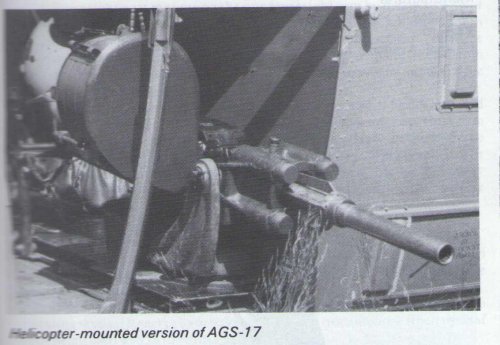

mysterious ags17a
tround
27 October 2012
149
64
from Jane's infantry weapons
First of all, I think the feed cover confirms it as an AGS-17, but with a new barrel or shroud. Secondly, it's undoubtedly fitted to an MG151 (GA1) mount in an Alouette III helicopter (Zimbabwe?).

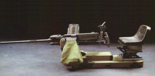

Some details of some of the servo controlled mounts.
Info from Helmoed Romer Heitmanns SA Arms & Armour from the mid 1980's.

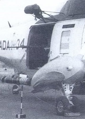

Just to add to the collection, a couple more instances of the MG151 on the AME mount. Both with Argentina, first on an S-58T and the second an Armada S-61.
Are you sure the gun in the S-61 pic is a Mauser and not the alternative 20 mm Mk.4 Mod 1? The barrel looks more like the latter, as far as I can see.

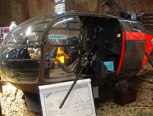

Kinda late here (well, 5 years late) but i found an this
idk if it is a real mauser one but was mounted like that in an argentine Navy Allouette III
