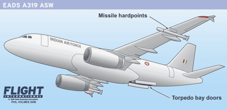

Well there always is the India MPA requirement. The A319 MPA shown in the Flight International graphic represents an improbable longshot, but it is interesting that weapons bay is aft of the wing.
Any specs to go with the drawings - payload etc?
Hmm....I don't remember anything concrete, but FlightGlobal has all of its articles archived. It is a pity that their search function isn't up to Google standards.
The Boeing P-8I and a version of the A319 by EADS Casa are finalists in the Indian MPA competition. Interestingly, the Inidan Navy's such-completed "flight evaluation" didn't involve either aircraft as they don't exist.
In the case of the P-8, India evaluated Boeing's ground labs, a leased airline 737-800 flown on representative mission profiles and a US Navy P-3C (the sensors are essentially the same).
In the case of the "A319 MPA", India had to evaluate a leased airline aircraft and a Spanish P-3 upgraded by EADS Casa with its FITS mission system.
Interesting, Lockheed nearly offered an A320 derivative for the US Navy's MMA competition. Apparently the longer landing gear allowed the weapons bay to be mounted under the fuselage, outside the pressure vessel, making for an easier conversion.
Lockheed eventually bid the remanufactured Orion 21, and was beaten by Boeing with the P-8 - a 737NG that needed substantial redesign to get the weapons bay inside the aft fuselage.

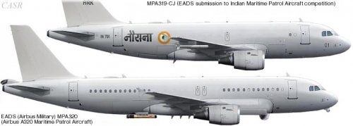

Here is a link to images of a powerpoint presentation on the A319 CJ based MPA offered to India:
http://trishulgroup.blogspot.com/2008/10/eads-built-mrasw-platforms-on-offer-to.html
Good stuff -- thanks Tin Wing.

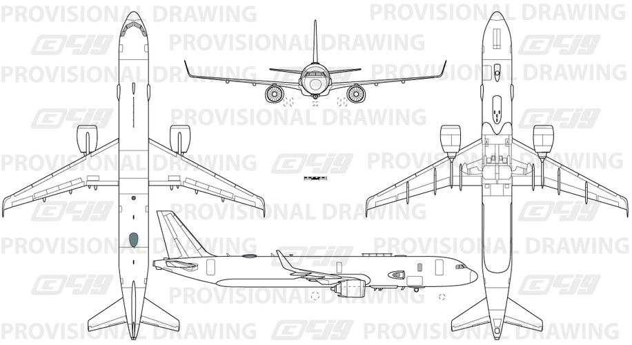

A sideview comparison between the A319 and A320 MPAs ...

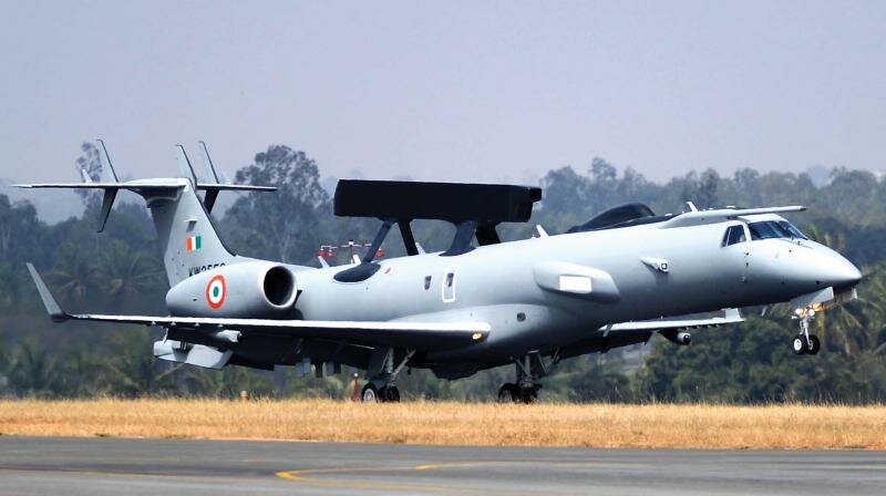

Not MPA but still a military derivative of the 320: 6 AWACS for India
India's Defence Ministry, on Thursday, greenlit the development of six new Airborne Early Warning Control (AEW&C or AWACS) planes to be built by the Defence Research and Development Organisation (DRDO). The AWACS will, reportedly, be fitted on modified Airbus A320 jets operated by the national carrier, Air India.
It looks like this will be a development of the existing radar system on their Netra aircraft:

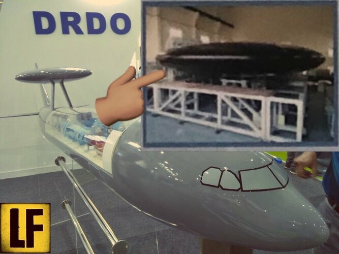

It's a continuation of an earlier program to acquire Airbus A330s. They looked at installing the system in a 'pancake' radome back then:
but the radar shape hasn't been decided on yet:
Livefist learns that the A320 based AEW&C platform will sport a derivative of the dorsal antenna system fitted on the Netra jets, and not likely a radome solution as has been speculated since the news broke Wednesday. This, however, is still unclear. In the words of a scientist familiar with the program, it will involve “trying past experience with additional features”.

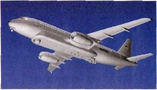

Two page EADS ad for the A320 MPA from 2003 targeted at the joint German/Italian program for the replacement of the Breguet Atlantic
From Wehrtechnik 1/2003
