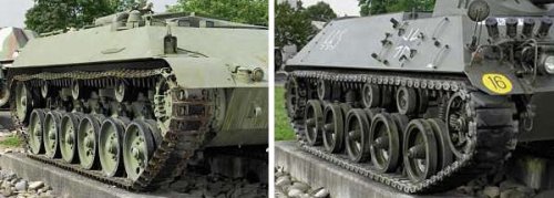

The comparison image below of the preserved Pirat 18 and HS-30 at Thun shows that there is only a conceptual similarity between the track systems of these two type. So, the Pirat series isn't directly related to the HS-30. Rather, Mowag and Hispano-Suiza were both Swiss rivals in the Bundeswehr's Schützenpanzer contest ultimately leading to the Spz 12-3.
Mowag Pirat 12, Pirat 14, and 3M1 Pirat 18 were trialled by the Swiss in 1960-63 (alongside the Swiss Sauer Spz Tartaruga, AMX-VCI, and M113 which became the Spz). The 1962 3M1 Pirat 18 evolved from the earlier Schützenpanzer attempts but incorporated the lessons learned (armour and remote armament) by Mowag's involvement with the German Projekt Marder.

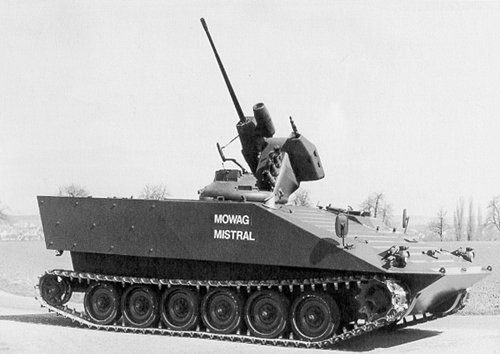

Mistral 1985 project
JAZZ , this is the apc I am asking for more technical data.
Best regards
