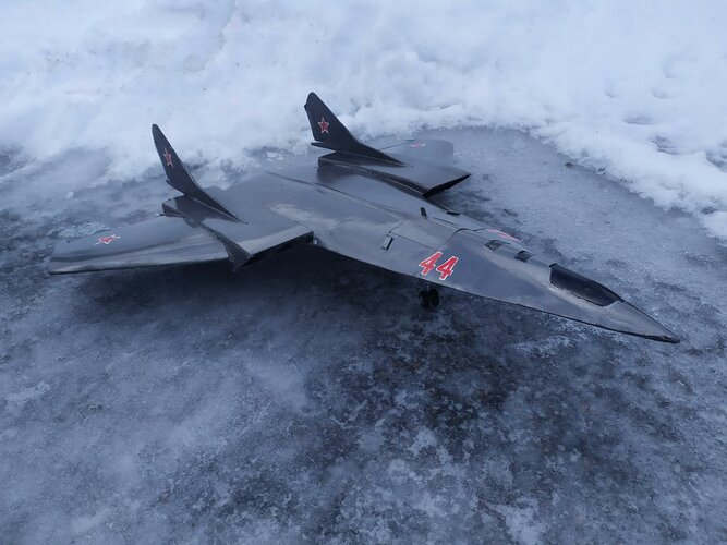

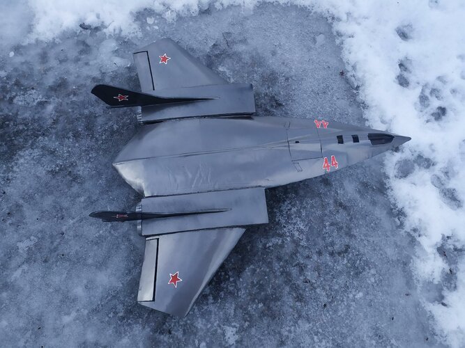

My idea on making the DSB-LK. 950mm wingspan, 1020mm long. Small change needed done because dont trust small EDF´s to give enough thrust. Found 2 x 50mm who had enough thrust.
That need make bigger "motorpods-part" outside fuselage body. Place for 2 , not 3 as by original sketches. 2 EDF´s working, 2 fake one, to get more correct width on the part, even if got a bit higher than original.
Very good flowing character on the model, it sails as a blade in the wind (more controlled though)
