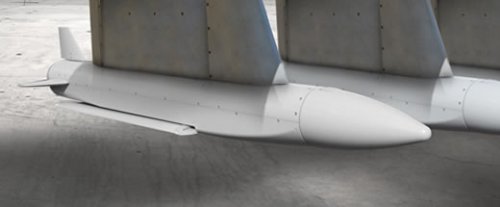

Five optional weapons load out configurations, including [] six Mini-Talon GPS-INS guided precision standoff attack weapons
The 1.93 m long Mini-Talon developed by Moog FTS is a 100 pound GPS/INS guided glide weapon. After the weapon is dropped from the aircraft it deploys its glide wings (1.91m' span) flying guided by GPS/INS to the target, Its warhead weighs about 12 kg. Its accuracy is believed to be within the 10 foot Circular Error Point (CEP). Photo: CAV

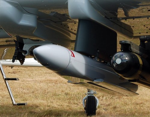

The project was started as a smaller weapon now being marketed as the Mini-Talon –1.93 m long, 1.91 m span, weighing just under 50 kg and carrying a 12 kg warhead. This is not thought to be in service.
I'm surprised that the Mini-Talon hasn't gotten a USAF contract yet, given that service's current interest in small, accurate weapons.
