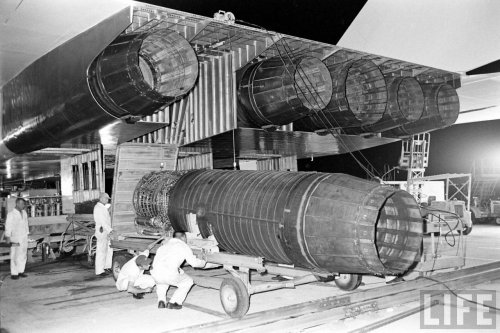

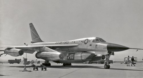

The Valkyrie was intended to have a decaborane-based fuel version. Ref here.
There is an interesting talk on the subject here.The pic below shows the Valkyrie engine with 'ordinary' fuel on testbed Hustler.
A view of engine by Valkyrie is next (from Flickr)

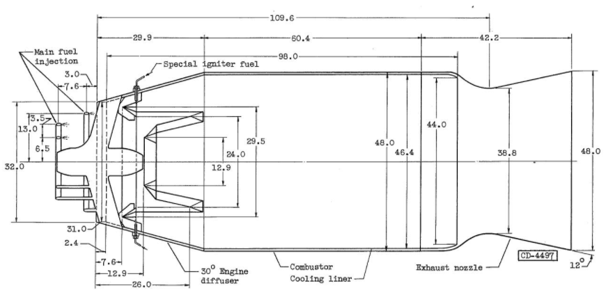

Intriguingly, Miller mentions talk of flight testing a "monstrous 48 inch engine for another, unspecified program".
Navaho possibly? It had a pair of 48" ramjets for propulsion. This Glenn historical page describes testing them originally in 1952 and then again in 1955/56.
http://pslhistory.grc.nasa.gov/Ramjets%20and%20Missiles.aspx
