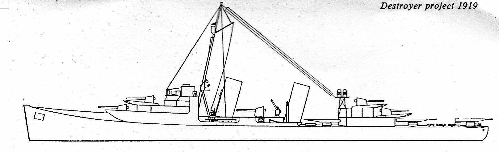

i'm talking about around the outbreak of warWhen are we talking about here? The drawing @ptdockyard posted is labeled 1919. If that was the time of the proposed modernization, there were no 40mm Bofors or 1.1" to install.

is that a broadside of 5 torpedo mounts? even if it's only triple tubes thats almost as crazy as the kitakami lolI have been researching this on and off for years ever since a customer sent it. So far nothing but I figure Lenton had to get it from somewhere back in the late 60's or early 70's. I labeled the drawing 1919 when I saved it in 2010 but that was because the same customer sent me another drawing from the same book of a US destroyer leader from 1919 I am attaching here.

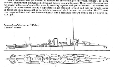

This four stack conversion may have come from the since destroyed book 2 of Springstyles from the mid 1920's to the late 1930's.
If I remember correctly, that particular design's forward broadside tubes were small, short-ranged 14 or 18 inch weapons for anti-destroyer use during night-action "knife fights". This was very likely based on U.K. experience with the Dover patrol.is that a broadside of 5 torpedo mounts? even if it's only triple tubes thats almost as crazy as the kitakami lol

AIUI, the USN made a host of modernization plans for their existing fleet post WWI taking in their own and their ally's experiences during the war. To the best of my knowledge, these plans would be part of that.What is there to stop the OTL destroyers being more like the proposed modernised design or the 1919 design from the start?
Believe it was an expediency thing.I think that trunking the stacks together isn't a totally trivial undertaking. There has to be a reason that boilers generally each had their own stack until later designs.
