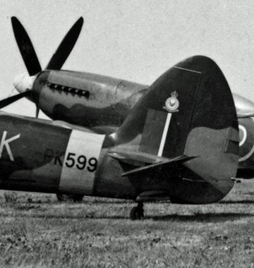

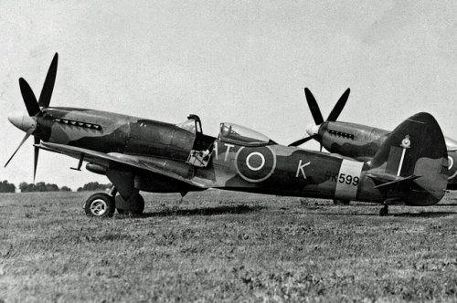

I'm posting this question here because the Mk-22 Spitfire was an operational aircraft and the Early Aircraft Projects forum is for projects.
Referring to the attached photos, the Mk-22 had flying elevators? What is the story here? How did they develop those??
Bronc

Certainly not full-on flying elevators. Pretty sure I've seen the feature on other WWII fighters (maybe I'll look around).
http://www.the-blueprints.com/blueprints/ww2planes/ww2-supermarine/41661/view/supermarine_spitfire_mk_22/
Ohhh--that's an optical/perspective illusion? The pivot point of rotation looks too far back though.
Bronc
..due to the horn balanced elevator, I think.
