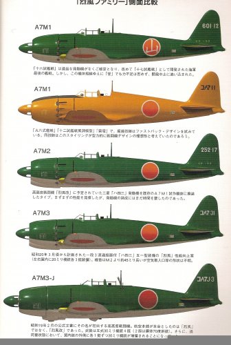

I imagine that there were some relation between Ki-99 and Reppu(also once called Reppu -kai) A7M2-J with MK9B engine, Reppu-kai A7M3-J with MK9A engine,Reppu A7M3(temporaly name three speed Reppu) with MK9C engine and Manshu Ki-65.
I imagine that A7M2-J nose shape looks like Kawanishi N1K5-J.
