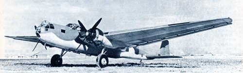

Mitsubishi 8-shi Reconnaissance plane(三菱八試特殊偵察機 G1M1) was substantially a prototype of type 96 attack bomber, ordered in 1933(Showa 8),completed April 1934. Stability and controlability were excellent.
You can see chief designer Honjo(本庄季郎) under the left propeller.
Engine:Liquid cooled W12 91 type 500HP(sea level), Span:25m, Length:15.83m, Wing area:75m2, MTOW:7ton, Max speed:265.6km/h, Range:2,346km, Service ceiling:4,600m.

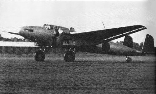

Hi! Mitsubishi Experimental 8-shi Special Reconnaissance plane(Ka-9/G1M1 later G3M1)
8-shi special reconnaissance plane/8-shi medium attack bomber(G3M1) ⇒9-shi medium attack bomber(Ko-plan, No.1 to No.6 plane, G3M2a)⇒9-shi medium attack bomber (Hei plan, No.7 to No.21 plane, G3M2a)⇒Type 96 attack bomber 11(G3M2a, to No.388 plane)⇒Type 96 attack bomber 22(G3M2b)⇒ Type 96 attack bomber 23(G3M3) ⇒ Type 96 transport(L1Y1)

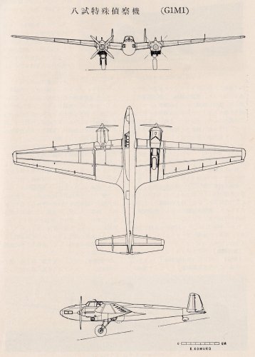

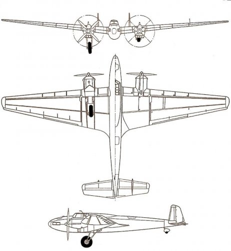

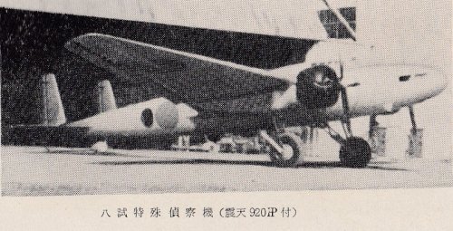

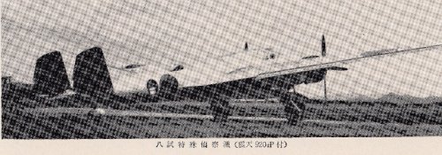

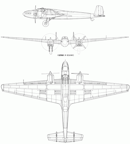

Folllowing side view shows G1M1 with Shinten 920hp aircooling engine.
Plan view and front view shows G1M1 with type 91 w shape liguid cooling 12 cylinders engine, 650hp
There were two G1M. Very complicated.
Anyway 8-shi special reconnaissance aircraft/8-shi medium land base attack bomber had a clean shape.
G1M was a prototype of G3M.

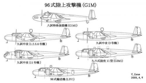

2. 九試中攻 (1.2.5.6.号機)
3. 九試中攻 (3号機)
4. 九試中攻 (11号機)

2. 九試中攻 (1.2.5.6.号機) : 2. 9-shi medium land base attack bomber(No.1,2,5,6 aircraft)
3. 九試中攻 (3号機) : 3. 9-shi medium land base attack bomber(No.3 aircraft)
4. 九試中攻 (11号機) : 4. 9-shi medium land base attack bomber(No.11 aircraft)
96式輸送機 : Type 96 transport
96式陸上攻撃機 : type 96 land base attack bomber
特殊偵察機 : special reconnaissance aircraft

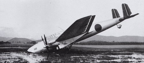

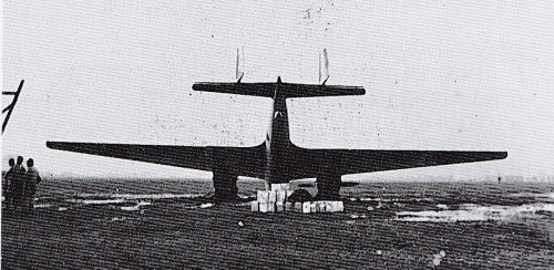

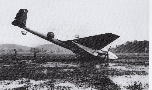

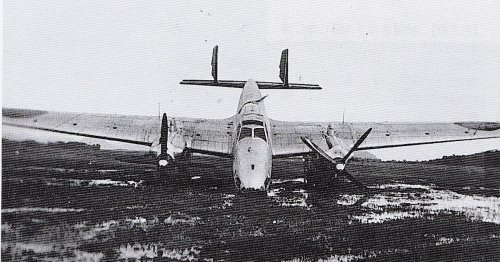

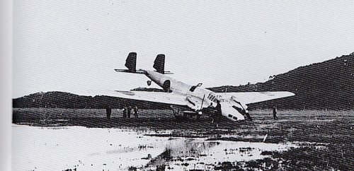

8-shi special reconnaissance plane accident picture.
You can see the detail of this aircraft in these pictures.
Chief designer of this aircraft Kiro Honjo experienced this accident.
In this accident, Honjo sat down next to the chief pilot. He was touching lightly by a control rod and fell to a nose of a plane.
Fortunately damage of the aircraft and the chief designer were small in this accident at landing.
Source : FAMOUS AIRPLANES OF THE WORLD, No.91 TYPE 96 ATTACK BOMBER, Bunrindo, ISBN978-4-89319-089-5, 5/1/2002

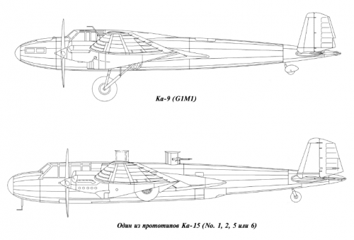

The Ka-9 was further developed into the Ka-15, the prototype of the famous G3M "Nell":
http://www.secretprojects.co.uk/forum/index.php/topic,27636.0.html

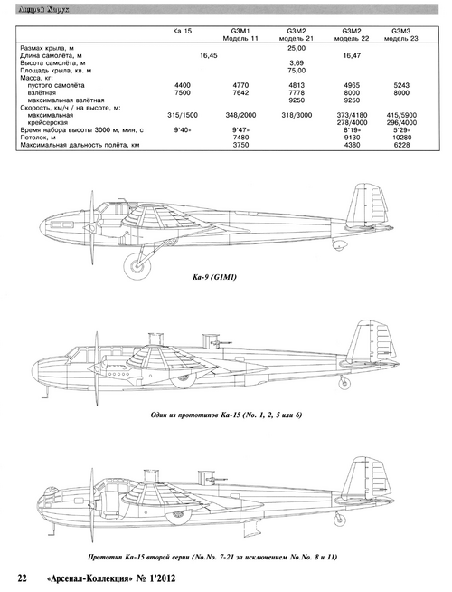

From Арсенал-Коллекция 2012-01 ,
comparison between Ka.9 and Ka.15.
