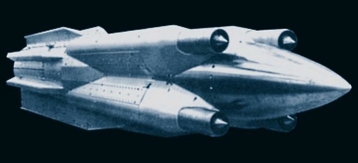

Identifying this missile.
I believe it's a wind tunnel test article for the Advanced Surface to Air Ramjet (ASAR), a 1970s US Navy project.
Edit: My bad, it's Integral Rocket Ramjet Surface-To-Surface Missile, which slightly predated ASAR.
See the attached article for more info.
  • 10.1.1.31.7889.pdf
Thanks for the info. In fact I found it on a Chinese website without any explanation.( )
Lot of that going around.
Worth mentioning that the reference to this as a "battleship model" probably just means that this is a non-flying wind tunnel model and thus was much heavier and more durable than a flying version.
