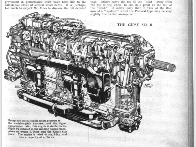

The really interesting thing about this engine is that it should not exist.
De Havilland built 12 of the special 'R' series in all, specifically for the Comet racers. One went to bench testing, one was hacked about to take an experimental propeller fitting, and by the end of 1935 the rest had all been paired up and put in the five Comets ever made. Only one pair was ever split up, those in the famous red G-ACSS Grosvenor House when its RAF incarnation as K5085 was sold for scrap, and that was a year or two after the Jo'burg race. At the time of the race, four Comets still had their racing engines while the fifth was scattered across the rugged terrain of the Sudan.
Where did Miss Fontes get her engine from, then?
And what happened to it after Tasker got fed up with looking at it?
Is it established beyond reasonable doubt that the 'R' engine was installed ab initio for Miss Fontes, rather than being installed by Tasker and Clouston when they acquired the Speed Six from her? Also is it certain that DH built only twelve 'R' engines?
Yes and yes.
It is known that de Havilland built a batch of twelve and, given the complexity of the castings and the short time scales involved, it is unrealistic to expect the first test engine to have been hand-made and tested beforehand.
My best guess is that they rebuilt one good engine from the two test ones, but information is thin on the ground.

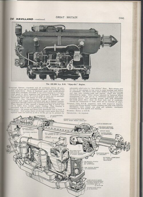

I went back and checked and found I had made a mistake - only ten were ever made. The last Comet had production engines.
The number ten comes from a contemporary directory of aero engines, of which a friend sent a page to me. I do not know which one, the top of the page is cropped. I think I have seen it elsewhere too, not sure where as it's not in Ogilvy. The engine in the Puss Moth or whatever it was (no two sources seem to agree) was the first test engine and at least some of its time was spent in GDH's personal machine, carrying out tethered flights.
The problem is, that I have not seen any direct evidence from credible sources of exactly how many 'R's were produced with any degree of confidence.

If you like I can upload an image of that unidentified directory page, would that reduce your scepticism?

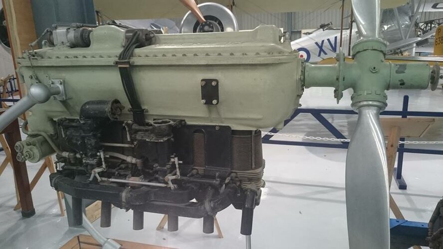

I have just learnt that the Six R from G-ADOD, together with its logbook, are extant in a private collection - I have asked the appropriate questions - watch this space.
! :D
Seriously, this is extraordinary news. Shuttleworth tell me that the Six R in their collection is the one used by Alex Henshaw in his Mew Gull for his all-time class record at the 1938 King's Cup. That means it has been significantly modified by Jack Cross. So if they are right (and I have not seen the provenance of their assertion), the one you have unearthed is the only original as-manufactured Six R known to have survived.

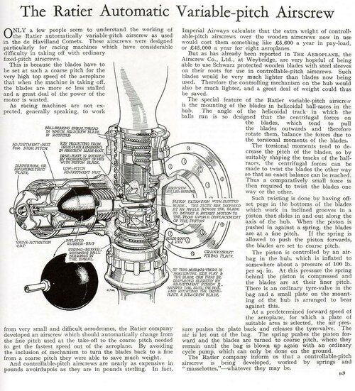

All three Comets were built for the Hamilton Standard V-P props. These required a high-pressure hydraulic oil way up the centre of the crank shaft and spline.
The planned Ratier conversion included shortening the crank shaft to take the mounting plate. But by the time the Hamiltons proved unusable, there was not enough time left before the race to dismantle the engines, modify and rebuild them and have them all re-certified. Hence the last-minute development of the adapter.

And the splines. The Shuttleworth Six R has its Ratier on for display, so I can't see its spline. My knowledge is a bit limited but as I understand it the original DH fixed-pitch spline is tapered, while the V-P spline is parallel. But was the DH V-P spline copied direct from the Hamiltons, or was it a bit smaller to match the smaller props and lower engine powers in the DH range?

Oh, and on the oilway front:

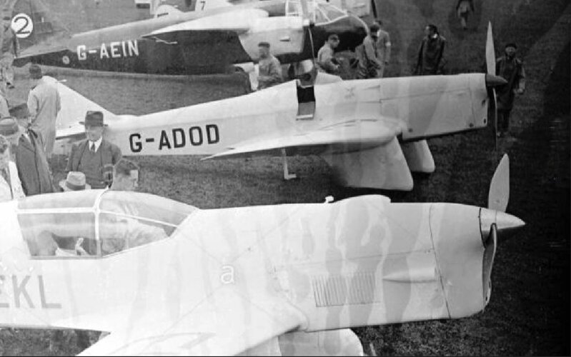

The carburettor air intake can potentially tell us something. On G-ADEF the telltale side bulge of the Six I is absent, telling us that the carbs had been turned sideways, after the manner of the Six R, to take advantage of ram-air compression at 200 mph. For some reason I came to believe that G-ADGP did have the production-standard side intake, But I have not recorded my source, darn it.
Does this help Guy? The Mew Gull has an intake but G-ADOD doesn't. Similarly G-ADGP and the Falcon Six both have the intakes. I'm thinking that confirms 'DGP had the Gipsy Six IF but 'DOD had the Gipsy Six R.
Thank you. They confirm what we know of G-ADOD and G-AEKL, no question there. Ah, and I remember about G-ADGP now; Shuttleworth nowadays fly it and they say it still has its original engine (i.e. the 1F). Hence my assumption that its carbs back then were mounted the way they are now. But it would be nice to confirm that.
As an aside, which Mew Gull is behind it? I don't recognise the layout of the name on the nose (It does not quite match The Golden City).

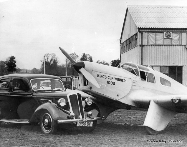

Not a Mew Gull behind 'DGP but a Falcon Six (G-ADLC) which had won in 1935 flown by Tommy Rose, in 1936 it was flown by C.W.A.Scott
Thanks again. I don't know much about the Falcon. Was it a kind of equivalent to the Vega Gull?
More like a Gull, 3-seater, one pilot with a bench seat for two passengers. The Merlin was a larger 4-seater version. I've flown in G-AEEG when it was the "Executive Aircraft" of Vintage Aircraft magazine back in the 1980s!

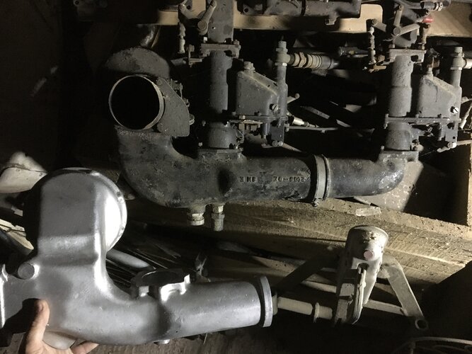

These engines all used the same Claudel-Hobson downdrought carburettors. This applies to the Gipsy Six, The R, the Six Series II, the Queen II and the Queen II. The only differences would have been the jets and the later engines having an AMC. The carbs were not 'turned sideways'. On some racing machines, the side-intake was replaced by an extended duct to allow the engine to breath the same air as the cooling inlet in the nose-bowl and thus reduce drag. As for the ram-air effect, this was negligible.
As for the splines - only the No.1 SBAC splines were used. There was no 'fixed-pitch spline' - and the No.1SBAC Spline was already extant. Engines intended for a fixed-pitch airscrew had a short, tapered end to the crankshaft with a keyway. Onto this, an adapter was fitted for the bolts and flanges to take a fixed-pitch airscrew. Just to confuse you further, there was available, from DH, an adapter to fit the No.1SBAC splines to allow a fixed-pitch airscrew to be fitted to either a SII or a QII et al. Thus, if you are looking at a machine with an R fitted, but using a FP airscrew, - it will have had the latter standard DH adapter fitted.

Great to have a knowledgeable critique here, thank you. I have to go mostly by what people write down, which is not always accurate.
Fair enough I can see that the carbs were not turned sideways. But their intake ducts were - see attached images. Also, the flame trap arrangement for the warm air inlet was rather different.
A contemporary account I came across did report that DH found the ram effect to be noticeable. I seem to recall something like 5 mph on the top speed.
The Ratier adapter was developed on-the-spot at DH by their UK representative M. Dreptin. One development crank shaft had been cut down to test the Ratier design, but by the time of the prop change all the engines had been built and certified, and there was not time to strip, modify and rebuild them all, and re-certify them, hence the adapter as a last-minute fix. Shuttleworth's Six R has one fitted; the prop only looks forward-positioned because the adapter pushes it forward. More images attached.

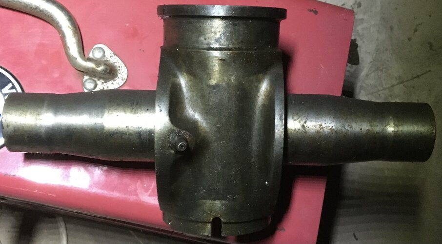

But I should like to know more about the SBAC spline. The Hamilton-Standard props were developed for the big American radials and the SBAC spline would not have been their standard fitting (which had a central oilway and was presumably the US spline). DH designed the R crankshaft to take those props specifically; there is no evidence of any adapters for them. Are you implying that Hamilton's must have designed specials to order, or that DH would have decided to fit spline adapters after all, or what? And was the DH SBAC adapter available in 1935 anyway, when Fontes bought her engine and the Six II was not yet available? Indeed, when was the SBAC No.1 spline defined, and why? So I am not yet clear that such an adapter would have been either available or appropriate for the engine when Fontes bought it.
Accuracy is an issue. For example - even some contemporary sources have errors, as do even some of the autobiographies of people involved at the time, so on occasions, some extra digging-around is required. Official manuals and documents are the most reliable sources if relevant and available.
The inlet extension-duct was just that - it allowed the air at the front of the nosebowl to be split and some channelled-back for induction and the parasitic drag of the side intake to be eliminated. (See first photo below.).This relates to the speed-gain too, as drag increases exponentially with speed, and so losing the drag from the side intake was well worthwhile. EWP experimented with taking the intake-duct right up behind the airscrew, but I don't think they were able to measure any advantage.
The alteration to the intake manifold (See second photo below.) is the deletion of the side intake (Facing you in the upper, original config'.) and the provision of a front opening into which intake air from the nosebowl can be directed by a fabricated duct. Note the warm-air flame-trap arrangement is basically unchanged.
The different position of the centre of mass of the Ratier is significant - given the moment arm from the CofG. The DH 1000-Series spider (See third photo.) positions the airscrew disc about halfway along the splines, quite close to the front of the engine (See fourth photo.), so the difference (Perhaps 6"+ ..?) is enough, given the mass of the airscrew(s) - metal VP airscrews are heavy assemblies. The PD30/211/1 assembly weighs 70.1 Lbs - the standard spinner weighs another 7.6 Lbs - so 77.7 Lbs total. Remember you have to double the weight as there are two airscrew assemblies - so 155.4 Lbs - all well forward of the CofG. OW, Derby or KF might supply you with the W&B for the Comet so you can work out the effect on the CofG of moving that lot 6". Look again at your photo of the Ratier on the R at OW - it is a significant difference at that weight and moment arm. Did DH act on this issue...? I have no idea.
I would also point out that the 3/4 view sketch clearly shows the adapter made to fit the Ratier and the sectional sketch of the Ratier shows that there is no space for the shaft to intrude inside it. Thus - just possibly, if the CofG issue reared it's head, they may have wanted to reduce the extension and thus need to cut down the crankshaft end. Do I think on the balance (No pun intended...!) of probability that they cut the cranks down...? No.
The issue of the whys & wherefores of Jack Cross's alterations to Alex's R is quite another matter and I'll avoid further muddying the waters here.
Splines etc;- DeHavs Licensed the Hamilton design for firstly the Bracket Type airscrews, then later the Hydromatic. DH's didn't design the R's crank for these airscrews - it was effectively already the SII crankshaft. The SBAC Splines were agreed SBAC standards across the UK aviation manufacturers. Having already introduced the Gipsy Six, DH's set-out to produce an uprated version to utilise a VP airscrew which eventually became the Gipsy Six Series II - a surprisingly different engine to the SI - despite appearances. (Again - I'll avoid further muddying the waters here.). The SII was already in development when the 1934 race cropped-up. They had finished development of neither the engines, airscrews nor spinners however. The R was therefore, cobbled together from an - at that time - unfinished project. The potential for problems was compounded by uprating the new engine, then using an undeveloped and untested airscrew (It took DH's another two years to sort the SII & PD30.) - all on a new type of machine. There is an old maxim in aviation - 'Don't use a new engine type on a new type of machine'.......
All these hydraulically-operated airscrews were fed by modulated pressurised oil via the crankshaft - and the DH versions all followed the US design in that respect. The detail inside DH's spider was to the UK SBAC spline-form to suit UK engines. Forget what the Americans used, it's irrelevant - DH's never used the US splines on the Bracket Type airscrews. There was no such animal as a UK-US adapter. We are talking about a) What was made to allow the Ratiers to be retrofitted to the No.1 splines, and b) The standard DH adapter that allowed a FP airscrew to be fitted onto an SBAC splined crank end intended for a VP engine, such as a SII or QII. I've got one somewhere but I can't put my hand on it just now - anyway, it was a DH listed assembly. I think there is an illustration in the SII & QII handbooks. It's worth noting that, as this adapter slipped-over the splines, it kept the mass at the same station.
I'm not sure what year the SBAC standard for splines came into effect, but since it wouldn't have been necessary before VP airscrews arrived, I'd say early 1930's - but it's a detail anyway.
I know little about the Mmmmiles a/c and the Fontes. Pretty much all the images that I have ever seen of Speed Sixes have had FP airscrews fitted - usually FR. I have a wooden DH FP airscrew that came from Croydon and was reputed to have come from a Speed Six, but I doubt this claim, as the pitch looks too coarse. Still - it's a nice dust trap.
G-ORDY's post from 21/03/21 - and other images on the web, seems to show machines fitted with FR FP airscrews - including G-ADOD. If so - Ruth's R would have been fitted with the standard DH adapter to enable fitment of the FR airscrew - as long as the crankshaft hadn't been tampered with. Do you have any other images of Ruths machine as raced with the R fitted....?
Hope that clears things up.

Methuselah said:
The Hamilton V-P prop was heavier than the Ratier, which would have helped limit the difference in aircraft CG. The Comet was a bit tail-heavy and unstable anyway, except when the front tank was full, so moving the CG forwards would actually have improved its handling.
There is no Ratier adapter in either the engine or the prop sketches that I posted; one is visible in the photo of the Shuttleworth engine. It is on record that they did not cut the shafts down, and this was precisely why they came up with the adapter instead.
What is the provenance of your story that the Six II was already under development when the R was conceived? Other sources put it the other way round, that the II adopted some features developed for the R. The original Six was not type-approved until late in 1933 or early '34 and first flew in anger in the prototype DH.86 in January 1934. That was the month in which the Comet was advertised. Production of the Six II did not begin until the second half of 1935. I am sure that some features were developed with the R and II equally in mind, but to suggest that the R was a spin-off from the nascent II design requires serious evidence.
Cross's work on Henshaw's engine deserves a separate thread. However one particular aspect is highly illuminating. He had to replace the Ratier with a DH 2-position type to meet King's Cup regulations, and Henshaw describes helping him with the machining of the replacement adapter. This need for a bespoke adapter is nigh-on conclusive evidence that the R spline was different from the DH prop's and the standard DH adapater would not have fitted. It would not have fitted Fontes' R either.
Still no answer to what fitting actually was provided on the Hamilton V-Ps bought by DH for the Comet. If we follow your suggestion that it was not the spline used on the R's shaft, then what exactly was it? And timing is indeed critical. If the standard adapter was introduced with the II after Fontes bought her engine, she could not very well have had one fitted, even if it did fit.
Far and away the simplest explanation is that both the Hamiltons and the R had the American spline and that the shaft on Fontes' engine had been cut back. Close-up of her nose attached.

Ratier Adapter; - Here is the sketch repeated below, showing the Ratier adapter that you yourself posted only recently..... The upper image is an SI, the sketch below is an R. The adapter is specifically labelled as such on the R sketch.
Forward CG good for handling - bad for range - ask any long-haul ATPL.
Development ;- Provenance - work your way through the period issues of Flight - it's all there. Think about it - why would DH's have gone to all the huge trouble and expense of acquiring the HS Licence - only to have no engine to fit these expensively developed VP airscrews....??? Clearly, they would not. The PD30/211/1 was specifically intended for the SII - a highly modified version of the SI designed to run a VP airscrew at sustained, relatively high RPM.
The R was simply cobbled together for the race using the basic SII crank and crank-case - so it could operate the PD30, but it used the slightly modified pistons, heads and barrels of the SI - NOT the SII pistons, barrels and heads etc. Remember the SII uses totally different barrels, pistons and heads - though the rods and gudgeon pins are common. The give-away in the exhaust-ports inthe head in your illustrations - and the fact that, in 1934, DH sent standard SI engines ahead to Oz for spares. There is one recovered from Oz at Derby - in case you have any doubts. I believe it is reputed to have been used as a spares source for the ailing 'SS.
There was nothing for DH to learn from the R except a) Not to commit to deliver an experimental engine for a high-profile event under extreme pressure, & b) That the overstressed engine was very vulnerable to over-leaning. (Waller clearly looked after the R's on his Comet better, and they got him to Oz.....and back.....). In short - there is nothing in a SII carried-over from the Six R. Nada. Zilch. Basically lore.
'XF's R;- 'This need for a bespoke adapter is nigh-on conclusive evidence that the R spline was different from the DH prop's and the standard DH adapater would not have fitted.'.
No, absolutely not - but as I said - that's a separate can of worms.
'Still no answer to what fitting actually was provided on the Hamilton V-Ps bought by DH for the Comet. If we follow your suggestion that it was not the spline used on the R's shaft, then what exactly was it? And timing is indeed critical. If the standard adapter was introduced with the II after Fontes bought her engine, she could not very well have had one fitted, even if it did fit.' ;-
I did not say that the spline on the R was 'different' and no, DH's didn't buy complete HS airscrews for the Comet (Though the initial blades may have been sent over from the US - and that is precisely why they proved unusable - but that's another story.) - as I said, the US splines were different, so DH had, at the minimum, to make the spider to suit the UK splines for the 1000-Series. Remember - the deal was always for DH to manufacture under Licence for the UK and Empire market - not to buy ANYTHING from the US factory, except the design, manufacture and distribution rights.
As for the small matter of the DH FP adapter for the QII - the Dh design office will have almost certainly anticipated the possible need and drawn this part up. It's not a complex assembly. Perhaps Fontes had the first one ever - who knows - but we do know the engine will have had the No.1 Splines - and the FP FR airscrew will have needed that exact part to allow fitment. It's a detail. I also seriously doubt the c/s her R was cut-down, as it'd have been tricky to fit the adapter.
As a matter of interest, G-HEKL is flying with a unique Queen I. This was effectively a Six SII, but lacked the facility (Gear-set inside the top-covers rear accessory case.) to drive a C/S governor. This engine would have needed the exact same adapter as would have been fitted to Fontes HSS to use it's intended fixed-pitch airscrew. In fact, David Beale had to convert the engine to SII build status by fitting the required missing gears to drive the CSU for the PD30, but obviously he would no longer have needed to use an adapter with his PD30, as it would have slid directly onto the splines.
Forget the US spec' splines - Hamiltons didn't even MAKE a VP airscrew small enough to fit the Gipsies. The US splines were not used for or intended to be used by DH. Period.
Your photo seems to show a FR FP airscrew fitted to Fontes HSS BTW.
Have you omitted, as an attachment, the sketch to which you refer?
Ratier Adapter ...
Ha! Two three-quarter drawings, each of us looking at a different one! That explains the confusion. But the callout legend on the drawing you refer to is wrong; the extension was not for the Ratier airscrew but for the (discarded) Hamilton-Standard.
You imagine I haven't done that? Oh, purr-leeze! I refer you also to The Aeroplane and the various biographies, histories and the like (Sharp's history of DH, DH's own autobiography, Taylor's biography of Halford, Ogilvy's history of the Comets, etc. etc.). I do not recognise the position you criticise. DH did not make the decision to license the H-S system until after Hagg and a colleague had gone to the US to evaluate options for the Comet. It took them a year or two to adapt it to UK needs, during which time the Comet and the R came and went in the workshops. Halford developed the Gipsy Six II expressly to take the VP props and in parallel with them - at first only the two-position props were available for the Six II, with the fully-variable props following not long after. As you say, it's all in Flight, Aeroplane and the like. There is a nice anecdote somewhere of the King's Cup (1935 I think) being intruded faintly upon by the sound of DH running bench tests on a development prop.
No, let me stop you right there. The R crank had both front and back ends different from the I and II production types. The rear changed because the starter motor was removed and other equipment substituted, requiring a different drive fitting. The front of the II shaft and casing incorporated the hydraulic oilway which had to be grafted onto the R via an external feed, and its spline was shorter.
[The R] used the slightly modified pistons, heads and barrels of the SI - NOT the SII pistons, barrels and heads etc.
Indeed. Hardly the II crankshaft either, then. In fact the pistons and a fair other selection of gubbins came from the Major C.
Really? I'll bet you didn't get that from the pages of Flight. It is flatly contradicted by the aforementioned books and journals on my shelf - what is the provenance of you claim?
What you need to remember is that the licensing deal was struck AFTER the Comet's props had been ordered; they were independent and unrelated transactions. No way did DH have either the license or the time to develop a V-P hub to mate sets of US-made blades to the R, that is just not believable without strong evidence. They had their work cut out just getting the oil supply for it in place.
You have produced no documentary evidence whatsoever, contemporary or retrospective, to counter the body of known sources on the R and support your theory of the SBAC spline and the forthcoming Six II gubbins. I am sorry, but until you do I can no longer accept such suggestions as serious.
