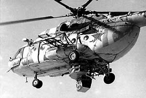

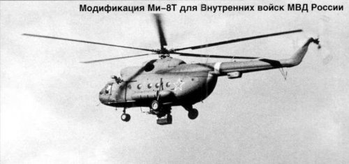

So far the only turreted armament on the Mi-8 series I am aware of is the 14.5mm armed Berkut-M26 system.
http://alternathistory.org.ua/afganskii-vzlet-berkuta
http://vertoletciki.forumbb.ru/viewtopic.php?id=222&p=24
Those sources say that it's predecessor was drawn from the GUV-8700 pod's armament - the GSh-G they say could potentially take out Manpads...
