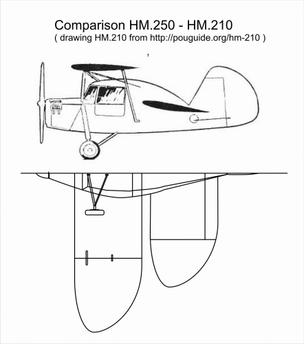

I think, it would have been quite similar to the HM.210. Started with redrawing
the plan view (side view is still unfinished) and noticed, that there are many
similarities, just compare HM.210-side view and HM.250-plan view. Maybe there
would have been an additional window for the second passenger, but I'm not
sure about this, as that seat is across to the direction of flight.

Thanks cluttonfred for this very interesting informations. You have also pics and/or 3view-drawing of the H.M.300 "Anette"?
Sorry, no 3-views, but here is another, grainy, shot of the single-seat and two-seat models that Mignet developed in Argentina.
Maveric said:
Had the H.M.250 the same technical data like the H.M.210?
What I found (from http://www.airwar.ru/enc/law1/hm210.html and the drawing we have of the
H.M.250), is:
H.M.210 H.M.250
span forward wing 6,00 m 7.60 m
span rear wing m 5,60 m
length 4.90 m 5,30 m
Taking into account the logically higher weight of the 3-seat H.M. 250, a linear enlargement
seems possible to me. The H.M.350 was a similar design, but with higher aspect ratio wings.
