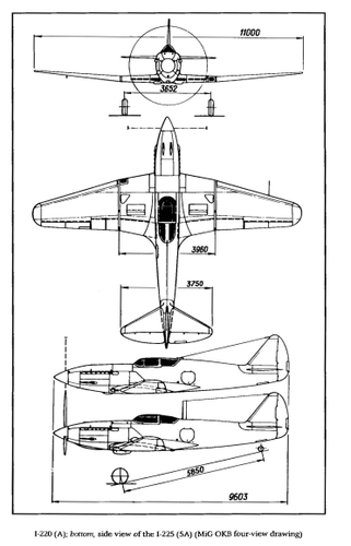

All Mig - I-220-222 and 224 was experimental fighters devoloped from Mig 3 for High altitude
You are not quite right - the I-220 (Aircraft "A") was a new design, with very little features inherited from the MiG-3.
Basically the ultimate Mikoyan/Gruevich (MiG) piston engine fighters. The I-225 for a time was the fastest Soviet piston engine fighter (though beaten by the Yak-3 M-108). The I-220 series are all very similar overall, though the I-220 though I-224 were primarily high altitude pursuit type interceptors. The I-225 was a more general purpose type, sort of along the lines of almost a hybrid of the Merlin-powered P-51 Mustangs and later Spitfires. All variants were powered by some variant of the Mikulin AM-42 V12 engine, better known for its use in the Ilyushin Il-10 ground attack aircraft, and was the ultimate versions of the Mikulin V12, which can trace the heritage of it's block and heads to the BMW VI of the 1920s. For use in the I-220 family, it was fitted with a turbocharger in addition to it's normal single stage supercharger (which was similar to what was used on the Allison V-1710).
All members of the I-220 family were armed with 4x20mm cannons and, especially the I-225, were high performance aircraft capable of performing well at all altitudes. The I-220 though I-224 were pressurized, while the I-225 wasn't. That is, when the turbo worked right.
Which is part of why I decided to put this here in the "what if" area. Mostly because it shows what the Soviets were ultimately capable of in terms of fighter design (the I-220s featured all metal monocoque construction and were fairly aerodynamically advanced), but also showed that the Soviets were behind in terms of engine and fuel tech (most Soviet fighters didn't use 100 octane fuel or effective two stage supercharging, hence had to rely on either lightweight aircraft, or big engines--the AM-42 was almost 47 liters in capacity and comprised nearly a 1/4 of the I-225's take off weight).
So let's discuss what impact the I-220s could've had, and maybe even how to improve them.

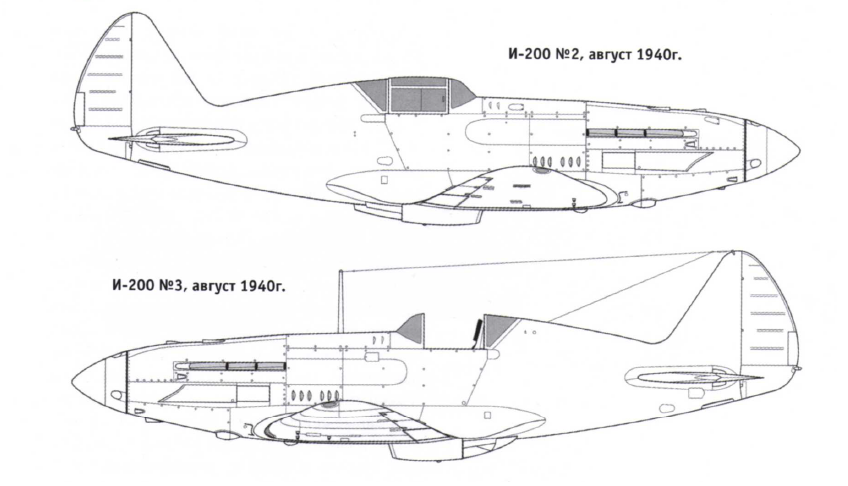

The I-200 high-altitude Soviet interceptor was designed in 1939 by the Polikarpov Design Bureau, inheriting all the deficiencies of its lineage and thus proving the correctness of the Latin sentence Errare humanum est, sed perseverare, diabolicum. (To err is human, but to persist is diabolical).
The extremely short fuselage had originally been designed for the I-185 fighter (powered by one radial engine) and was totally inadequate to compensate for the long and heavy AM-35A V-12 engine, with 1,350 hp.
During the flight tests performed on August 29, 1940, the prototype showed longitudinal instability, heavy control, and a dangerous tendency to flat spin.
It was difficult to fly and deadly in combat for an inexperienced pilot. Its instability at high speeds could make aerial gunnery difficult and requiring constant pilot intervention to remain on target.
A feature common to all Polikarpov fighters was the ‘snaking effect’ that affected weapon accuracy during combat maneuvers.
The triangular wing planform, with leading and trailing edge sweep and larger roots that tapered to the tips, were the cheapest compromise between performance, strength and drag. It was strong at the root, light at the tips and easy to build, and could be lethal, because the strongly tapered wings had a dangerous tendency to low-speed stall.
In combat, the I-200 was prone to spinning out of a steep banking turn. Despite the seriousness of the shortcomings displayed by the prototype, it was ordered into immediate mass production, as OKO MiG-1, in September 1940.

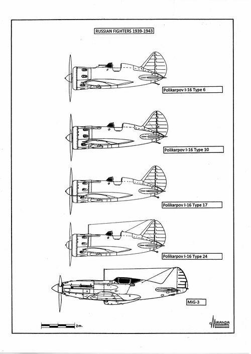

Meanwhile the Mikoyan-Gurevich Design Bureau (OKO-Kiev) worked feverishly to correct the MiG-1 deficiencies.
The MiG-3 was ordered into production in December 1940, but the improvements added nearly 500 lb. to the take-off weight and exacerbated its instability at high speeds. Its poor climb performance was caused by the excessive weight (1,830 lb.) of the AM-35A engine (Soviet version of Fiat A.20 V.12 with single-stage gear-driven supercharger) and the steel wing spar.
The aircraft was originally designed as a high-altitude interceptor with 37,700 ft. (11,500 m) service ceiling, but in practice few MiG-3 managed to reach that altitude due to the poor design of the fuel and oil pumps and the M-100's supercharger malfunction, as the impeller alloy AK-1 was prone to material fatigue.
In real combat conditions some planes entered irrecoverable spins flying at 30,000 ft. (9,150 m).
The MiG-3 had a take-off weight of 7,395 lb. (3,350 kg) at a time when the Yak-1 weighed 6,309 lb. (2,858 kg) and the Messerschmitt Bf 109 F-1 4,943 lb. (2,239 kg).
Designers were forced to reduce the armament to just three machine guns so as not to further degrade its climb performance.
On the Eastern Front most air-to-air combats were at altitudes below 16,400 ft. (5,000 m). The Yak-1 and LaGG-3 fighters powered by M-105 P (Hispano-Suiza 12 Y) engines attacked the German Henschel Hs 126 reconnaissance planes and the Junkers Ju 87 dive bombers as they tried to escape the Messerschmitt Bf 109 F fighters.
Attempts to use the MiG-3 as ground attack airplane and frontal low altitude fighter were a bloody failure.
The aircrafts used by the PVO in Moscow's defense failed to reach the high-flying Ju 86 P-2s during the day and, at night, their inaccurate PAK-1 gunsights, the low optical quality of the Plexiglas windscreen and the poor firepower, proved inadequate to destroy the Heinkel He-111 H bombers fitted with 270 kg armor.
Production of the MiG-3 was stopped in December 1941 and six fighter regiments in charge of the defense of Moscow were equipped with Lend-Lease Hawker Hurricanes Mk.II A and Mk.IIB.

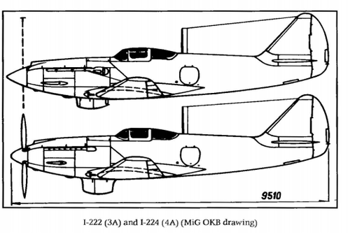

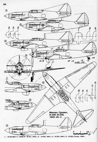

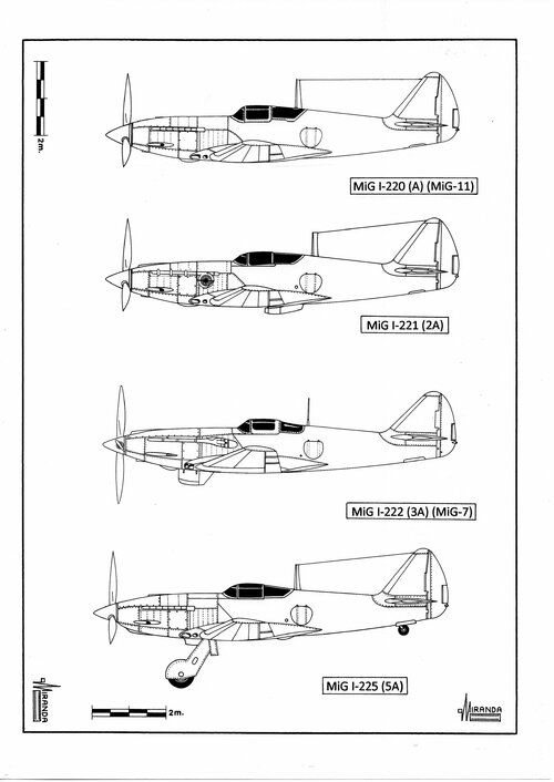

The MiG I-220 (MiG-11), powered by one AM-38F engine with single-speed GCS gear driven supercharger, was flight tested in July 1943. The prototype reached a ceiling of 31,160 ft. (9,500 m) only.
MiG-11 (I-220) technical data
Wingspan: 36 ft. (11 m), length: 31.5 ft. (9.60 m), height: 10.3 ft. (3.16 m), wing surface: 226 sq. ft. (20.38 sq. m), take-off weight: 8,050 lb. (3,647 Kg).
In September 1943, Polikarpov design bureau proposed the construction of a high-altitude interceptor with pressurized cockpit, AM-39B engine, 45,920 ft. (14,000 m) ceiling and 423 mph (680 km/h) top speed. The project, called VP (K), was cancelled in July 1944.

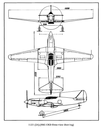

In December the MiG I-221 high-altitude prototype was flight tested at 42,640 ft. (13,000 m) powered by one AM-39 experimental engine with PTsN gear driven centrifugal compressor and two TsIAM TK-2B turbochargers.
The pilot was forced to bail out when the compressor disintegrated rotating at 24,000 rpm.
MiG I-221 technical data
Wingspan: 42.6 ft. (13 m), length: 31.3 ft. (9.55 m), height: 10.3 ft. (3.16 m), wing surface: 249 sq. ft. (22.44 sq. m), take-off weight: 8,583 lb. (3,888 Kg).
In February 1944, the Spitfires Mk. IXb started to arrive to the U.S.R.R. until reaching a number of 1,183 units in several months, giving the Soviets access to the technology of the Merlin 61 and 62 engines. Their two speeds, two stage gearbox with intercooler, were studied by the scientists of the Air Force Research Institute (NKAP LII) for reverse-engineering purposes.
On May 7, 1944, the MiG I-222 (MiG-7) was flown powered by one AM-39 B-1 high-altitude engine fitted with one TK-300 turbocharger placed in the port engine block, while maintaining the jet exhaust in the other block.
The prototype reached 47,560 ft. (14,500 m) absolute ceiling and continued its testing until 1945, but mass production was discarded due to the availability of the British Lend-Lease Spitfire HF Mk IXb, with 45,000 ft. (13,720 m) ceiling.
MiG I-222 technical data
Wingspan: 42.6 ft. (13 m), length: 31.5 ft. (9.6 m), height: 10.3 ft. (3.16 m), wing surface: 249 sq. ft. (22.44 sq. m), take-off weight: 8,366 lb. (3,790 Kg).

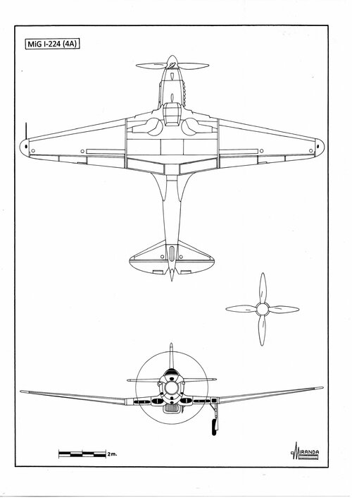

The MiG I-224, powered by one AM-42 TK (with the TK-300B turbocharger mounted on its starboard side), was flown on October 20, 1944. The prototype reached 46,250 ft. (14,100 m) and 397 mph (639 km/h) top speed.
MiG I-224 technical data
Wingspan: 42.6 ft. (13 m), length: 31.2 ft. (9.51 m), height: 10.3 ft. (3.16 m), wing surface: 249 sq. ft. (22.44 sq. m), take-off weight: 8,344 lb. (3,780 Kg).

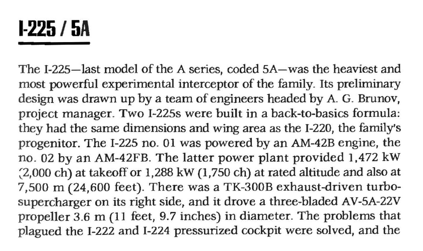

On March 14, 1945, the MiG I-225 prototype, powered by one AM-42 FB with intercooler and two TK-1A turbochargers, reached 726 km/h flying at 10,000 m.
MiG I-225 technical data
Wingspan: 36 ft. (11 m), length: 31.5 ft. (9.60 m), height: 12 ft. (3.7 m), wing surface: 226 sq. ft. (20.38 sq. m), take-off weight: 8,609 lb. (3,900 Kg).

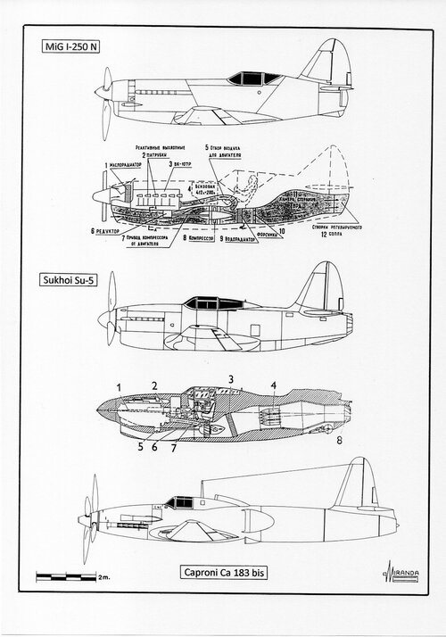

While it barely reached production, I think the MiG 13 motorjet fighter qualifies as on of these projects.
The appearance in combat in July 1944 of the new German swept-wing fighters Messerschmitt Me 262 A-1, with 591 mph (870 km/h), and Messerschmitt Me 163 with 597 mph (960 km/h), forced the Allies to speed up the entry into service of their own jet fighters de Havilland Vampire, Gloster Meteor Mk.III and Lockheed P-80 A.
Since the USSR lacked a serviceable turbojet, government and military officials became increasingly disturbed about the substandard performance of their frontline fighters.
To solve the speed problem, the State Defense Committee (GKO) resorted to desperate measures fitting with one Campini afterburner the experimental interceptors MiG I-250 (MiG-13) and Sukhoi I-107 (Su-5).
The TsIAM/Kholshchevnikov VRDK propulsion system consisted of 1,650 hp. Klimov VK-107 reciprocating engine, driving a ducted fan compressor by means of power shaft. The compressor was fed by a nose air scoop. The compressed air was sprayed with fuel from seven gas-steam jets and ignited in one stainless steel combustion chamber, generating 660 lb. forward thrust.
The GKO specification (May 2, 1944) required a high-altitude VRDK boosted fighter with 33,000 ft. (10,000 m) service ceiling and 497 mph (800 km/h) top speed. Each design bureau should have two prototypes ready by March 1945.
The MiG I-250 was flown on March 3, 1945, under piston engine alone.
In March 1943 the prototype reached a maximum speed of 513 mph (825 km/h) and 39,230 ft. (12,000 m) ceiling, using the VRDK afterburner, but the airframe was not properly designed to fly at high-speed and low altitude. On July 5, 1945, the prototype suffered compressibility tail flutter and disintegrated.
With the VRDK running the I-250 endurance was 10 minutes maximum and the combustion chamber lifespan was 35 operational hours only.
Despite of these shortcomings the aircraft was ordered into production, as MiG-13, to be used as a point-defense interceptor against Boeing B-29 bombers in a future war.
The first eight pre-production machines, fitted with “scimitar” propellers, were delivered for service trials but suffered engine problems that prevented a planned appearance in the Summer Aviation Day display at Tushino airfield on August 3, 1946.
MiG I-250 technical data
Wingspan: 31 ft. (9.5 m), length: 26.8 ft. (8.18 m), height: 8.5 ft. (2.6 m), wing surface: 166.6 sq. ft. (15 sq. m), take-off weight: 8,678 lb. (3,931 Kg).
The Sukhoi Su-5 prototype was flown nn April 6, 1945, reaching 503 mph (809 km/h) and 39,370 ft. (12,000 m) but the supercharger of the VK-107 engine was disintegrated on July 15, 1945.
During testing, it was determined that the Su-5 was inferior to the MiG, with only three minutes of afterburner operation.
No further VK-107 engines could be procured. The second prototype was never flown, and the Su-5 was cancelled in November 1946.
Sukhoi Su-5 technical data
Wingspan: 34.6 ft. (10.56 m), length: 27.9 ft. (8.51 m), height: 11.6 ft. (3.53 m), wing surface: 183 sq. ft. (17 sq. m), take-off weight: 8,387 lb. (3,804 Kg).

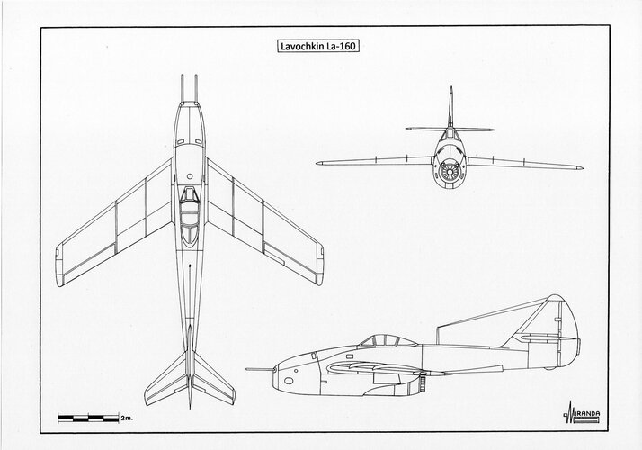

The VRDK program was also cancelled on April 3, 1948, in favor of the Yak-15 fighter powered by one German turbojet.

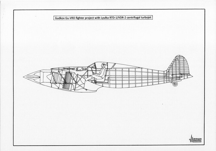

Further development of the Soviet RDT-1 turbojet led to the RDT-1/VDR-2, designed in 1939, with a new two-stage axial compressor added to the inlet.
The construction of one prototype that promised 750 kg thrust started in 1940. The new engine, with 2.2 m length and 1.06 m of diameter, was very similar in shape and dimensions to the German HeS 8. It was also cancelled in mid-1943 when the prototype was 70 percent built.
RDT-1/VDR-2 was scheduled to power the first Soviet jet fighter Gudkov Gu-VRD which also had to be cancelled.
Gu-VRD technical data
Wingspan: 31 ft. (9.5 m), length: 30.5 ft. (9.9 m), height: 9.68 ft. (2.95 m), wing surface: 122 sq. ft. (11 sq. m), take-off weight: 4,967 lb. (2,250 Kg), estimated maximum speed: 560 mph (900 km/h), proposed armament: one ShVAK 20 mm cannon and two UBS 12.7 mm machine guns.

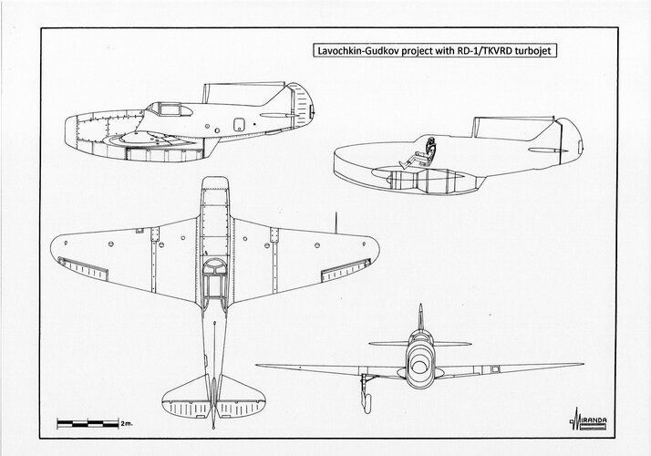

In summer 1943, Lyulka started the design of the S-18/VRD-3 eight-stage axial-flow turbojet, with 2.10 m length and 0.75 m of diameter.
The new engine was bench tested in August 1945 giving 1,268 kg static thrust, but their mass production was dismissed because steel turbine blades were not heat-resisting enough for use in operational airplanes, due to technological backwardness of Soviet metallurgy alloys.

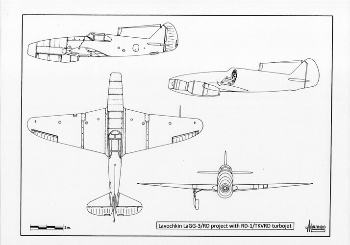

It was also necessary to cancel two fighter projects that had been designed to use RD-1/TKVRD axial-flow turbojets: The LaGG-3/RD (October 1942) and the Lavochkin-Gudkov VRDK-1 (1943).
LaGG-3/RD technical data
Wingspan: 34.4 ft. (10.5 m), length: 29 ft. (8.9 m), height: 8 ft. (2.45 m), wing surface: 202.6 sq. ft. (18 sq. m), estimated maximum speed: 435 mph (700 km/h).
Gu-VRDK-1 technical data
Wingspan: 32 ft. (9.8 m), length: 29 ft. (8.9 m), height: 7.6 ft. (2.03 m), wing surface: 188.5 sq. ft. (17 sq. m), take-off weight: 4,967 lb. (2,250 Kg), estimated maximum speed: 541 mph (870 km/h).

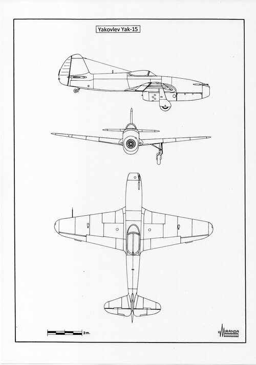

In response to a State Defence Committee requirement issued in February 18, 1945, for a 900 km/h pure jet fighter, the Soviets demonstrated with their stopgap jet fighter Yak-15 that German precautions were unfounded. The new Yakovlev fighter was based on the same formula as the Projekt I and was powered by the same turbojet, being mass-produced, and entering into service in May 1947.
The integration of the turbojet in redan (stepped) configuration with the airframe of a Yak-3 piston fighter was relatively simple. It was only necessary to modify the wing spar central section, replace the tailwheel with a steel roller, protected by a blast deflector, and to cover the lower part of the fuselage with steel plates.
Yak-15 technical data
Power plant: one Koliesov RD-10 turbojet rated at 900 kg static thrust, wingspan: 30.2 ft. (9.20 m), length: 28.5 ft. (8.70 m), height: 7.4 ft. (2.27 m), wing surface: 159.85 sq. ft. (14.85 sq. m), take-off weight: 6,029 lb. (2,735 Kg), maximum speed: 500 mph (805 km/h), service ceiling: 43,800 ft. (13,350 m), armament: two 23 mm Nudelman-Suranov NS-23 cannon in the top of the nose.

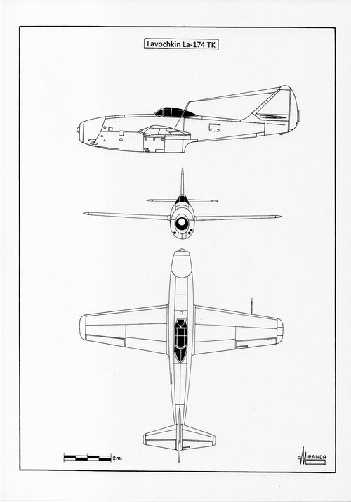

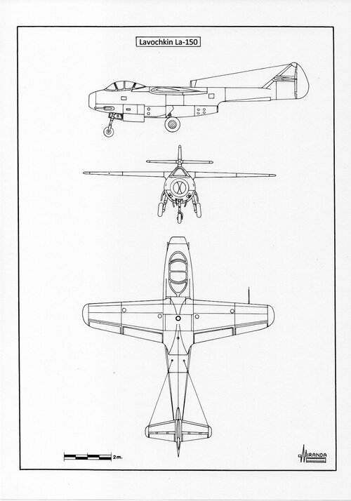

- Unfortunately for Lavochkin OKB it was not possible to use the same solution of the Yak-15 with the La-9 piston fighter because the wing structure and landing gear could not be easily modified to replace the ASh-82 FN piston engine with an RD-10 without making a major redesign of the airframe.
This was a major setback because all OKB-dependent production facilities were preparing to start the manufacturing, in October 1946, of a series of 1,630 La-9 conventional fighters at Gorky Plant No. 21.
It was necessary to create the completely new design La-150 with shoulder wing, pod-and-boom configuration and the engine mounted behind the cockpit.
Some German features were adopted by Lavochkin: the nose air intake, the cockpit placed at the front of the fuselage and the fuselage-mounted, narrow-track, tricycle type landing gear, to avoid damaging runways, from the Focke-Wulf Ta 183 jet fighter project, the bifurcated air ducts from the Focke-Wulf Project P 011.025 (November 1944) jet fighter project and the bubble canopy from the Junkers Ju 248 V2 rocket fighter prototype captured at Kassel-Bettenhausen.
Fabrication of the La-150 prototypes had been delayed because the OKB was committed to other programs.
Five testing airplanes were built at Moscow Plant Nº 381 and the first of them was flown on September 11, 1946, reaching 546 mph (878 km/h), but it was not a success.
The aircraft showed many shortcomings during flight tests: duct power losses, high airframe weight, excessive oscillation of the tail surfaces caused by tail boom stiffness, lateral instability, and poor elevator forces.
A pre-series of 15 machines, with 25 per cent enlarged vertical stabilizer, were built at Gorky factory under the designation La-13 but their structural stiffness could not be overcome, and the La-150 development was stopped in December 1947.
Lavochkin La-150 technical data
Power plant: one Koliesov RD-10 turbojet rated at 900 kg static thrust, wingspan: 26.9 ft. (8.20 m), length: 39.9 ft. (9.42 m), height: 8.5 ft. (2.6 m), wing surface: 130.8 sq. ft. (12.15 sq. m), take-off weight: 6,528 lb. (2,961 Kg), maximum speed: 546 mph (878 km/h), service ceiling: 41,328 ft. (12,600 m), armament: two nose mounted 23 mm Nudelman-Suranov NS-23 cannon.

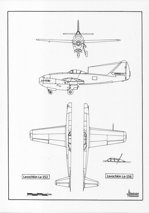

Designed in parallel with the La-150, the La-152 prototype was powered by one nose mounted RD-10 turbojet in redan configuration. The 9.1 % thickness wing planform and tail surfaces were very similar to those of the La-150 but the mid-wing configuration and the folding-rearwards landing gear were based on those of the Messerschmitt P 1101 (February 22, 1945) and P 1106 (February 22, 1945) jet fighters projects.
The prototype was flown on December 5, 1946, reaching 522 mph (840 km/h) but crashed during state acceptance trials, on July 12, 1947, when the engine failed.
Lavochkin La-152 technical data
Power plant: one Koliesov RD-10 turbojet rated at 900 kg static thrust, wingspan: 26.9 ft. (8.20 m), length: 29.9 ft. (9.12 m), height: 11.4 ft. (3.48 m), wing surface: 130.8 sq. ft. (12.15 sq. m), take-off weight: 7,141 lb. (3,239 Kg), maximum speed: 522 mph (840 km/h), service ceiling: 35,105 ft. (10,700 m), armament: two nose mounted 23 mm Nudelman-Suranov NS-23 cannon.

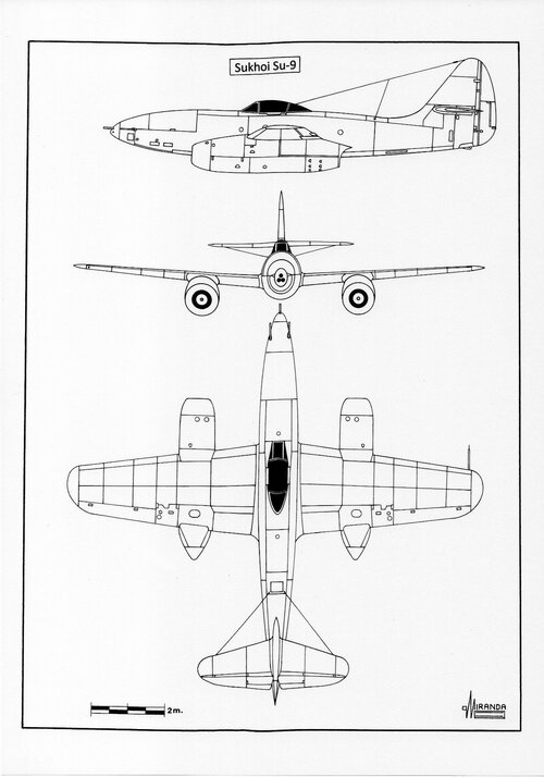

Owing to the urgency with which the program was attended, the Sukhoi Su-9 design, with two wing-mounted Jumo 004B turbojets, was very influenced by the Me 262 captured on March 30, 1945, and flight tested on August 15, 1945.

The Su-9 prototype was flown on November 13, 1946, reaching 550 mph (885 km/h) but further development of the fighter was abandoned in favor of the MiG-9 series production.
Su-9 technical data
Power plant: two Koliesov RD-10 turbojets rated at 900 kg static thrust, wingspan: 36.8 ft. (11.21 m), length: 34.7 ft. (10.57 m), height: 12.2 ft. (3.72 m), wing surface: 217.87 sq. ft. (20.24 sq. m), take-off weight: 14,065 lb. (6,380 Kg), maximum speed: 550 mph (909 km/h), service ceiling: 42,000 ft. (12,800 m), equipment: one Heinkel Kartusche ejector seat.

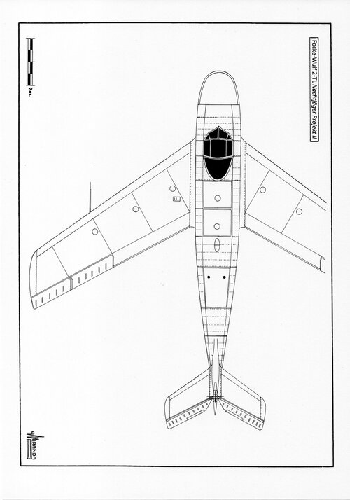

- In April 1945 a special commission from the People´s Commisariat of the Aviation Industry flew to Berlin for examine German technical advances in the field of Aviation.
At the home offices of RLM, OKL and DVL institute, the Soviets had access to the technological secrets of the latest Focke-Wulf designs, when scored a complete set of Ta 183 blueprints, several scale models of the Ta 183 A-0 and many valuable technical documents of swept wing research by professors Goethert and Ruden.
Several DVL employees, including its head professor Bock, were interrogated, providing valuable information about wind tunnel tests performed with swept wings at critical Mach numbers.
In the autumn of 1945, Kurt Tank met with representatives of the GPU (Soviet Military Intelligence) who invited him to continue the development of the Ta 183 jet fighter in the USSR.
Especially interesting to Soviets was the design of the Ta 183 constant chord swept wing because it could be manufactured in wood/plywood, contain fuel and reach transonic speeds.
In addition, this type of wing performed well at low speeds without the installation of the leading edge automatic slats of the Messerschmitt designs that were very difficult to reproduce with Soviet manufacturing techniques.

During January 1946 the State Defence Committee issued a specification for a high-altitude interceptor with Mach 0.9 top speed and 30,000 ft. service ceiling.
A high-speed variant of the La-156 was fitted with 35-degree (25% chord-9.5% thickness) swept wings and a 44-degree swept tailplane based on those of the Focke-Wulf Ta 183 A-0 (October 1944) project.
The prototype, named La-160, was flown on June 24, 1947, powered by one RD-10 turbojet. After initial trials the aircraft was fitted with one RD-10 F engine, ejector seat and two boundary layer fences on each wing to overcome the problems of span wise flow. These anti-turbulence devices were patented by the Dipl. Ing. Wolfgang Liebe in 1938 after testing on the Messerschmitt Bf 109 B.
The La-160 reached a post-dive speed of 659 mph (1,060 km/h-Mach 0.92) flying at 5,700 m. but the transonic research program came to an end when the prototype disintegrated in September 1947 during a high-speed run, due to severe wing flutter.
Lavochkin La-160 technical data
Power plant: one Kazan RD-10F turbojet rated at 1,100 kg static thrust, wingspan: 29.3 ft. (8.95 m), length: 33 ft. (10.07 m), height: 12.9 ft. (3.9 m), wing surface: 171.15 sq. ft. (15.9 sq. m), take-off weight: 8,951 lb. (4,060 Kg), maximum speed: 659 mph (1,060 km/h), service ceiling: 36,080 ft. (11,000 m), armament: two nose mounted 23 mm Nudelman-Suranov NS-23 cannon.

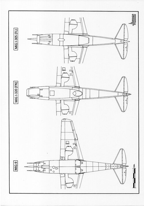

- The Yak-19 had been designed on June 15, 1946, with pod-and-boom configuration, 12% thickness laminar flow wing and RD-10 engine, but in late June 1946 the project was modified with an RD-10F engine. To meet the January 1946 specification, it was necessary to redesign the fuselage with a more aerodynamically efficient "flying stovepipe" configuration to install the afterburner under the tailfin.
The prototype was flown on January 8, 1947, reaching 564 mph (907 km/h) but the project was cancelled on August 21, 1947, due to problems experienced with the afterburner and the roll control.
Yak-19 technical data
Power plant: one Kazan RD-10F turbojet rated at 1,100 kg static thrust, wingspan: 28.5 ft. (8.7 m), length: 27.4 ft. (8.36 m), height: 10.9 ft. (3.3 m), wing surface: 145.3 sq. ft. (13.50 sq. m), take-off weight: 6,724 lb. (3,050 Kg), maximum speed: 564 mph (907 km/h), service ceiling: 39,600 ft. (12,100 m), armament: two nose mounted 23 mm
Sh-23 cannon, equipment: ejector seat.
To meet the April 1946 specification issued by the Council of People’s Commissars, calling for a jet fighter powered by the indigenous Lyulka turbojet, the prototype La-154 was to have been fitted with one TR-1 engine, but it was abandoned in 1947 because this engine was not considered safe for use in single engine fighters. The integration program was assigned to the development of the heavy fighters Sukhoi Su-11 and Alekseyev I-211.
MiG OKB decided to build a lighter version of the MiG-9 powered by only one turbojet.
It was expected to be able to use one Lyulka TR-1A rated at 1,500 kg in the prototype I-305/FL and a reheated variant, with 2,000-2,500 kg thrust in the MiG-9 FL series version.
The prototype was completed at the end of 1947, but the Lyulka exploded on the test bench and the FL project was discontinued.
MiG I-305/FL technical data
Power plant: one Lyulka TR-1A turbojet rated at 1,500 kg static thrust, wingspan: 32.8 ft. (10 m), length: 31.8 ft. (9.70 m), height: 10.8 ft. (3.20 m), wing surface: 202.2 sq. ft. (18.20 sq. m), take-off weight: 10,088 lb. (4,570 Kg), estimated maximum speed: 557 mph (897 km/h), estimated service ceiling: 43,952 ft. (13,400 m), equipment: pressurized cockpit and ejector seat.

On March 11, 1947, the Council of People’s Commissars ordered to Lavochkin, Yak and MiG bureaus the development of two new fighters powered by British turbojets: one general-purpose tactical fighter with 950 km/h top speed and Derwent engine and one high-altitude Mach 0.9 interceptor with Nene turbojet.
Each OKB proposed two versions of each model: one with straight wings and pod-and-boom configuration and another with swept wings and "flying stovepipe" configuration.
March 11, 1947, tactical fighter development:
In an attempt to improve the performance of the La-156, a thin wing version was built with a thickness ratio of only 6 per cent and 200 kg less weight.
The new prototype, named La-174 TK, was flown in January 1948, reaching 603 mph (970 km/h).
Lavochkin La-174 TK technical data
Power plant: one Roll-Royce Derwent V turbojet rated at 1,590 kg static thrust, wingspan: 28.3 ft. (8.64 m), length: 30.9 ft. (9.41 m), height: 12 ft. (3.7 m), wing surface: 145.53 sq. ft. (13.52 sq. m), take-off weight: 7,308 lb. (3,315 kg), maximum speed: 603 mph (970 km/h), service ceiling: 44,280 ft. (13,500 m), armament: three nose mounted 23 mm Nudelman-Suranov NS-23 cannon.

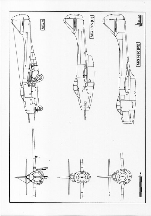

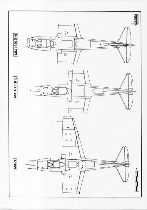

Late in 1947 a production MiG-9 was modified replacing the two RD-20 turbojets with one Nene Mk.I.
To accommodate the new centrifugal engine of 1,257 mm of diameter it was necessary to redesign the fuselage but the project, named I-320/FN (a project without any connection with the I-320 R-1 night fighter) was cancelled in favor of the new I-310 S swept wing prototype.
MiG I-320/FN technical data
Power plant: one Rolls-Royce Nene Mk.I turbojet rated at 2,230 kg static thrust, wingspan: 32.8 ft. (10 m), length: 35.7 ft. (10.88 m), height: 10.76 ft. (3.23 m), wing surface: 202.2 sq. ft. (18.20 sq. m).

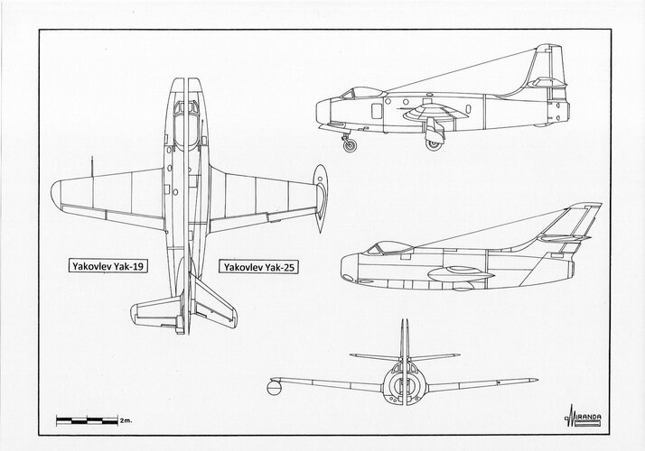

The Yak-25 was an improved variant of the Yak-19, with "flying stovepipe" configuration, 9% thickness straight wing and 45-degree swept back tail surfaces, powered by one Derwent V turbojet.
The prototype was flown on October 31, 1947, reaching 610 mph (982 km/h) but the project was discontinued on July 1948 due to extremely severe tail buffeting.
Yak-25 technical data
Power plant: one Rolls-Royce Derwent V centrifugal turbojet rated at 1,590 kg static thrust, wingspan: 29.1 ft. (8.88 m), length: 28.3 ft. (8.65 m), height: 11.87 ft. (3.62 m), wing surface: 150 sq. ft. (14 sq. m), take-off weight: 7,022 lb. (3,185 kg), maximum speed: 610 mph (982 km/h), service ceiling: 46,000 ft. (14,000 m), armament: two nose mounted 23 mm NR-23 cannon, equipment: ejector seat.

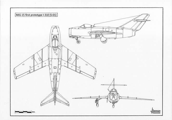

When it became apparent that the reheated Lyulka TR-2 with 2,500 kg thrust was not going to be available, the MiG I-305/FL was completely redesigned to reduce the weight to a maximum of 4,500 kg.
To meet the March 11, 1947, specification the airplane received the project designation I-310 S.
The I-310 S initial project was expected to be powered by an RD-10F, but as British centrifugal turbojets became available, it was necessary to redesign the fuselage with a diameter of 1,512 mm.
Having the excess power generated by the new British turbojets, the Soviet designers were able to abandon the pod-and-boom system and build lighter fuselages with the same tubular structure of the Junkers Ju 248, already tested on the MiG I-270.
The MiG I-310 S had mid-mounted wings with 35-degree swept (25% chord), 2-degree anhedral, fitted with fences to delay the migration of the pressure center at high speed, 55.7-degree swept tailfin, 40-degree swept mid-high tail plane and nose mounted bubble canopy.
The prototype I-310 S-01 was flown on December 30, 1947, powered by one Rolls-Royce Nene Mk.I and was cleared for mass production, under the designation MiG-15, at State Aircraft Factory I.
MiG I-310 S-01 technical data
Power plant: one Roll-Royce Nene Mk.I centrifugal turbojet rated at 2,230 kg static thrust, wingspan: 33 ft. (10.08 m), length: 33.1 ft. (10.10 m), height: 12 ft. (3.7 m), wing surface: 228.8 sq. ft. (20.6 sq. m), take-off weight: 10,640 lb. (4,820 kg), maximum speed: 648 mph (1.042 km/h), service ceiling: 49,856 ft. (15,200 m), armament: two nose mounted 23 mm Nudelman-Suranov NS-23 cannon and one 37 mm N-37 cannon.

The La-168 was a better performing aircraft than the I-310S but its narrow track landing gear was not considered suitable for rough-field operations.
Lavochkin La-168 technical data
Power plant: one Roll-Royce Nene Mk.I centrifugal turbojet rated at 2,230 kg static thrust, wingspan: 31.2 ft. (9.5 m), length: 34.6 ft. (10.56 m), height: 11.47 ft. (3.5 m), wing surface: 194.6 sq. ft. (18.08 sq. m), take-off weight: 10,097 lb. (4,580 kg), maximum speed: 674 mph (1.084 km/h-Mach 0.914), service ceiling: 42,650 ft. (13,000 m), armament: two nose mounted 23 mm Nudelman-Suranov NS-23 cannon and one 37 mm N-37 cannon.

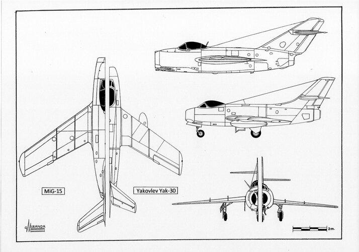

The Yakovlev response to the March 11, 1947, requirement was the Yak-30, an advanced version of the Yak-25 with 35-degree swept wings and 35-degree tailplane.
The prototype was flown on September 4, 1948, reaching 659 mph (1,060 km/h) powered by one Derwent V turbojet.
Factory testing concluded on December 16, 1948.
Yak-30 technical data
Power plant: one Roll-Royce Derwent V centrifugal turbojet rated at 1,590 kg static thrust, wingspan: 28.4 ft. (8.65 m), length: 29 ft. (8.86 m), height: 11.55 ft. (3.52 m), wing surface: 161.5 sq. ft. (15 sq. m), take-off weight: 7,286 lb. (3,305 kg), maximum speed: 659 mph (1.060 km/h), service ceiling: 49,200 ft. (15,000 m), armament: two nose mounted 23 mm Nudelman-Suranov NS-23 cannon and one 37 mm N-37 cannon.
