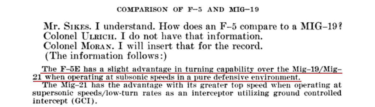

In terms of timeframe, capabilities, and fighter generations, wouldn't F-5 vs. MiG-21 be a more apt/relevant comparison?

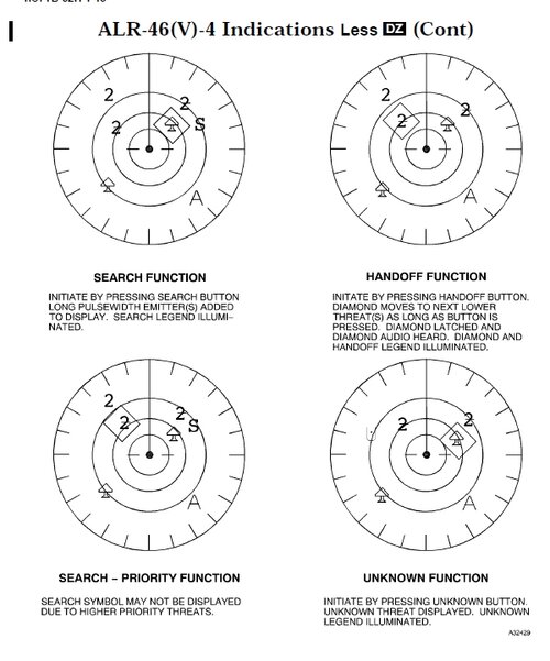

I forgot to mention the RWR and countermeasures. The MiG was never equipped with countermeasures, at least the -P model wasn’t. The F-5, in comparison, had a full complement of chaff and flares. Only later MiG-19 variants were equipped with RWRs but these were very primitive. Definitely inferior to the F-5s.
F-5E: 1678603018035.jpeg
MiG-19P: (it’s a simulator but you get the idea)

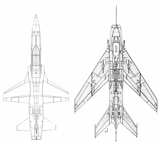

A simple comparison shows the obvious superiority of the MiG-19
F-5E, wing load 630 kg/m2, thrust-to-weight ratio 0.42
MiG-19S, wing load 351 kg/m2, thrust-to-weight ratio 0.74
The sweep of the F-5E wing is 24 degrees, the MiG-19C is 55 degrees
630 kg/m2 : 351 kg/m2 * 0,74 : 0,42 * 24 : 55 = 1.37
37% in favor of the MiG-19S. Of course, it is necessary to take into account as many factors as possible for a more accurate comparison

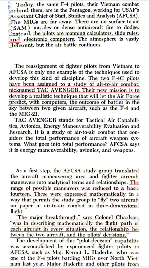

On paper, the MiG-21 was almost 2 times superior to the Tiger in terms of thrust-to-weight ratio, speed (about 2M versus 1.6M), rate of climb (225 m/s versus 175 m/s) and in all other dynamic characteristics. The best test pilots, all as one Heroes of the Soviet Union, sat at the controls of the machines. Equal conditions for the start of the battle, the optimal amount of fuel in the tanks, the telemetry systems are on. Take off!
18 battles were fought by Soviet aces, and not once did the MiG-21bis manage to get into the tail of the F-5E. The devil was hiding in the details: a lower specific load on the wing, developed influxes in the root part of the wings, slotted flaps and developed slats - all this gave the F-5E an advantage in close air combat. The "American" was also helped by its original "shark" nose, equipped with vortex generators - such a design significantly increased the stability of the "Tiger" at low speeds, and made it possible to conduct maneuverable air combat at critical angles of attack.
The armament of the small fighter was also initially "sharpened" for maneuvering battles - two built-in automatic guns of 20 mm caliber with 280 rounds of ammunition for each barrel. All this, coupled with excellent visibility from the cockpit, made the Tiger an extremely dangerous opponent in close combat.
Experienced specialists also noted the great survivability of the F-5E, thanks to its twin-engine layout and the absence of wing-mounted fuel tanks - the aircraft could return from a mission with riddled planes.

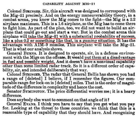

In March 1973, an air force colonel testified that " But in the combat arena this airplane (F-5E) will take the Mig-21 with a substantial probability of success, like a plus 0.2 or something like that, in a gaming situation. "
I vaguely recalled reading somewhere that Mig-17 and Mig-19 were considered more useful than Mig-21 in Vietnam war since the early missile was not very reliable and Mig-21 turn performance is not very good.
For this pair, the table gives exactly two times less, the most perfect MiG-21SMT loses 9.9 %
When the colonel said that 50 years ago, it must have been against earlier MiG-21 versions and probably by TAC AVENGER program.
Below is from the January 1968 issue of the Air Force magazine.

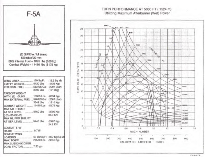

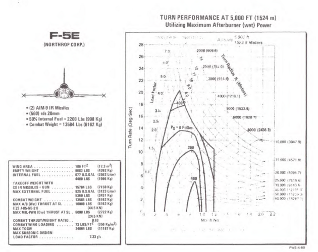

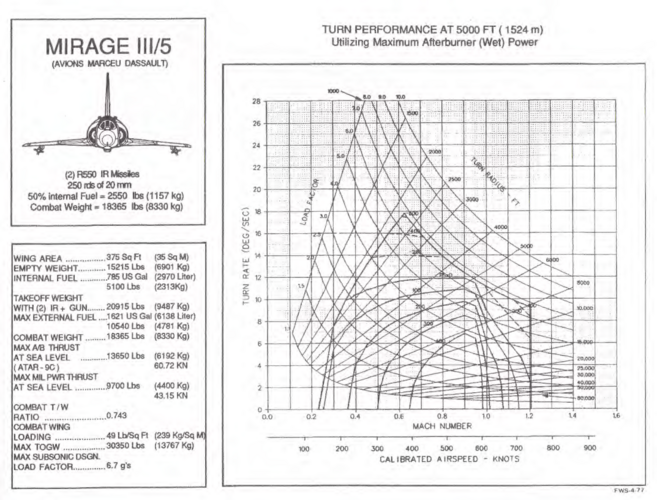

I found the turn rate chart for F-5A and F-5E and even Mirage III, unfortunately, no luck finding anything related to Mig-19.
It is surprising but F-5A can sustain turn better than F-5E while F-5E has better ITR. (I thought it would be opposite)
