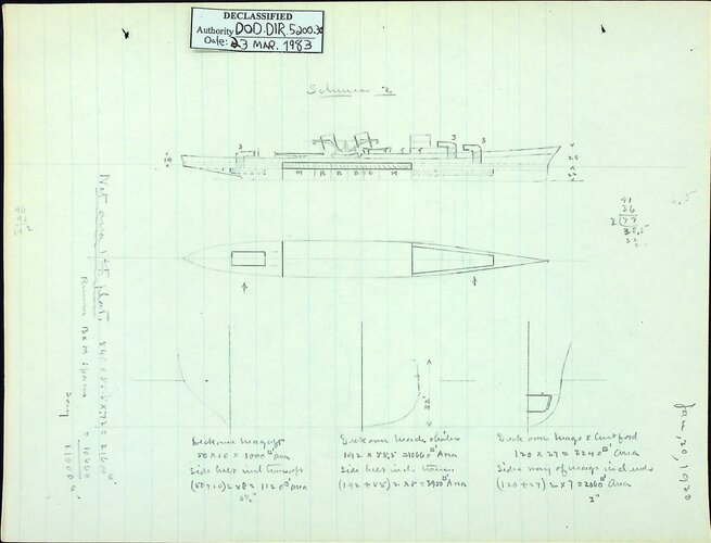

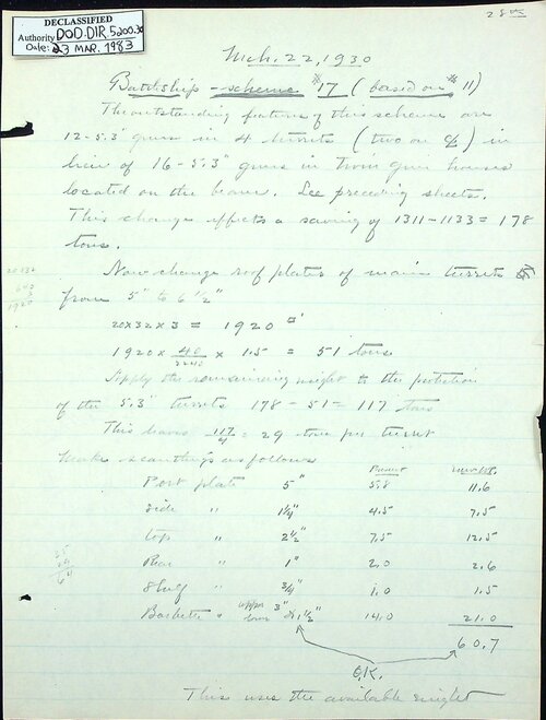

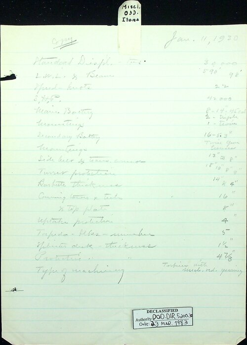

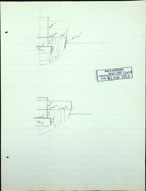

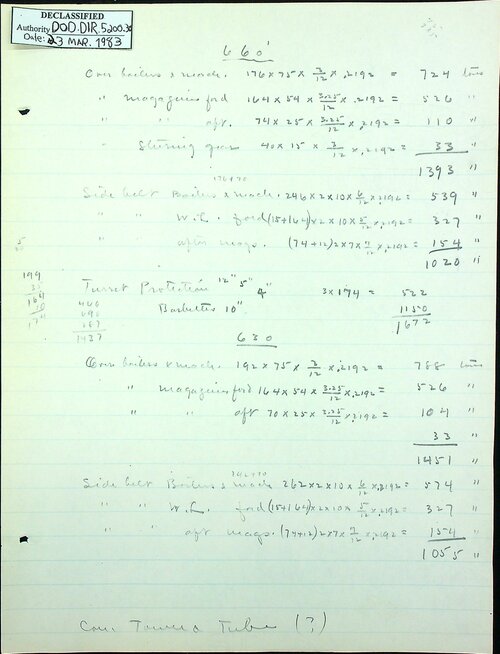

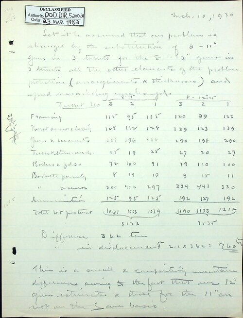

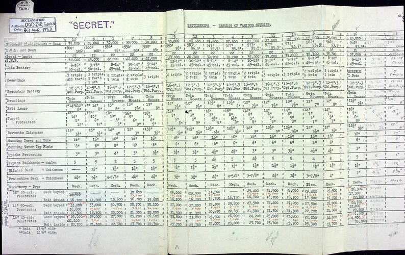

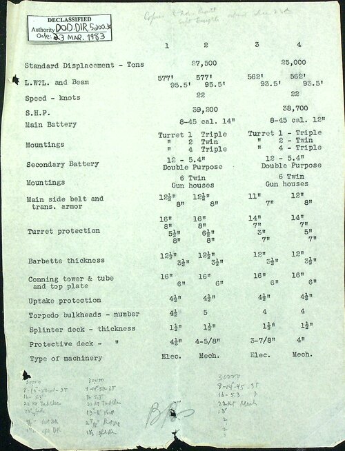

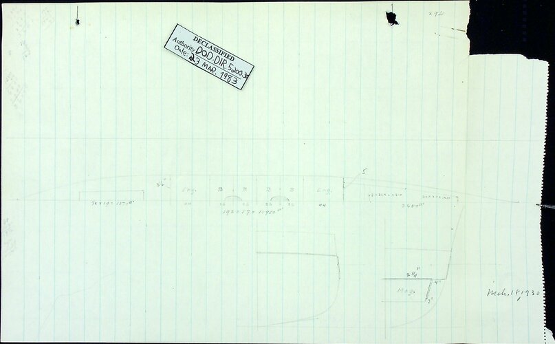

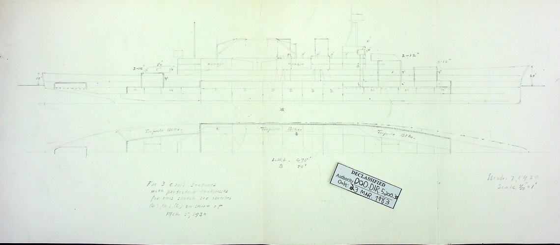

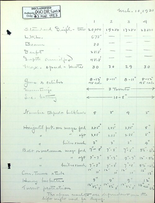

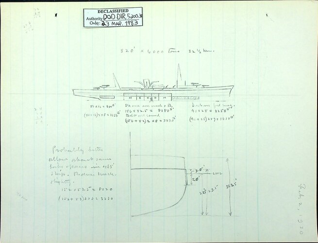

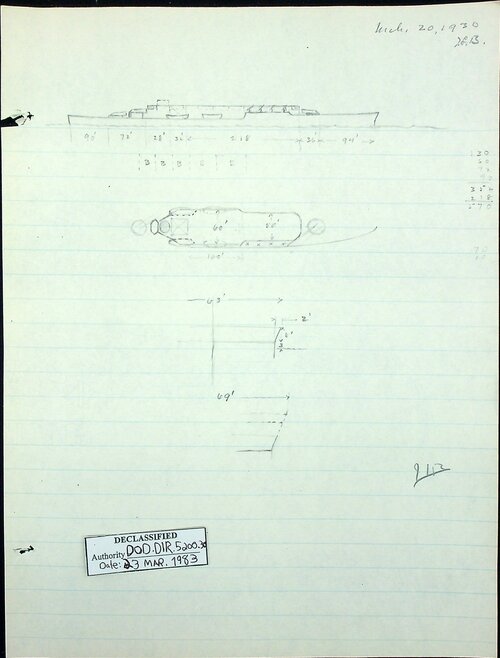

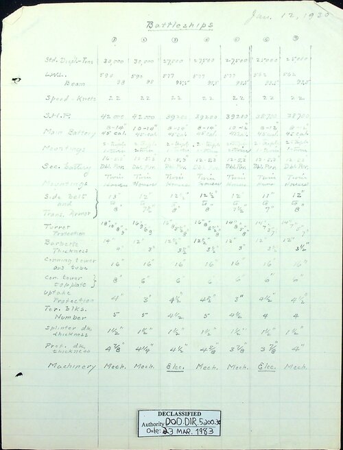

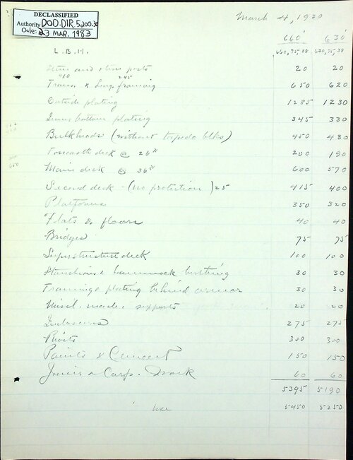

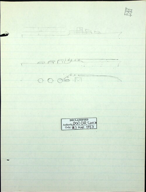

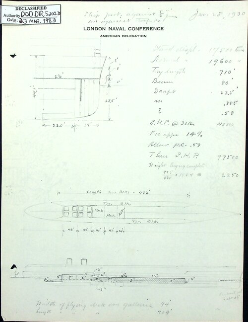

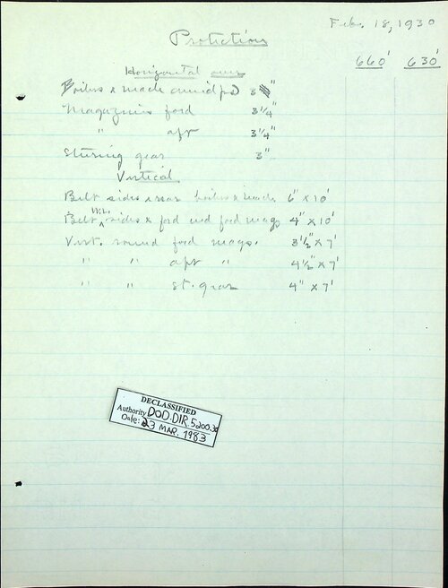

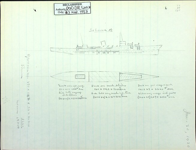

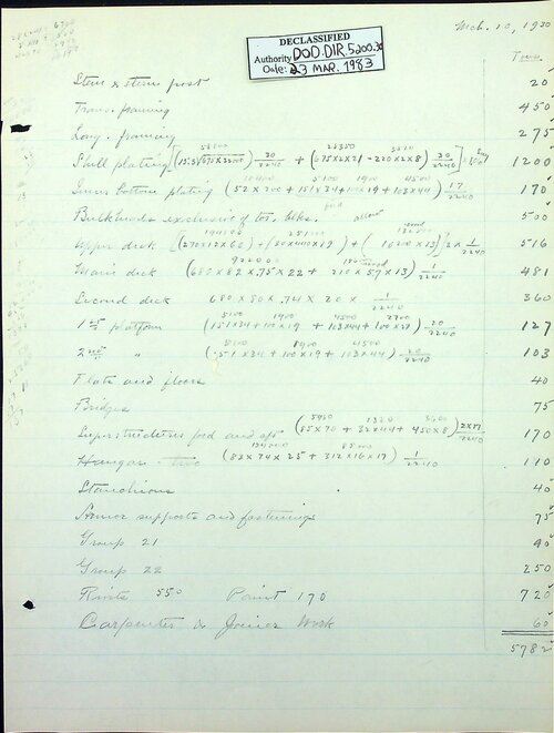

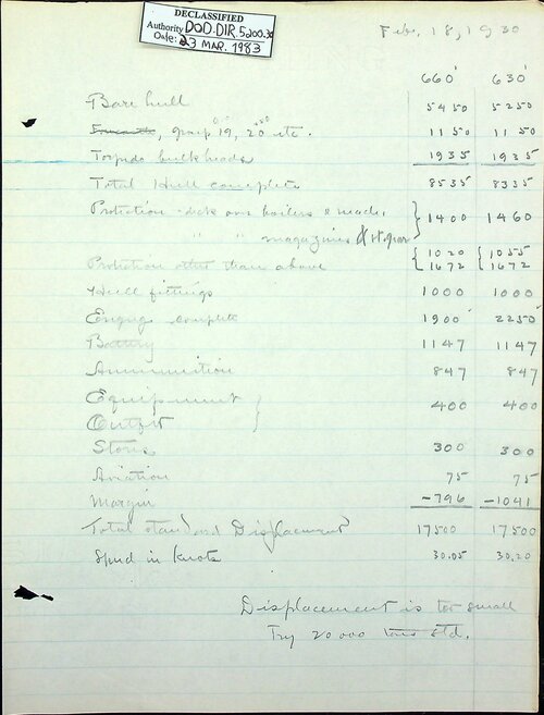

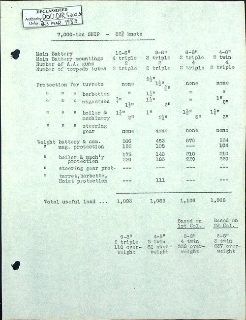

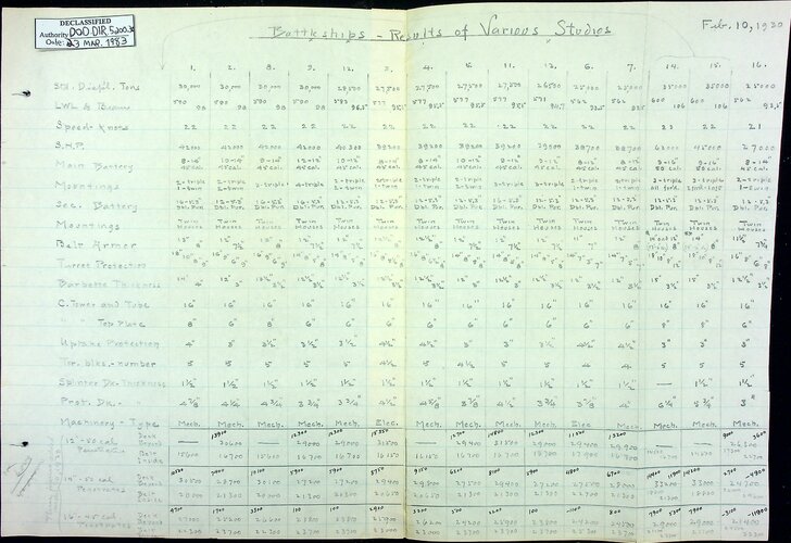

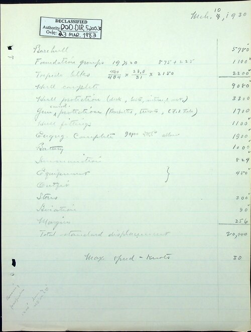

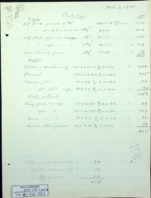

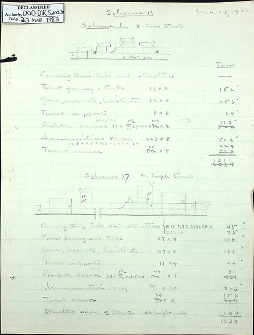

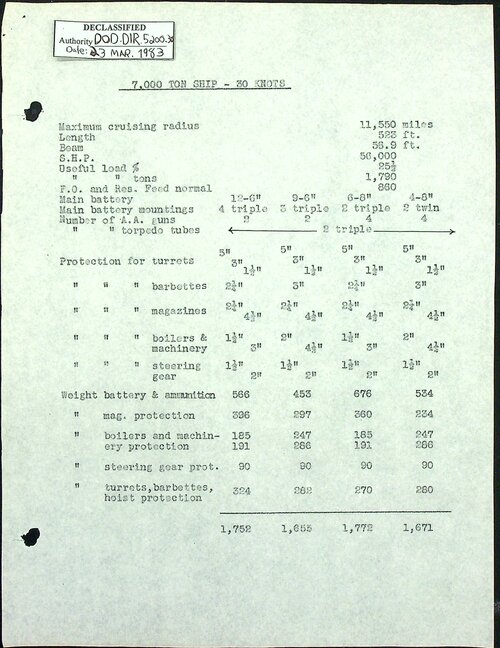

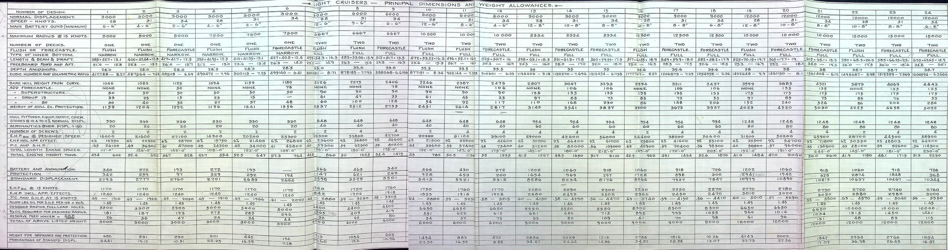

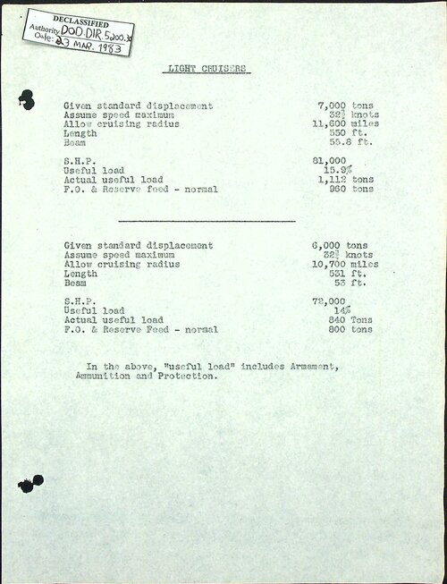

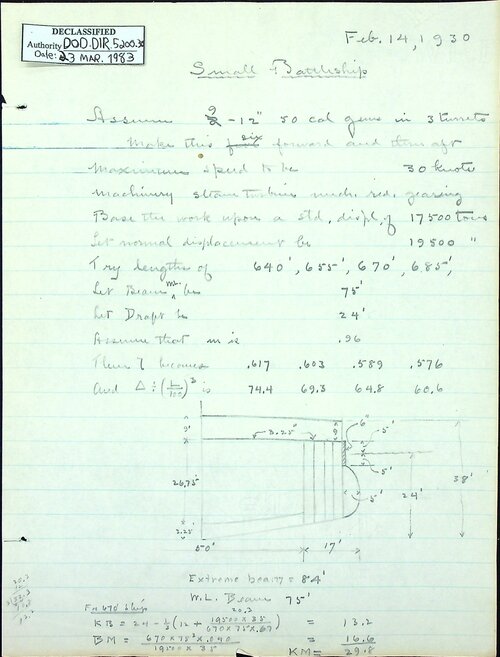

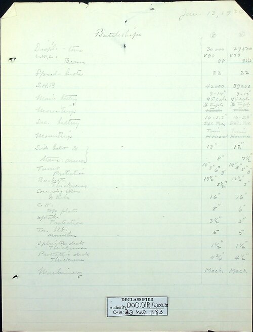

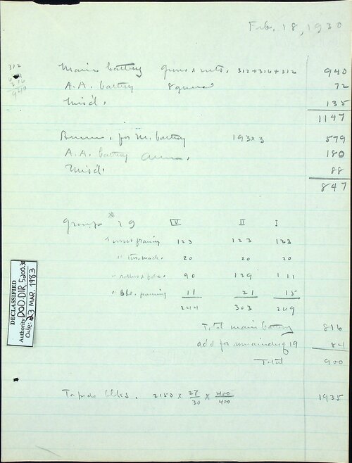

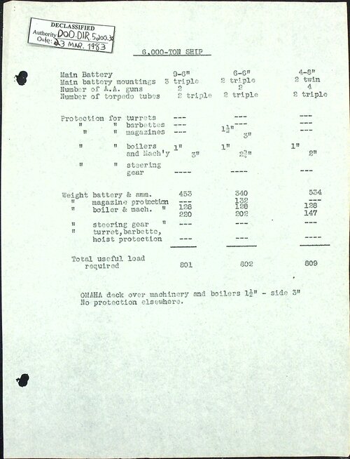

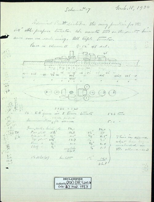

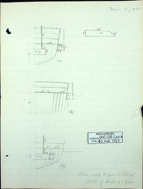

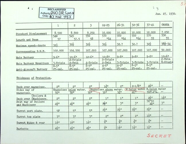

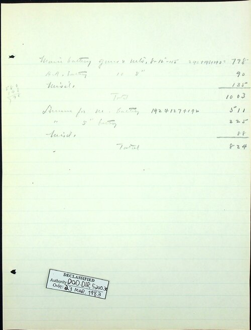

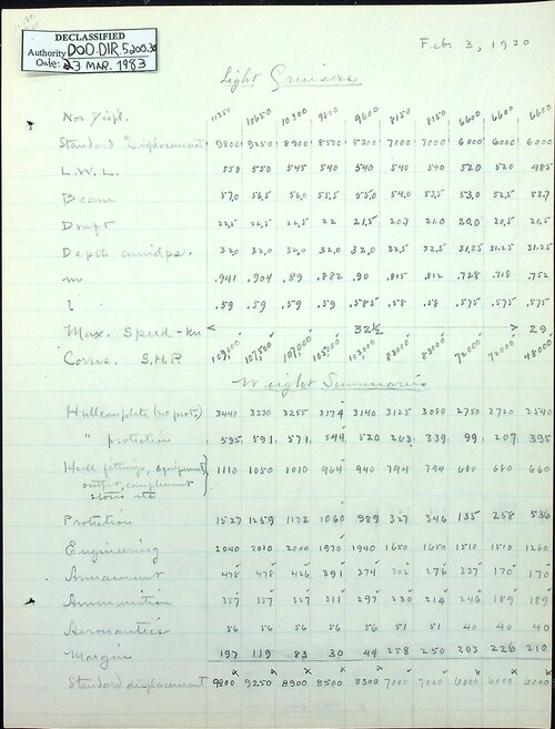

Hello, I have some files from NARA to share. These are a selection of sketches and tables taken mostly during the conference itself in 1930, which were kept in a miscellaneous folder at NARA. There were also battleship and aircraft carrier sketches mixed in the "light cruiser" papers which I will be sorting out.
Here is the light cruiser information.
