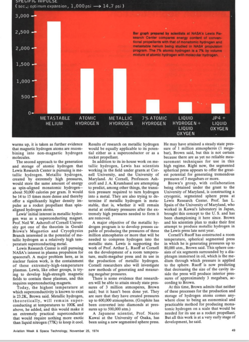

yah, the USAF manage to store Monatomic hydrogen pebbles in liquid Helium
but no one manage to build a rocket engine on that concept.!
more interesting is that Metallic Hydrogen they created and Store it Lyman Laboratory of Physics at Harvard University.
If they manage to keep it Metastable, means it remind a Metal at room temperature at one atmosphere pressure
we got finally a Superconductor, Superexplosive and Super Rocket propellant with 216 Mega Joules/kg
some engineers believe Metallic Hydrogen could be used as construction material, 7 time stronger as Steel with density similar of water
back to Super Rocket propellant
Metallic Hydrogen would have specific impulse of 1700 sec (Lox/Hydrogen chemical 480 sec, Hydrogen nuclear heated 800 sec)
