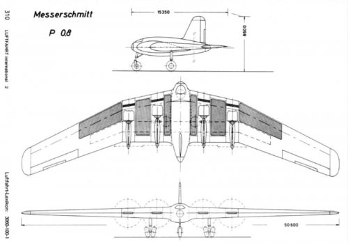

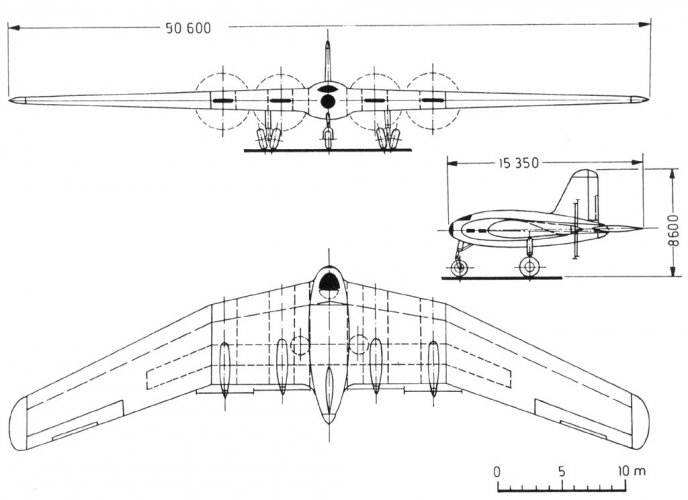

The Messerschmitt P.08 project for a tailless aircraft is featured on quite a lot of sites, like
Luft'46 and so on, but it's nearly almost described as long range/heavy bomber. Reading the
projects description in Luftfahrt International, it actually was intended as a multi role aircraft:
1. Bomber with a bombload of 20.000 kg (to 50.000 kg over shorter distances),delivery up to a dive angle of 90° !
2. Naval combat aircraft. armed with guided bombs and/or torpedoes
3. Long Range recce aircraft with a range of 27.000 km

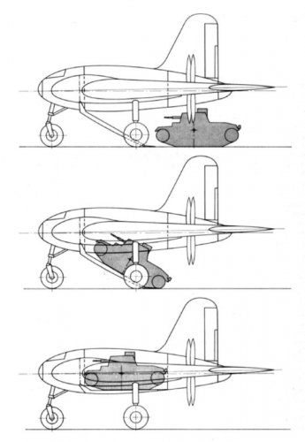

4. Transport with the capability of carrying 22 t tanks
5. Glider tug
and (most surprising to me)
6. Nightfighter with an armament of four 88 mm AA guns !
A stated advantage of this design was the possibilty to change the "Bombenchassis" (bomb module ?),
a kind of containerised bomb bay, so a quick adaption to another role should have been possible.
The articles in that publication were mostly based on original documents and this one is said to be the
slightly shortened form of the original description by the Messerschmitt AG from 1st of September 1941.
Nevertheless, the very idea of an aircraft with a MTOW of 90.000 kg attacking in a vertical dive, or by
firing four "8-8 Flak" (88 mm AA gun) makes me think, that the Messerschmitt designers and maybe Willy
Messerschmitt himself, had no false modesty !

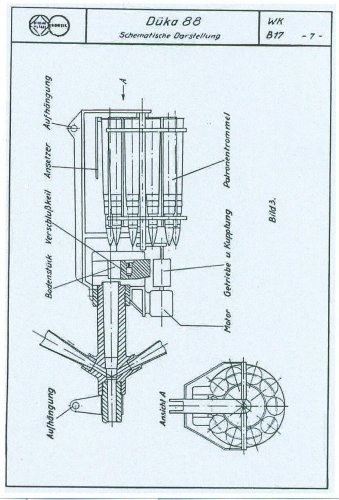

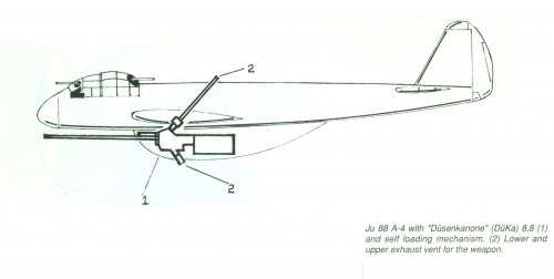

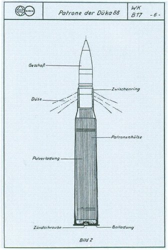

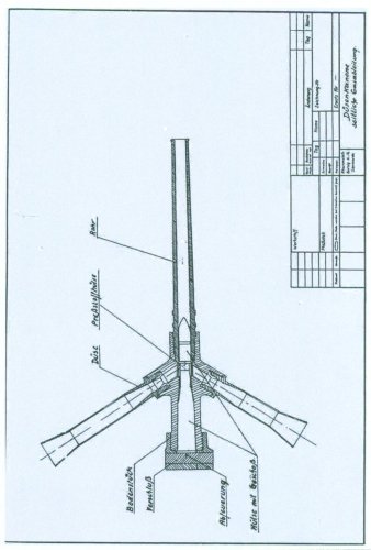

Do you know how the 88's would be mounted?
Allied night bombers were maneuverable enough that a flexible mounting would've been exceptionally important.
The 88mm gun was several metres in length, putting that in a flexible mounting would have interesting consequences for aircraft trim when the gun was tracking its target. Then there is the matter of recoil of such a big gun - troublesome enough when firing in the line of flight. Most kills by night fighters were made with fixed guns, either firing straight ahead or obliquely upwards.
On the other hand, once you are crazy enough to propose mounting four whacking big 88s, why not go the whole hog and put them in flexible mountings?
Exactly - once someone has proposed a 90 ton flying wing dive bomber - all bets are off.

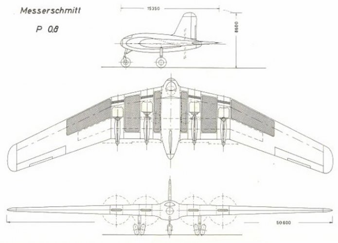

Düka 88 here
Had another look at the tables, empty weight was just 30.000 kg, but fuel weight was up to 40.0000 kg
and payload 20.000 kg. So, using full combat radius it would have just attacked with a weight of around
70.000 kg ...
About the 88 mm gun, perhaps we should remember, that the Ju 88P and even the much smaller HS 129
were fitted with a 75 mm gun. I would think, that the four guns in the P.08 would have been fixed for forward
firing. Maybe multiple guns were just chosen to increase rate of fire ?

You don't understand the real purpose of the 4*88mm guns.
The four guns were to be used as dive brakes. Their recoil should get the bomber out of its dive pretty efficiently. ;D
