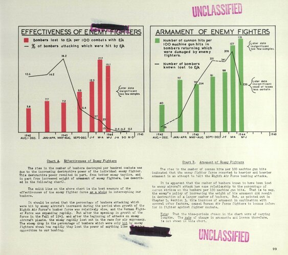

Well, here's a graph from the US Strategic Bombing Survey. US bombers saw very little opposition from fighters after April 1944, and as the oil campaign basically only started in May 1944 and didn't have immediate results, that has to be seen as the success of the USAAF's long-range escorts that stopped the majority of the Luftwaffe fighters from attacking the bombers.

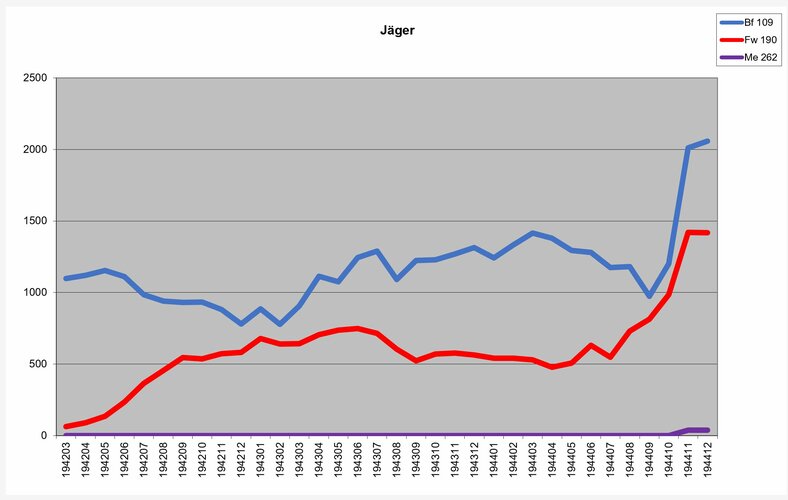

Here's a graph showing the available fighter strength, based on the Flugzeugbestand und Bewegungsmeldungen at https://www.ww2.dk/oob/bestand/flugbew.htm ... some more Me 109's were serving with reconnaissance units, and some more Fw 190's with ground attack units, and with the total number of fighters being fairly constant for 2nd half of 1943/1st half of 1944 and going up in late 1944, the Luftwaffe's lack of effectiveness against bombers obviously was not a problem of insufficient piston engine fighter production.
Another interesting appendix in Dan's Me 262 book is the reproduction of A.D.I.(K) Report No. 323/1945, which was based on interviews with captured Me 262 pilots (including, amongst others, Barkhorn, Bär and Dahl). It states:
"The use of the Me 262 as an attack fighter against Allied bombers was dictated by the impossibility of using other German fighters for this purpose and by the necessaity of doing something to stop or hinder the Allied raids, but German pilots regard the ideal role of the Me 262 to be that of a pure fighter, finding and destroying Allied fighters and fighter-bombers. [...]
Engagements with Allied fighters were undertaken by Me 262 formations only on rare occassions, when combat with bomber formations was not possible, but German unit leaders regarded the correct function of the Me 262 to be attacking the Allied fighter escort with a view to leaving Allied bombers an easy prey for ordinary German units. But Me 262 were only ready for combat when fuel was so short that all German fighters were ordered by the High Command to concentrate on bombers."
In short, the Me 262 could do what the Me 109 and Fw 190 couldn't, and even more importantly, it had the potential capability to create a situation in which the available Me 109 and Fw 190 fighters could have been used effectively again.
However, it's pretty clear that to exploit that capability, it would have needed to be available in numbers in mid-1944 the latest, before the oil campaign began to have its paralysing effects on the Luftwaffe.
