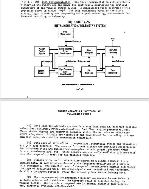

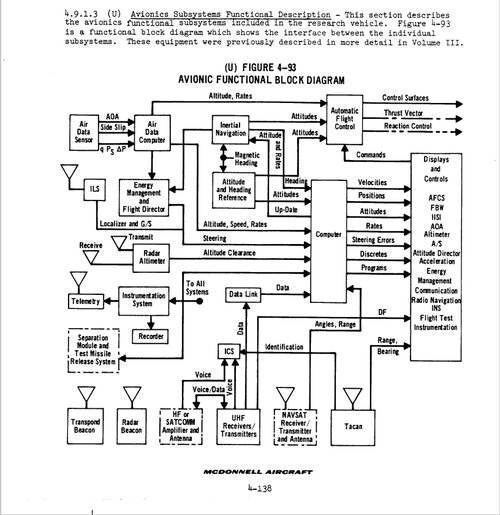

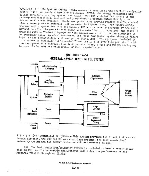

An earlier thread discussed the McD Mach 6 and Mach 12 vehicles from the 1970s that Dr. Paul Czysz worked on. Here are the avionics, GNC, and instrumentation diagrams for the vehicles. The paper states that the avionics systems for both vehicles would be inherently the same. I would like to point out that this is public information in the public domain, and can be found on NTRS (a public repository) on this public paper. The title of the paper is "Hypersonic Research Facilities Study, Volume IV Part 1 Phase III Final Studies, Flight Research Facilities", downgraded to UNCLAS from CONF 12/31/1976, almost a half-century ago. Keep in mind this is a system design older than that of the Space Shuttle.
