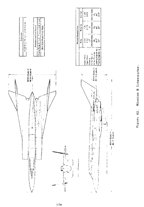

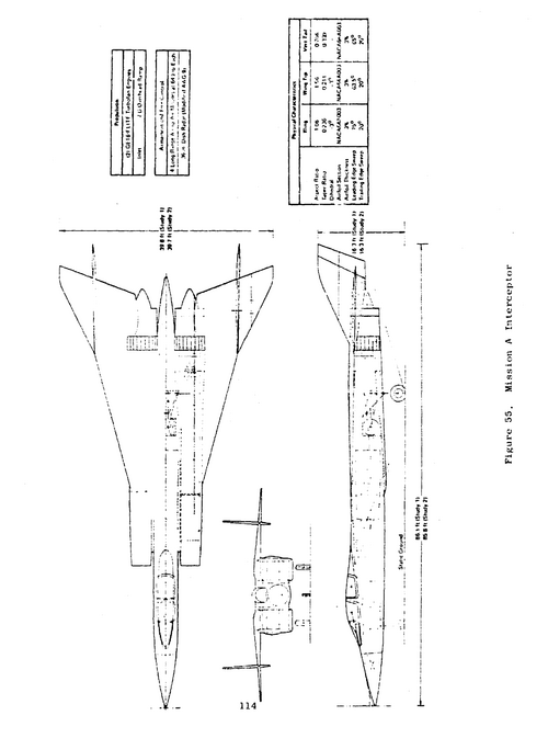

Skybolt said:
Yep, Paul, but looking at the 3-view, either the painter had sight problems or the author is wrong .. ::)
3-view? What 3-view?
There's a 3 view of McDonnell-Douglas' VFX submission - its the one with the canards and VG wings.
I think this is a different project entirely.
I would agree.
I don't even think that the drawings in question depict a TF-30 or F401 powered project, but something built around an even larger diameter turbofan of some sort?
Of course, the proportions might just be off.
If you scale down a TFX by 50 % (actually less, I'd say 30 per cent) probably everything will look larger .. ;D
And I think that 1974 is the date of publication/release... the VAX was from 1963.
I think artist wasnt' an idiot - just look at the glowing nozzle of the thing. Turboramjet?
