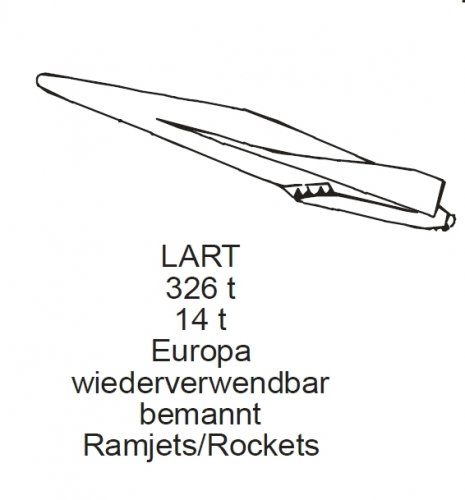

Re: MBB LART
The 'core diameter' given in the Astronautix site is really the wing span. Attached is a (unfortunately fairly crude) picture of an early configuration.
Martin
