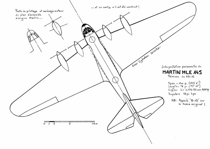

The push-pull bomber was proposed "in fine" powered by in line water cooled engines Allison.
I give you here my top view of the Martin mle 145, predecessor of mle 164 ... and premices of the first XB-16
How does this "classic" config relate to the 6-engine twin boom one often seen ?
Predecessor? Successor? Re-use of the model number?
The answer is simple enough: the "145" slot was allocated to the XB-16 program. Three successive (and very different) proposals emerged, designated Model 145, Model 145-A and Model 145-B.
