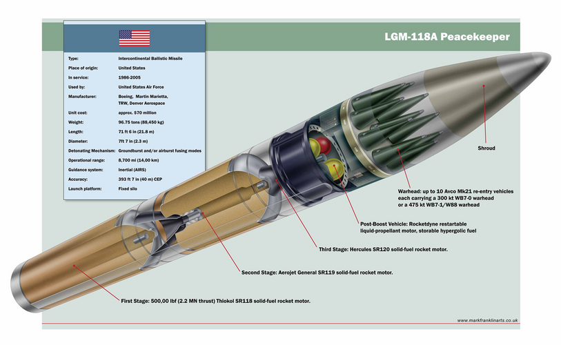

The Opfires FSRM (full size rocket motor?) dimensions but also the MX 2nd stage at 66” diameter. Was this a pre-Peacekeeper ICBM option under the whole “Missile Experimental” program?
The diameter seems wrong, 66 inches is well under the 92 inch (2.34m) overall diameter and only marginally bigger than the MMIII 3rd stage which is 1.3m overall (rocket motor stated at 52 inches, which is roughly the same). In fact 66 inches sounds more like MMIII 1st stage.
Astronautix also disagrees:
Aerojet solid rocket engine. Peacekeeper second stage.
AKA: Peacekeeper-2. Status: Retired 2005. Thrust: 1,365.00 kN (306,864 lbf). Gross mass: 27,800 kg (61,200 lb). Unfuelled mass: 2,900 kg (6,300 lb). Burn time: 54 s. Height: 5.40 m (17.70 ft). Diameter: 2.35 m (7.70 ft).
More here:
66 inches could be the nozzle base diameter:
More here:
