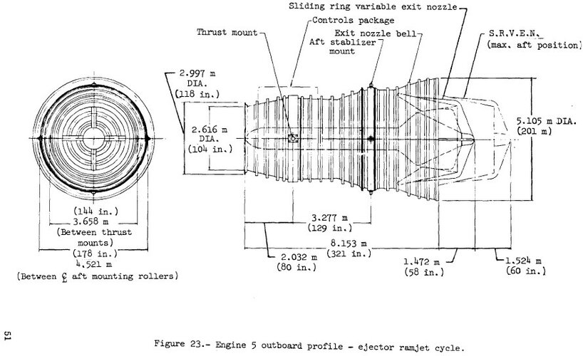

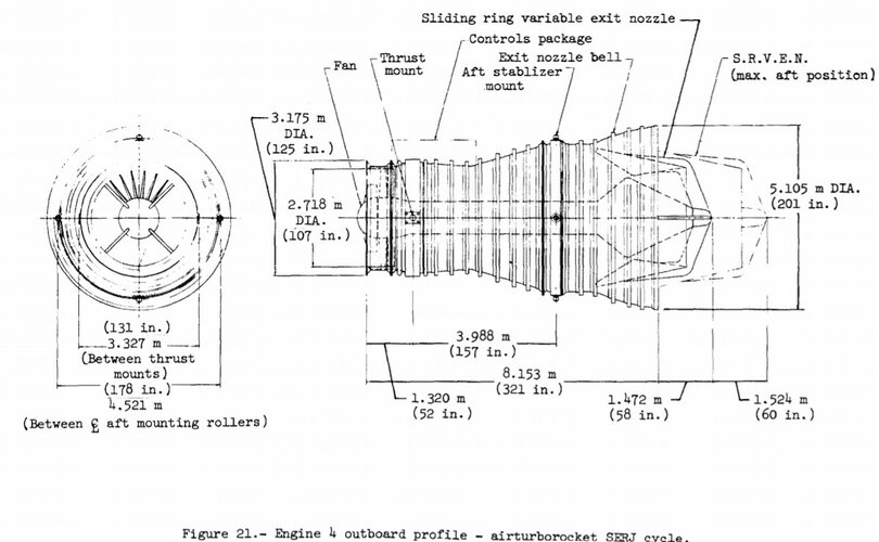

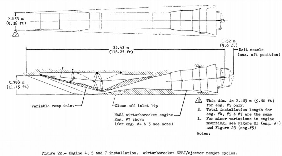

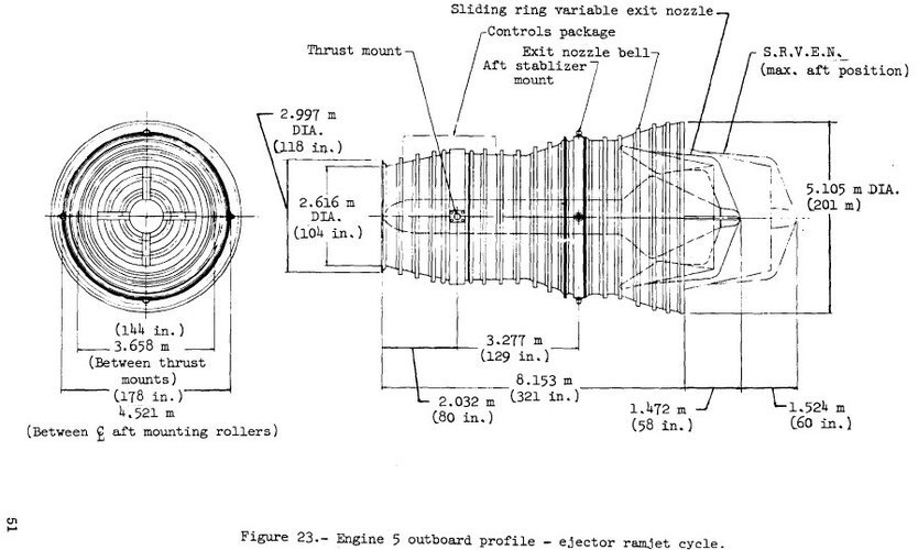

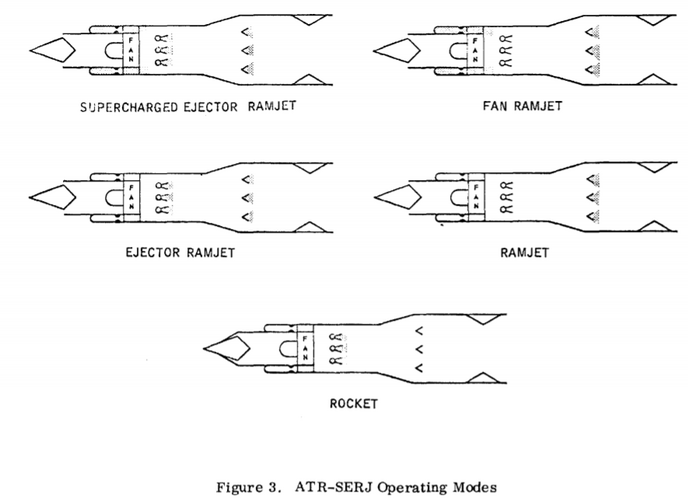

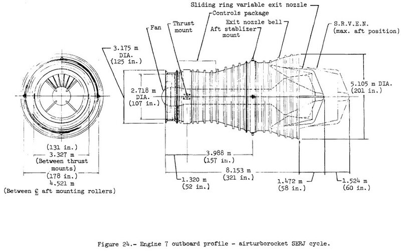

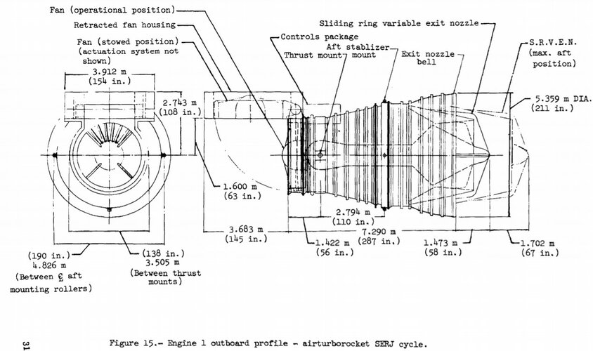

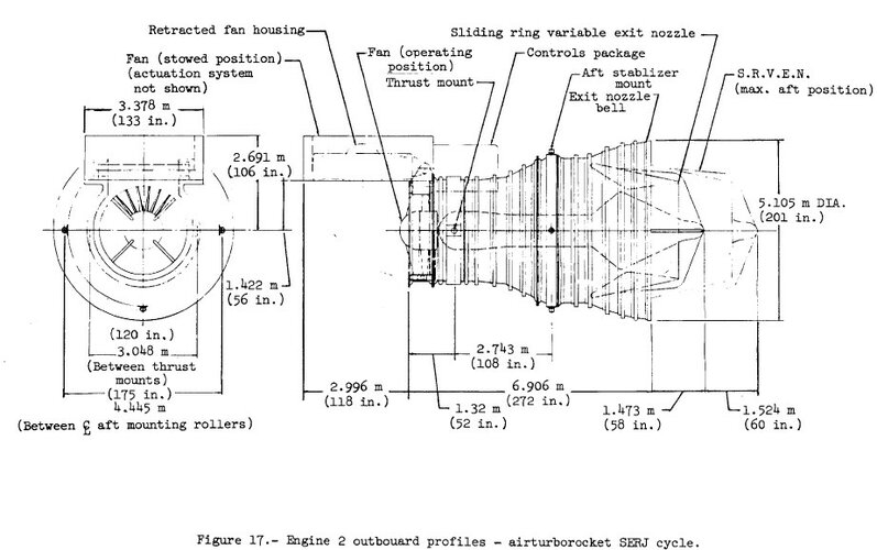

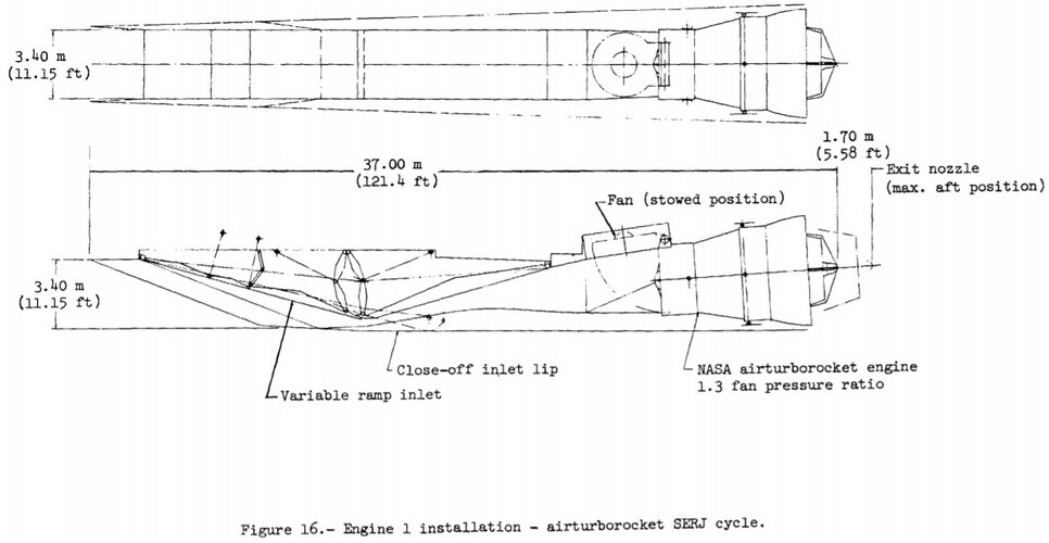

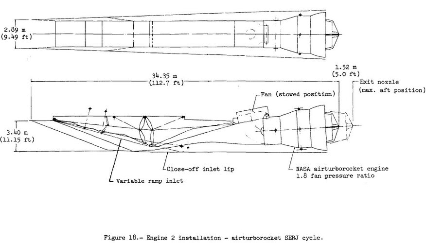

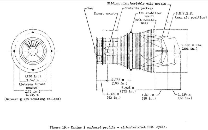

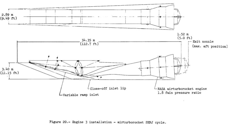

Composite engines for application to a single-stage-to-orbit vehicle (these are SERJ): https://ntrs.nasa.gov/api/citations/19760006115/downloads/19760006115.pdf
Has supposedly 7 different engine configurations and how they are positioned respective to a 2D inlet, I only found 1, 2, 3, 4, 5, and 7. All use LH2 except 6 and 7, which use JP-4 (and have less ISP). The different engine configurations come with tradeoffs between ISP and TWR among other factors: for example, Engine 4 has 70-86% increased thrust over engine 3 (percentage depending on whether you count the inlet or not), but 56 seconds less ISP.

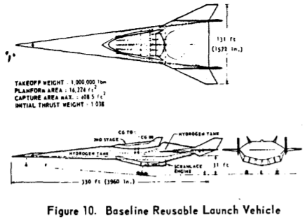

PDF also includes COMPOSITE PROPULSION SYSTEMS FOR AN ADVANCED REUSABLE LAUNCH VEHICLE APPLICATION by the same author, which uses these engines for an airbreather TSTO.

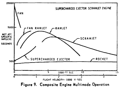

Agreed, out of most of the engines I've seen so far, SERJ is one of the better concepts. I'm somewhat critical of the ejector feature however: it provides an increase in thrust but you could just do that in fan mode by switching on the ramjet, then the ramjet should suffice till a possible scramjet stage (you go back to the "normal way", lose all the magic that makes the SERJ unique, but gain ISP). I'm not sure the additional ejector thrust justifies additional complexity of the engine, unless of course it's a huge craft hat needs a lot of thrust.
