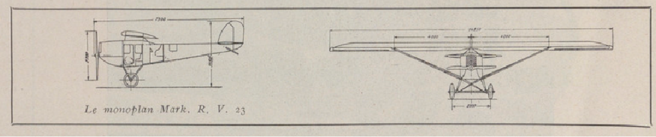

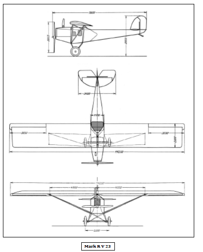

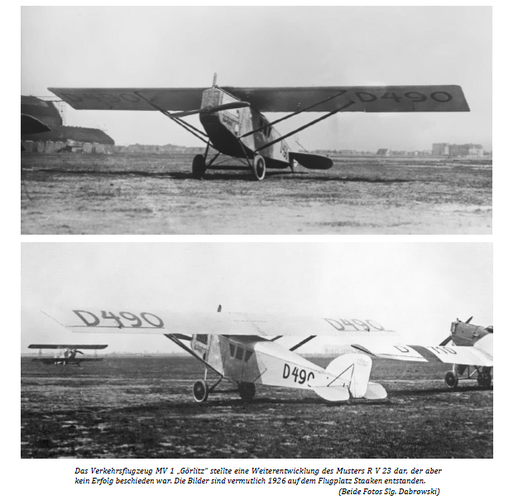

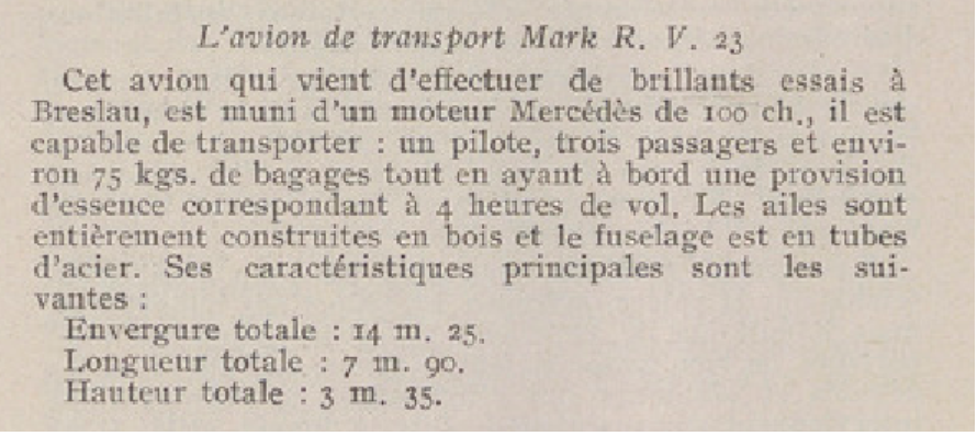

R Va and R Va/23: four seater cabin plane with 100 – 150 hp Daimler or Benz. Two built.

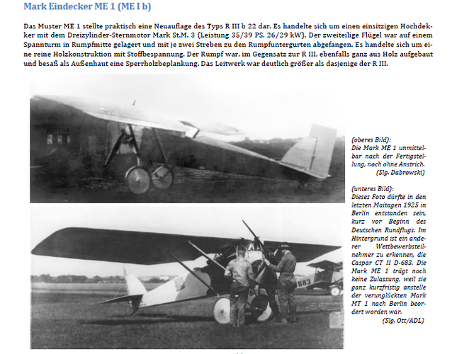

ME I and ME Ib: sport plane with Mark St. M3, developed from R IIIa.

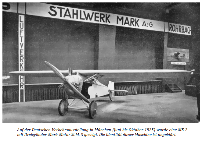

ME II: sport plane with Mark St. M3.

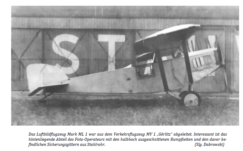

ML I: two seater high wing sport plane with pre-war Mercedes.

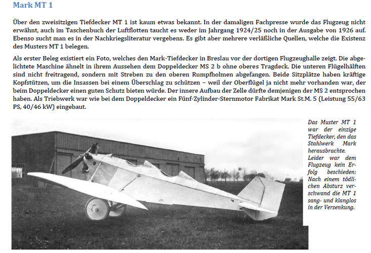

And there is another one, the type W.
With reference to http://www.histaviation.com/Stahlwerk_Mark_W_I.html it is not found in any source, only Luftfahrzeugrolle knows it (D-593). Possibly a wrong designation. The photograph seems to me rather R V like, but I’m not an expert in the matter.

E.I was a single seat monoplane fighter – the ME I? (not a fighter but a sport plane), eventual WWI monoplane fighters from Märkische Flugzeug-Werft unknown.
E.II was a single seat monoplane fighter – the ME II? (not a fighter but a sport plane)
T-1 was a torpedo seaplane – since Stahlwerk Mark didn’t built a seaplane and neither military aircraft, this should be the MT I sport plane (??)

From L'Air 1924.
