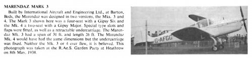

Anyone know about a British pre-war company called Marendaz (actually International Aircraft and Engineering)? I must admit this aircraft, the Marendaz Mark 3, comes as a complete discovery to me:

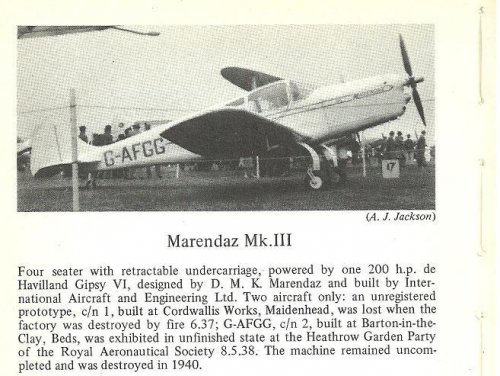

and here is the Marendaz MK.III and Trainer aircraft,they are actually built ,
but never put on production line.

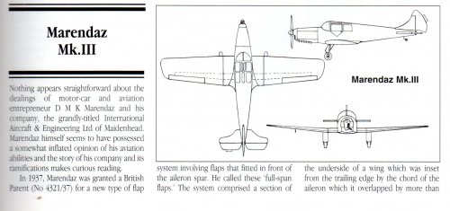

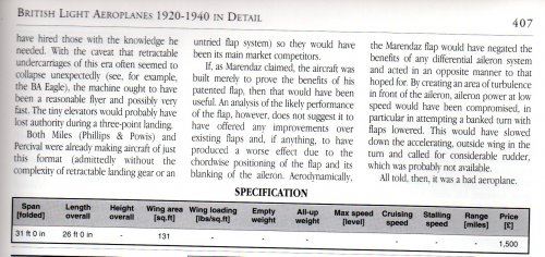

From A.W.J.G.Ord-Hume's magnificent 'British Light Aeroplanes'. This is the entry concerning the Marendaz Mk. III. I'll also post the entries concerning the Marendaz Trainer and the abortive Marendaz Monoplane.

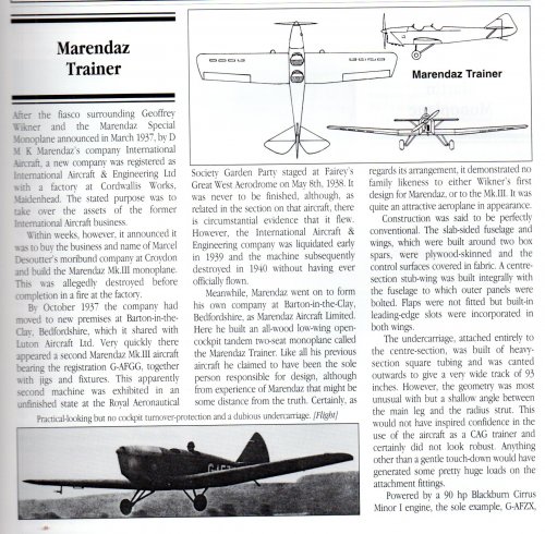

..........and, as promised, the Marendaz Trainer.

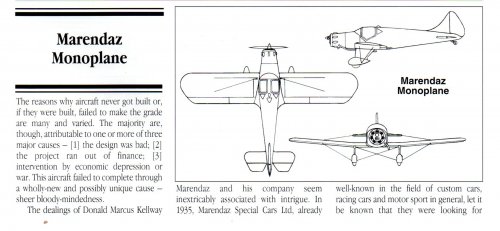

...........and finally, the abortive Marendaz Monoplane. I wonder whether the amount of Marendaz data on this general thread warrants the opening of a separate, specific Marendaz thread and for the data to be transferred from this to that?

Hi Avion,
this aircraft is different from MK.III,and that means; it was the first aircraft designed
by this company,am I right ?.
Yes, I believe that you are, Hesham. Ord-Hume explains why it was never finished and never flew (note to moderators - doesn't this fact warrant the material concerning the Marendaz Monoplane being transferred back to Early Aircraft Projects?) and mentions that parts of it were employed in the construction of the Marendaz Mk. III.
