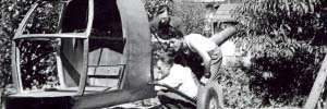

Can anyone tell me anything about the French Marais 01? I'm assuming, but don't know for certain, that it dates from the postwar period. What there is of it nowadays is, apparently, stored by the GPPA in the museum reserves at Angers-Marcé. On the museum website there is a tiny photograph of it (q.v. http://www.musee-aviation-angers.fr/?page_id=673) that shows a 'helicopter type' forward cabin, aft of which appears to be a single boom rear fuselage, and possibly tricycle undercarriage. I can find no other reference to it on the web, no mention of it in the TU index and nothing about it in any of the books which I have.
My dear Avion,
there was a designer called Marais in TU magazine,but I think it was not him,and I search about this
helicopter.
Thank you, Hesham. Anyone else know anything about this obscure machine?

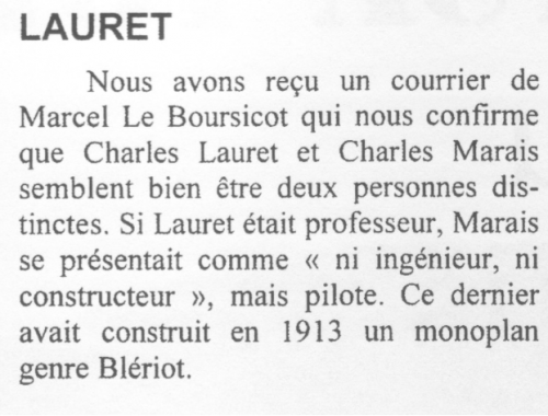

Whilst, yet again, it looks nothing like the Marais 01, I've come across another aeronautical reference to a Marais - this time a M Marais-Lauret (aka M Charles Lauret) who, in 1939, produced a little two seater monoplane called the 'Ailette' (which, presumably, disappeared into oblivion in the forthcoming conflict). It is mentioned briefly in L'Aérophile of June 1939 (q.v. http://gallica.bnf.fr/ark:/12148/bpt6k6555170b/f29.image.r=marais-lauret%20ailette?rk=21459;2) as the Marais-Lauret 'Ailette' and more extensively in Les Ailes, but therein no mention is made of Marais and it is described consistently as the Lauret 'Ailette', designed and built by Charles Lauret. Whether there is any connection between this and the Marais 01, I do not know. But I thought it worthwhile making mention of it - just in case!
Nice find my dear Avion.
and maybe it was the same guy ?.
