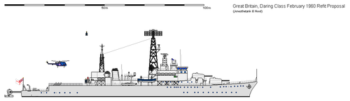

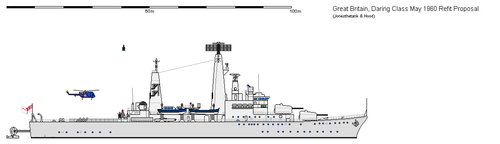

The RN did look at modernising them up until 1960 when they decided not to. Friedman has a couple of the proposals for them as fast Leanders. These retained both 4.5” forward, rebuilt super structures and masts, helicopter platform aft for Wasp, Limbo AS mortar, Seacat and VDS on the stern.
Ultimately the cost of the refit of a Daring was seen to be at least as much, if not more than a new Type 12 frigate with the manpower costs annually much greater.

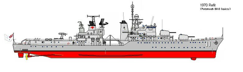

Someone was kind enough to post me this Shipbucket profile on another forum.
I'd love to see the "RAN Ikara installation was designed to replace a single Limbo and its magazine..." you denote Volkodav!
Regards
Regards
Pioneer
That's a nice looking design but I'm not sure how practical it was. The Mark 13 launcher weighed 85 tons loaded, the 4.5 inch twin turret weighed 45 - that's a pretty big difference. Since we're being hypothetical, I wonder about an alternate launcher that only included the outer ring of 24 missiles rather then the inner ring of 16 as in the Mk 22. It would be a bit lighter and you could field, say, 20 Standards and 4 Harpoons for a worthwhile load-out.
That's an interesting and valid point Kanga.
Given the time frame and the threat, I'm thinking 16-round Tatar (or even better 24-round) launch wouldn't be anything to scoff at!
Regards
Pioneer
