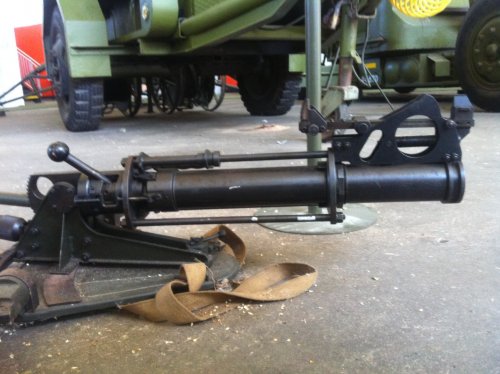

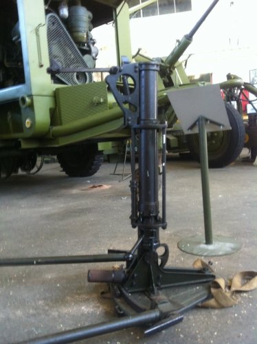

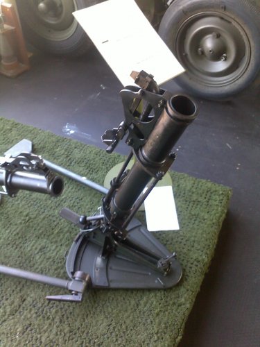

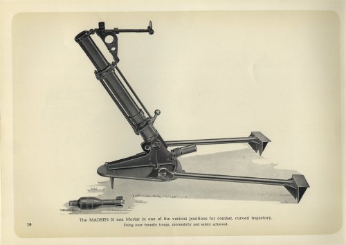

I stumbled across this one at a local museum yesterday.
While it doesn't say so anywhere, I suspect it's a pre-war design despite the fact that they didn't market it until the early fifties.

It didn't, prototypes only.
Unfortunately for the producer it weighed as much as the larger and longer ranged 60mm mortar the US was handing around like candy, and by the late forties a 51mm projectile simply doesn't carry enough of a punch to effectively disable a tank.
My guess is it was designed around 1939-40, since the soldiers in the brochure are wearing pre-war uniforms.
Plus, it would actually have a decent chance of knocking out Pz Is and IIs, maybe even III's.
Interesting. One online source claims that 1,000 M.1947 mortars were built (speculating that sales were to South American nations). Another claims to show an ex-Indonesian (TNI-AU) Madsen mortar.

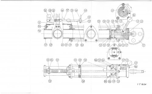

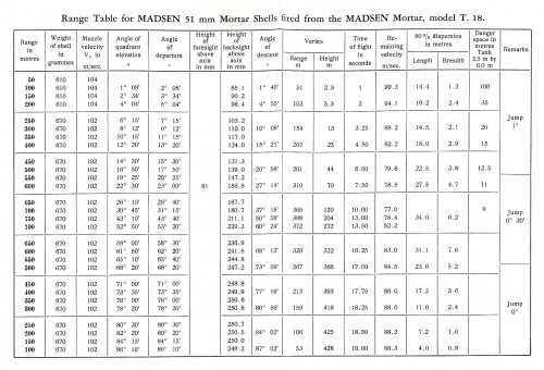

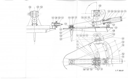

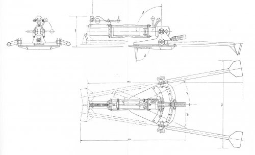

Eureka! That book I mentioned earlier just arrived.
I haven't had time to read through it yet, but a quick skimming revealed a complete set of detailed drawings and a range table.

Excellent Madsen drawings Thiel. But yet another designation :eek:
M.1947 is a generic (or unofficial) designation for year of appearance and T.18 is the actual company model number? If so, what's the 'T' for? ???
Thanks too for the OT clarification of '81mm M L/12 M31' -- that 'L/' should've made it obvious but the modern Danish use of slashes in designations confused me. So it is: Bore diameter (81 mm), Type Designator (M for 'Mortér'), Barrel Length in Calibres (L/12 for 972 mm tube), Year of adoption and/or construction (M31 for 1931).

The book doesn't say so, but I'm fairly certain Type T.18 is the company designation. Furthermore it reveals that the mounting is called the Type F. 159.
Yes, your attached sheets do seem to confirm company designations of T.18 and F.159.

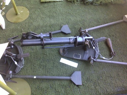

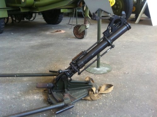

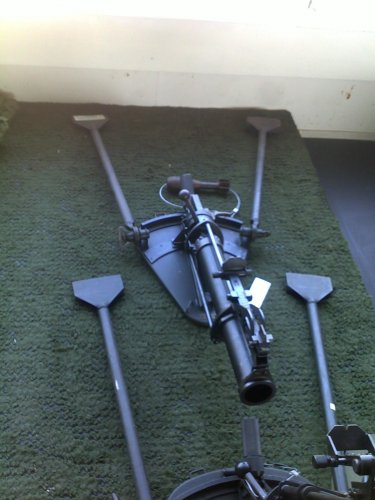

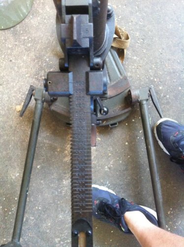

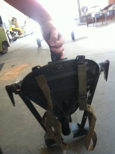

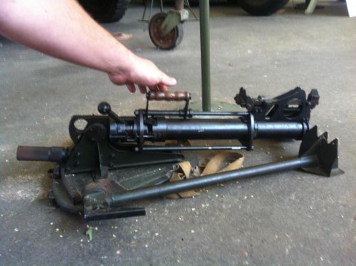

I visited Aalborg Garnisions Museum again today and they've gotten a third 51mm mortar and you're allowed to fiddle with it!
Pictures:
1: Stowed for transport
2: Direct fire, range 100m
3: Indirect fire, range 100m
4: Maximum range 900m
5: Carrying straps. Once folded the entire thing could be carried like a backpack. Can't have been very comfortable without any padding.
6: Sight.
7: Range ladder. Note how it goes from 0m to 900m and then back down to 100m
8: Sight picture
I also recorded two short clips of the reload mechanism.
Clip 1
Clip 2
I'm sorry about the quality, I forgot to bring my camera so all I had was my phone. Unfortunately the system won't let me upload the pictures in full resolution, but they are available at request.

Nice photos only problem is some of them up side down.
Useful when firing at lower angles wasn't possible, because of obstructions. Could you
associate ranges with the angles ?
Jemiba said:
I posted a range table earlier that have launch angles at various ranges if that's what you mean.
Well, yes, somehow. The intermediate steps probably could be calculated by interpolating. Was a bit puzzled, that maximum
range from the range ladder isn't mentioned in the table, but maybe there's too much deviation at the limit of range performance,
so the table gives the recommended range only ?
You could calculate them but the sights makes it unnessesary. You set the sights to the range you want and then turn the elevation screw until the sight is horizontal. It has a level built in for that.
Thanks for the explanations, the best way to understand such a thing is always to fiddle
around with it by oneself, I think.
BTW, have to beg your pardon, I've rotated some of your pictures, but had forgotten to copy the
video links and such imbedded videos get lost during modifying a post. :-\
Could you attach them again, please ?

acorning said:
Looks like a design that missed the point, much more clutter than the UK 2-in (51mm) mortar of the same period, and this mortar was stripped down in later marks. The UK 1980s 51mm mor was also clutter free.
Not sure I agree. While it's true the British weapon was as streamlined as they could make it, it's worth noting that it was primarily a glorified smoke projector and its ability to perform precise bombardments were pretty limited because they'd cut away so much of the clutter that made that possible.
The Madsen weapon on the other hand is optimised in part for HE delivery and antitank work, hence the far more substantial baseplate and all the other clutter. All that extra clutter also gave it almost twice the effective range.
Now, whether such an AT weapon made sense is debateable, though te fact that noone seems to have adopted it would suggests that the armies at the time didn't think so, but it didn't carry all that extra weight around for the fun of it or because the designers had missed the point.
They designed a weapon to an entirely different specification and unsurprisingly came up with a very different weapon.
