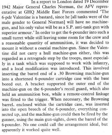

I seem to recall a WW2 tank which lacked a coaxial or hull mounted machine gun having a machine gun adapted to fit inside a modified tank shell. Then the modified shell with machine was mounted inside the main gun and fired by a solnoid. I can't recall anything else ot what tank had this feature. Any ideas anyone?

If the information was reliable, it was apparently the Valentine IX tank, which lost space for the coaxial machine gun after a 6 pdr. cannon had been installed.
A BESA machine gun with 57 mm cartridge-like casing was developed to fit into the cannon chamber - sadly I have no idea if this device went into production or remained a prototype only.
From David Fletcher's The Universal Tank - British Armor in the Second World War Part 2:

Bravo Grzesio and CostasTT!!
That was really beginning to bug me.
