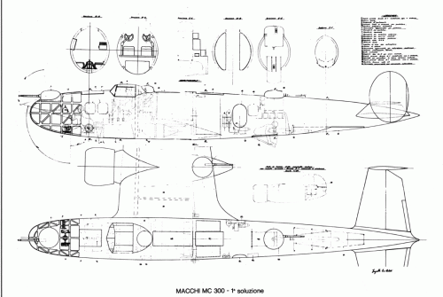

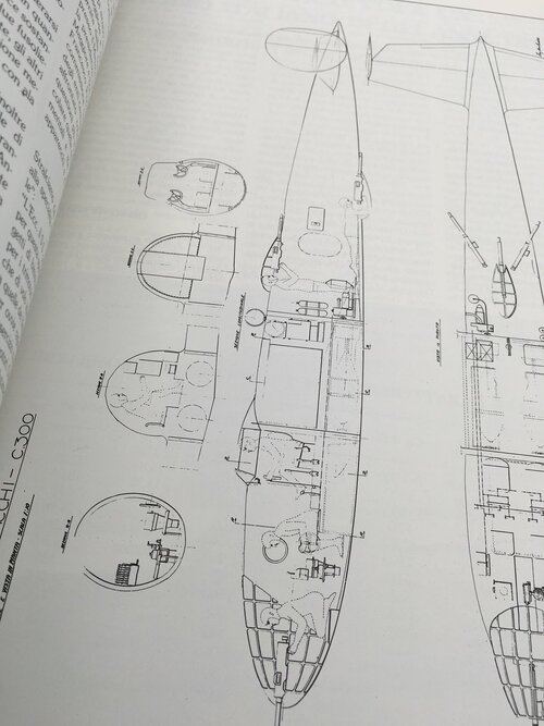

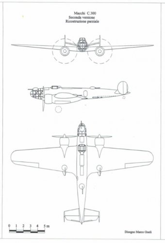

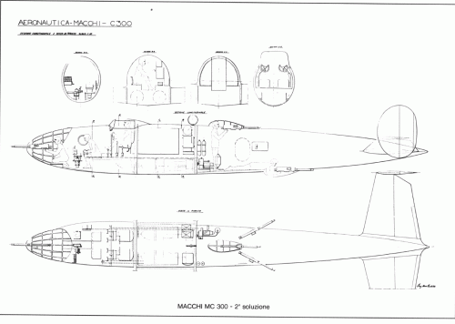

Ok, shame on me. I've been sitting on this info for a long while... it's true my archive is in a pityful shape, the more since I digged unmercily it to extract info for ISP, but this is really, well...
Behold the MC-300. It did exists, and it was... a bomber. Subitted by Macchi to the Bombardiere Normale competition of 1938, not accepted in the first round (Prima Soluzione) and accepted but never ordered in the second round (Seconda Soluzione). Relevant data: lenght 14.00 mts, span 22.00 mts, height 4.58 mts, wing surface 55.00 sqmts, empty weight 6,150 kgs, MTOW 9,900 kgs, max speed 502.00 km/h at 5,000 mts, range 2,000 km, weapon load 980 kgs, 5 machine guns (see illustrations for disposition), 2 Alfa Romeo 135 with a nominal power of 1,350 HPs. And so this puts to rest a supposed "mistery", now, on, the next one....
