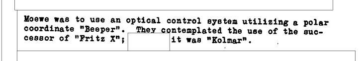

What kind of guidance it was supposed to use? The ubiquitous Kehl-Straßburg MCLOS?
It had flares (red and green) on the wingtips of the second stage, so probably it was to be optically tracked and manually command-guided.

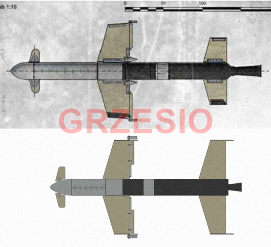

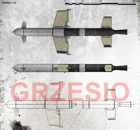

So above we can see the Moeve, and here is the Nussknacker.
Similarity is striking but Nussknacker seems to be some 70 cm longer, heavier than the Moeve (215 kg vs 150 kg), with similar booster stage (4230 vs 4000 kg*s total impulse) and nearly twice as big sustainer (2300 vs 1200 kg*s). Diameter of 21 cm and wingspan of 129/130 cm are just the same.

Quick comparison of both missiles - Nussknacker above, Moeve below.
I just wonder if this Unterluess report, created after the war for the Allies, shows the actual Moeve, or just a mixture of the Nussknacker layout combined with the Moeve data. The Moeve just does not look right for me - for example its booster is much bigger than in the Nussknacker, while they should be rougly of the same size (or even the Nussknacker's being slightly bigger).

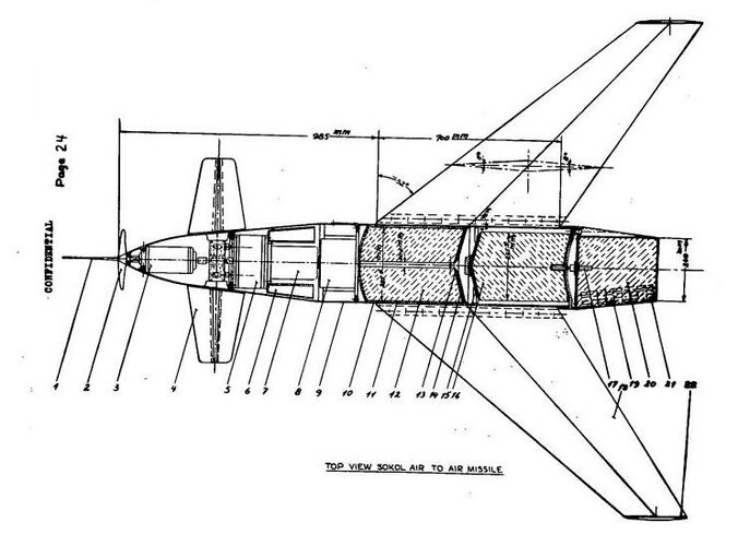

According to CIA reports of 1954, just after the end of hostilities, the Soviets took possession of the documents of Rheinmetall missiles like the Falke-Moeve and developed with the group of German scientists the Sokol an improvement of the moeve.
I can think of few less effective ways to knock an enemy pane from the skies than someone on a moving vehicle tracking a missile with their eyeballs and twitching a joystick.

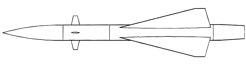

As far as I know, no such missile existed. The first attempt to develope air-to-air missile in USSR was SNARS-250 (rus. Samo-Navodachiisya Aviatsionny Raketny Snaryad - Self-Homing Aircraft Rocket Projectile), started in 1948:
But it have zero similarities with German missile; SNARS-250 was supposed to be supersonic infrared/semi-active radar homing weapon.
