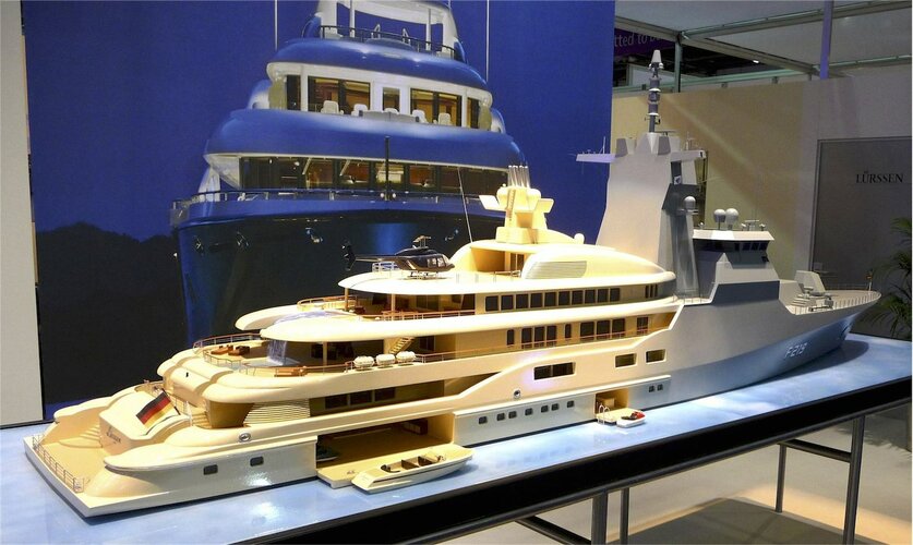

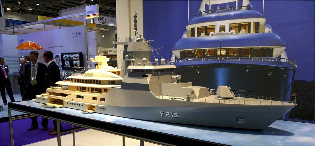

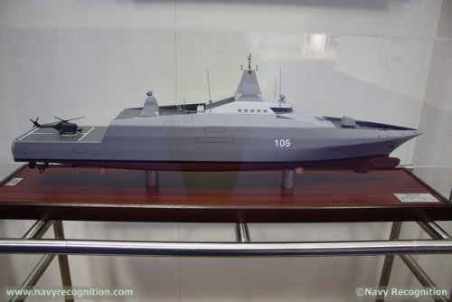

Model of Lürssen Multi Role Light Frigate

Interesting that the concept pic shows somewhat deep azipods but the model shows conventional propulsion.

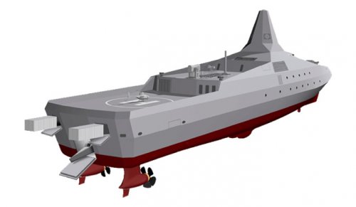

I think that the last image in the first post - bild_10.jpg (and also perhaps bild_06/07 - is actually of a slightly different, older concept for a littoral combat ship. It uses pods for cruise and submerged advanced waterjets just aft of midships for high speeds. If you look closely there are some other differences in the superstructure.
I suspect that the current design is an update of the older one, which was produced to similar requirements as the LCS - i.e. high speed.

Is there a particular advantage to midship placement of submerged waterjets here, such as cleaner flow for the waterjet intake?

Well, there are several issues that may have played a part:
• Ensuring an undisturbed flow
Improving cavitation performance by deeper submergence
Improving survivability by distributing propulsors
Distributing weight (pods and waterjets are both heavy!) and thus avoiding excessive trim / bending moment / strange hull shapes to stop both
Reducing interference with propellers aft
Lack of space in the hull aft
Against this are the problems of docking, drag (but the submerged waterjet has this wherever it is placed), possible debris ingestion and reduced steering effectiveness of the waterjets.

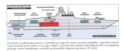

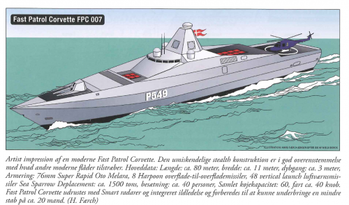

The designs bears a striking resemblance to these 2007 concepts by RDN Commodore Niels Chr. Borck.
Thanks Thiel
I remember seeing that Danish proposal previously. Was there a thread dealing with it on this forum?
C
I don't think so, but I'm honestly not sure.
The abysmal search function is no help either.
That lower picture, is that suggesting some sort of podded submerged waterjet for aft propulsion?
This is what Lurssen mean by a true "multi-role" vessel! ;D
Cat is provided free of charge if you have a scar over your face. :D
But seriously, what is the intended target market for this? Paranoid Russian oligarchs? :eek:
Lurssen made it a few years ago as a PR stunt, to demonstrate their versatility in both the military and commercial markets.
Though the salesman I spoke to about it told me that he'd had one serious expression of interest from the Middle East... ::)

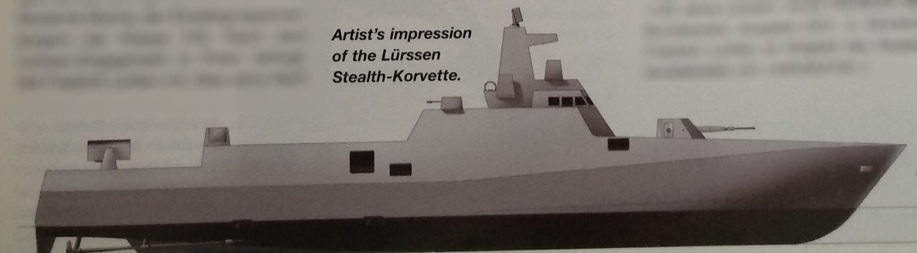

Found this art of a Lürssen stealth corvette. From the context it seems like this or something similar was supposed to be offered for the LCS program, but there are very little details.
I don't think Lürssen was a bidder for the US LCS program. This ship might have worked for the pre-LCS Focused-Mission High-Speed Ship, but would clearly have been too small for LCS proper (no helo deck). A lot of builders dabbled with LCS-alike ideas, on the assumption that the USN might be on to something (they weren't).
The article (from 2003) explicitly mentions Lürssens intention to bid for LCS. But it certainly possible that Lürssen planned a larger variant of the depicted design (similar to the plans by HDW for the Visby-class). The article isnt very clear on that because it only paraphrases an Interview by Friedrich Lürssen with Naval Forces.
Either they decided to bail when they saw the final LCS spec (FMHSS was quite a bit different) or they couldn't find a US partner. There was a lot of that going around -- I think several other European design shops simply could not find a US prime and/or shipyard to even bid.
There was also an unspoken pressure to see multiple alternative hullforms considered -- hence LM's monohull, the GD trimaran, and the Raytheon SES all in the final round (SES was a clear non-starter, TBH)
The Visby derivative (with Northrop Grumman) was dropped because they could not get to a single hull configuration for all of the desired mission parameters.
