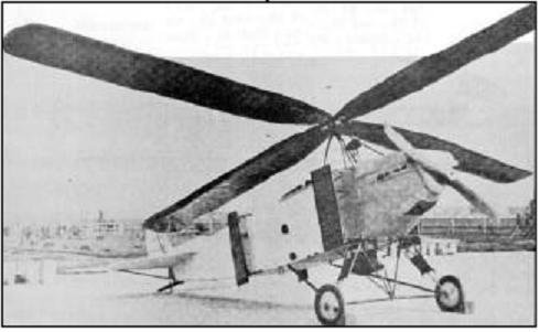

Lucien Chauvière, who will manufacture the famous "integral" propellers
that bear his name,will be interested from 1916 to the principle of the autogyro. A first “gyropter” project was developed in 1917, but did not
will experience no achievement.It was in 1928 that a machine of this
concept was produced.
The spacecraft is in the form of a Fokker fuselage, including the train, equipped with a Hispano-Suiza 8 Scout 280 hp engine driving a two-
bladed propeller. The wing is removed and replaced by a rotor
quadruple with double articulated blades 13.6 m in diameter. This
rotor is driven either by the wind rotary (self-rotating principle) or
by the engine thanks to an extension of the crankshaft at the rear
and a transmission by slip clutch and bevel gears. To compensate
for the torque mechanical when the rotor is driven by the motor,
four vertical side flaps are arranged in pairs on each side of the
fuselage at the front and rear of the rotor attachment area. This
system should, theoretically, allow a “quasi” vertical flight. The total
weight of the machine is 1375 kg.
It seems that tests were carried out in 1929/1930, but they were not conclusive and the gyropter disappeared from the history of rotary
wings.
wings.
