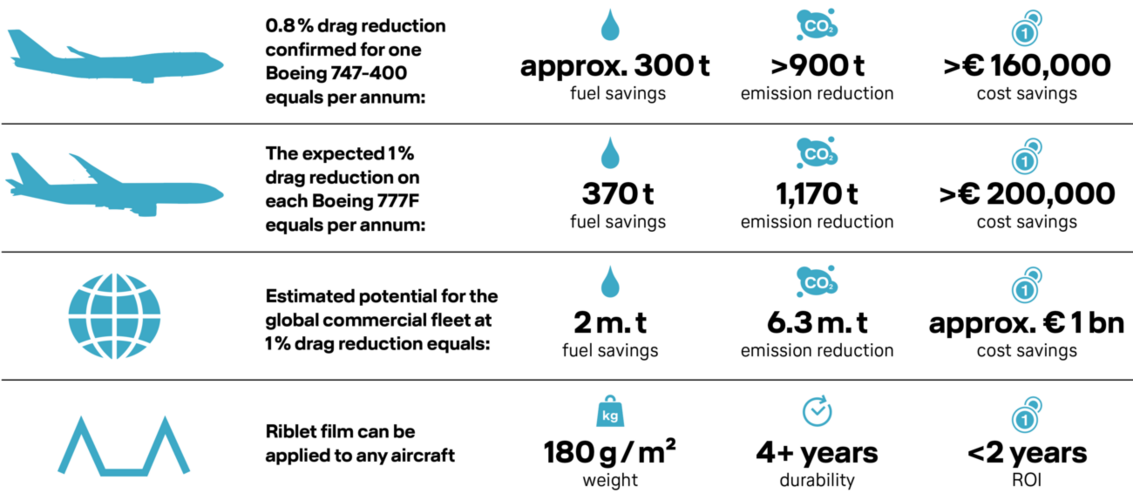

AeroSHARK (also referred to as Novaflex) is a skin surface finish for aircraft, intended to reduce drag. Developed by Lufthansa Technik and plastic films manufacturer BASF, it is inspired by the microstructure of marine shark's skin. Its texture comprises masses of tiny riblets, measuring 50 micrometers (0.05 mm/0.002 in/2 thou) in height.
It has now reached the stage where SWISS International Air Lines have ordered it up for their entire Boeing 777 fleet.
Fuel savings are estimated at 1.1%, equivalent to 15,000 tons of CO2 annually.
