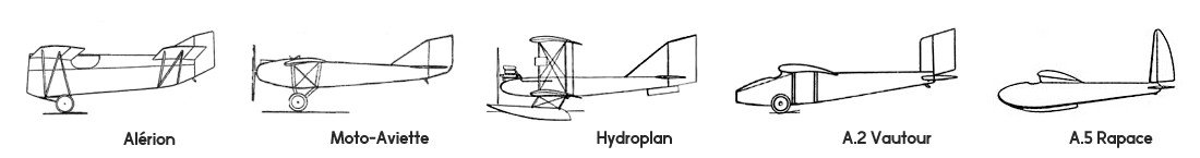

Peyret Alérion - 1922 single-seat tandem-wing glider, 6.6m span (main), 2 built
-- aka Peyret Tandem (orig. name), Alérion Tandem, or simply the Planeur Peyret
- Alérion n° 1: Maneyrol set duration record (3h22), Itford Hill, 21 Oct 1922
- Alérion n° 2: written-off by Lt. Le Petit near Biskra, Algeria, 12 Feb 1923
-- Vieilles Toiles et Planeurs Modernes - Peyret Alérion Tandem - photos/3 views
-- http://claudel.dopp.free.fr/Les_planeurs/Descriptions_planeurs/Peyret_Alerion/Peyret_Alerion.htm
-- NB: Alérion was a footless and beakless heraldic bird (usually an eagle)
-- Medieval bestiaries said only two Alérions exist at a time -- n° 1 & n° 2 :)
Peyret - (Project) 1923 powered Alérion fitted with 7 hp engine (type unidentified)
-- Flight 19 Apr 1923 announced plans for a flight from Vauville to Jersey
-- Flight 19 Apr 1923, Light 'Plane and Glider Notes http://www.flightglobal.com/pdfarchive/view/1923/1923 - 0215.html

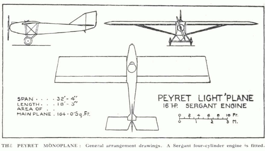

Peyret Avionette - 1922-23 moto-aviette (very light a/c) with "moteur auxiliaire"
- Avionette: 1 x nose-mounted 16 hp air-cooled upright inline 4-cyl Sergant A
-- L'avionnette Louis Peyret, by J. Serryer, Les Ailes, 04/10/1923, n° 120, p.25

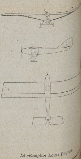

- Avionette: aka Peyret Monoplan, experimental monoplane of conventional layout
- Wings folded up on approach, Lympne trials 13 Oct 1923, Alexis Maneyrol killed
-- Flight 18 Oct 1923, The Light 'Plane Meeting at Lympne - Avionette photos
-- http://www.flightglobal.com/pdfarchive/view/1923/1923%20-%200643.html
-- j2mcl Planeurs http://www.j2mcl-planeurs.net/dbj2mcl/planeurs-machines/planeur-fiche_0int.php/?code=2572
Peyret-le Prieur Hydroplan - 1924 light biplane seaplane trainer, 1 x engine
- Hydroplan: designed for Yves le Prieur (of aerial rocket & aqualung design fame)
-- Hydroplan engine: 1st trials 16 hp 4-cyl Sergant, then repl. by 45 hp Anzani 6
-- Flight 4 Sept 1924 - Light 'Plane and Glider Notes
-- http://www.flightglobal.com/pdfarchive/view/1924/1924 - 0554.html
-- L'hydravion Louis Peyret, biplan à moteur Sergant 16 CV, by J. Serryer, Les Ailes, 14/08/1924, n° 165, p.25
Peyret-Abrial A-2: 1925 Vautour (Vulture) wooden single-seat glider, 6.25m span
- A-2 Vautour: glider designed by Georges Abrial, 1 built by Ateliers Peyret
Peyret-Abrial A-5: 1928 Rapace (Raptor) single-seat sailplane, aka Abrial A-5, 16m span
- A-5: design by Georges Abrial, assist. by Peyret and Prof. Toussaint, 1 built

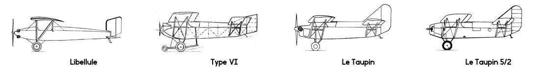

Peyret VI - 1930 Taupin 2-seat tandem-wing, 1 x 50hp Beaussier, 7.2m span*
-- Taupin was essentially an enlarged, powered deriv. of the Alérion glider
-- Flight 5 Sept 1946 - Private Flying in France
-- http://www.flightglobal.com/pdfarchive/view/1946/1946 - 1726.html
-- * Sailplane & Glider 31 Mar 1933 says 8.4m main and 6.5m rear wing spans
- SFCA-Peyret Taupin: 1936-37 (flown 1937) amateur-construction Peyret VI
-- SFCA-Peyret aka "Le Taupin", 1 x 30 hp flat-2 cylinder Mengin 2 A1*
-- * Also flown with 30 hp ABC Scorpion horizontally-opposed 2-cylinder
Peyret (??)- (Project) 19(??) 2-seat tandem, low-wing in front, high-wing behind
-- NB: Lay-out reappears on Mauboussin's 1936 M.40 Hémiptère research a/c
-- Sailplane & Glider vol.4 no.6 31 March 1933
-- http://www.lakesgc.co.uk/mainwebpages/Sailplane%20&%20Glider%201930%20-%201955/volume%204%20No.%206%20Mar%2031%201933.pdf
Peyret-Nessler Libellule - 1928 single-seat* parasol lightplane, 1 x 12hp Salmson 3-cyl
- Libellule: 1 built (F-AISQ), * but often flown with Mde Eric Nessler as passenger
-- NB: 'Libellule' also name of the Peyret-designed, tandem-winged 1907 Blériot VI

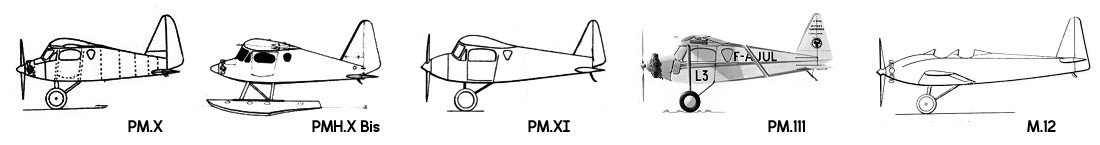

PM X - 1928 high-wing cantilever monoplane lightplane
- PM X: Single-seat cabin monoplane; elliptical wings, x 1
- PM X: 1 x 34 hp ABC Scorpion II HO2; span 10.00 m
-- aka 'PM 4', Mauboussin M 10; Peyret-Mauboussin M.10
-- Primarily wooden construction; held several FAI records
- PMH X bis: 1930 PM X with twin floats, reg. as F-AJGG
-- PMH X bis held the Class C altitude record of 3,461 m
-- aka M 10 bis or H 10 (Wiki)
-- Flight XXI (7) misidentified as "Mauboussin P.M.4"
-- 'P.M.4' 3v: http://aviadejavu.ru/Images6/FT/FT1929/02/294-1.jpg
-- http://www.airwar.ru/enc/law1/pm10.html
PM XI - 1928 high-wing cantilever monoplane lightplane
- PM XI: 2-seat cabin aircraft; straight-tapered wings, x 2*
- PM XI: 1 x 40 hp Salmson 9 Ad 9-cyl. radial, span 11.75 m
-- * PM XI N° 1 (F-AJUL) and PM XI N° 2 (F-AKFD)
-- Conceptually, the PM XI was simply an enlarged PM X
-- 1 x PM XI re-engined to become M 110/PM 110 (qv)
-- 'M XI' 3v: http://aviadejavu.ru/Images6/FT/FT1932/01/49-1.jpg
-- http://img.over-blog-kiwi.com/0/12/64/36/20150109/ob_d8efac_imgp2402.JPG

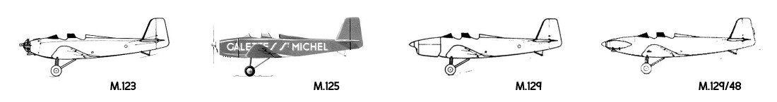

M 123 - 1937 2-seat tandem low-wing trainer; open cockpit; x 65
- M 123 : M 120 variant as a trainer for the Aviation Populaire
- M 123 : 1 x 60 hp Salmson 9Adr 9-cyl. radial; span 11.75 m
-- Stemmed from 1936 Fouga contract for Aviation Populaire [1]
-- M 123 : Corsaire, primarily wooden construction as per M 120
- M 123C: Re-engined M 129/48 (qv) F-PJKQ w/ Continental HO4
-- http://img.over-blog-kiwi.com/0/12/64/36/20150109/ob_62244c_f-pcek.jpg
- M 123M: (Project) Pre-WW2 plan to install 1 x 70 hp Minié HO4
- M 123M: Post-WW2 conversions with 75 hp Minié 4.DC.32; canopy
-- In both pre-war project and post-war aircraft, 'M' is for 'Minié'
-- 1954, Gilbert Pollono re-eng. M 123M; 60 hp geared Salmson 9Adr
-- 1958, Pollono re-eng. with 75 hp Régnier; M 123M becoming M 125
-- 19??, M 123M F-BCEP re-eng., Continental; by Simon Glotin, Nates
-- 1959, M 123M re-eng. w/ 105 hp Hirth; by Pierre Grenet of Beynes
-- For Grenet conversion see PG-2 Bison below & listed under M 126

M 125 - 1946 M 123 Corsaire development; second postwar version
- M 125 : 1 x 60 hp Régnier 4Jo inline 4-cylinder; span 10.35 m; x 5
- M 125 : Differed from M 123 in powerplant and shorter wingspan
-- http://img.over-blog-kiwi.com/0/12/64/36/20150109/ob_054a2a_f-pces.jpg
- M 125C: N° 208, currently F-PBHC; no other details (??)
-- http://img.over-blog-kiwi.com/0/12/64/36/20150109/ob_fa1acc_f-pbhc.jpg
M 126 - 1946 M 123 Corsaire development, third postwar version
- M 126: 1 x 80 hp Salmson 5Ap 5-cylinder radial; span 10.35 m; x 1
- M 126: As per M 125 except for powerplant (??)
-- Grenet PG-2 Bison: Pierre Grenet mod. M 126 N° 182; F-PBHQ*
-- Grenet PG-2 Bison: 1 x 105 hp Hirth inline engine (HM 500?)
-- * M 126 N° 182 conv. to Grenet N° 01 then converted to M 123
-- http://img.over-blog-kiwi.com/0/12/64/36/20150109/ob_dbba27_f-pbhq.jpg
M 127 - 1946 M 123 Corsaire development; Fouga-built variant
- M 127: 1 x 95 hp Régnier 4Eo inline 4-cyl, span (??) m;* x 2
-- * Unclear on whether Fouga retained full span or 10.35 m (??)
M 128 - 1946 M 123 Corsaire development; Fouga-built variant
- M 128: Sportsplane vers. of M 124, open cockpit, diff. engine
- M 128: 1 x 95 hp Mathis G.4G flat 4-cylinder,* span 11.75 m, x 1
-- * Aviastar lists 100 hp Mathis G.4R engine for the M 128**
-- ** Taken from Illustrated Encyclopedia of Aircraft
M 129 - 1939 sportsplane, inline equivalent to M 123M; x 29
- M 129 : Airframe not completed until 1944; open cockpit
- M 129 : 1 x 60 hp Régnier R.4J 01 4 cylinder; span 11.75 m
-- M 129: N° 191, F-BBSK
-- http://img.over-blog-kiwi.com/0/12/64/36/20150109/ob_985e40_f-bbsk.jpg
- M 129-48: Postwar production by Fouga; no canopy fitted
- M 129-48: 1 x 75 hp* Minié 4Do flat 4-cylinder; span 11.75 m
- * Aviastar lists the Minié 4Do output as only being 70 hp
-- M 129 (F-PJKQ) re-engined with Continental HO4 engine

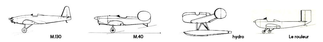

M 130 - (Project) 1933 low-winged single-seat sports a/c
- M 130: Single-seat lightplane M 112 derivative; unbuilt
- M 130: 1 x 75 hp Pobjoy R 7-cylinder radial; span 10.05 m
-- https://www.secretprojects.co.uk/threads/projects-by-pierre-mauboussin-1927-1940.3902/#post-121277

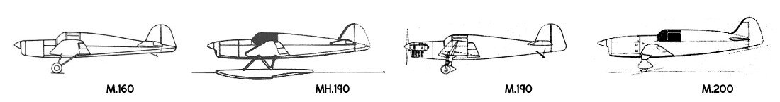

M 160 - (Project) 1938 Vanneau 2-seat training aircraft
- M 160: Low-wing; side-by-side seating; fixed main u/c
- M 160: 1 x 60 hp Régnier 4Do inline 4-cyl.; span 10.5 m
- M 160: To a 1937 Aviation Populaire trainer requirement
-- NB: Vanneau is the French for 'Plover', remained unbuilt
-- https://www.secretprojects.co.uk/threads/projects-by-pierre-mauboussin-1927-1940.3902/#post-234708
M 161 - M 189 - (??)
M 190 - (Project) 1938 Busard, 2-seat para-military trainer
- MH 190: (Project) 1937 Adour twin-float seaplane; unbuilt
-- Named after place of design; Aire-sur-l'Adour in SW France
-- 'MH' for Mauboussin Hydro; predated M 190 landplane
- M 190 : Low-wing; side-by-side seating; spatted main u/c
- M 190 : 1 x 90 hp Régnier 4Eo inline 4-cylinder; span 11.20 m
- M 190 : Refined, more powerful M 160 Vanneau development
- M 190: To a 1937 Aviation Populaire trainer requirement
-- NB: Busard is the French for 'Harrier', none built
-- https://www.secretprojects.co.uk/threads/projects-by-pierre-mauboussin-1927-1940.3902/#post-264561
M 191 - M 199 - (??)
M 200 - 1939 single-seat low-wing monoplane racing a/c, x 1
- M 200: Encl. cockpit set near trailing edge, spatted main gear
- M 200: 1 x 115-120 hp* Régnier 4Eohp 4-cylinder; span 7.28 m
- M 200: Set FAI record 255 km/h over 1000 km on 7 May 1939
-- Sole M 200 prototype (F-AROP) was built by Fouga
-- * Some sources list engine power as high as 129 hp

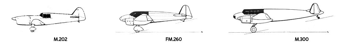

M 202 - 1941* single-seat low-wing monoplane trainer; x 1
- M 202: Lower-powered version of M 200** & M 201 types
- M 202: 1 x 95 hp Régnier 4Eo inline 4-cylinder; span 7.28 m
-- * Some source say 1939, prob. the construction start date
-- ** Other than canopies, M 200 and M202 look identical
-- ** Key difference - M 202 engine lacked a supercharger
-- http://pletav.free.fr/album/galeriessmall/gal2/poursite10.jpg
-- Flight 30 Sept 1943, The French Aircraft Industry 3 view drawing
-- http://www.flightglobal.com/pdfarchive/view/1943/1943 - 2361.html
-- NB: Flight lists M 202 powerplant as a "950 h.p. (sic) Regnier"
-- http://img.over-blog-kiwi.com/0/12/64/36/20150109/ob_9845fa_mauboussin-202.jpg
M 203 - M 259 - (??)
M 260 - (Project) 1937 Elite twin-engine monoplane executive a/c
- M 260: Derivative of M 190; low-set wings; spatted main gear
- M 260: 2 x 60 hp Régnier 4Do inline 4-cylinder;* span 10.50 m
-- aka FM 260 for Fouga-Mauboussin (production designation?)
-- * Alternative powerplants were "engines américans flat four"
-- Unbuilt M 260 influenced more advanced; more powerful M 300
-- https://www.secretprojects.co.uk/threads/projects-by-pierre-mauboussin-1927-1940.3902/#post-121134
M 261 - M 299 - (??)
M 300 - 1939* twin-engined tandem 3-seat military trainer, x 2
- M 300: Low-winged monoplane; twin tails; retract. main gear
- M 300: 2 x 220 hp Renault 6Q10/116-cyl. inlines, span 13.50 m
-- * Constrction begun to 1943 order for 3/4-seat liaison/trainer
-- aka Fouga-Mauboussin M-300 "three-place personal plane"**
-- ** Flying Magazine, Oct 1948, pg 43, New Frenchies
-- * 2 prototypes of wooden construction finally completed in 1948
-- 3v: http://www.airwar.ru/image/idop/la/m300/m300-1.gif
-- http://pletav.free.fr/album/galeriessmall/gal2/poursite2.jpg
M 40 - 1936 Hémiptère single-seat research aircraft, x 1
- M 40: Tandem wing, endplate fins on high-mounted rear wing
- M 40: 1 x 40 hp Train 4A tractor engine; span (fwd wing) 7.00 m
- M 40: N° 01 prototype (F-AOYZ); influenced by Peyret project
-- Flight 17 Sept 1936; Reviving the Tandem; details and photo
-- http://www.flightglobal.com/pdfarchive/view/1936/1936 - 2533.html
- M 40 version hydro: (Project) pusher floatplane derivative
-- https://www.secretprojects.co.uk/threads/mauboussin-type-40-hémiptère.10558/

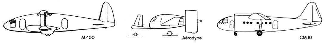

M 400 - (Project) 1939 twin-engined biplane light transport*
- M 400: Oval-section fuselage; Hurel Dubois-type wings**
-- * Lack of fuselage side windows suggests research a/c
-- ** Wings unstaggered with single strutted twin bays
- M 400: 2 x 350 hp Béarn (CMB) 6B 6-cyl.; 22.10 m span
-- Pushers in lower pods, u/c retracted rewards into pods
-- Some sources list 2 x 350 hp Béarn '2BE 6 DO' (??)

M 122 - 1935 Corsaire Major record aircraft for Maryse Hilz; x 1
I have the designation M.122/34, but perhaps the "34" was dropped when it became obvious that the type wouldn't be ready until 1935?
Didn't you find it strange that both the Continental and Minié types would have the same designation?
It was actually a Minié 4 DO (source: AMI). Also, AMI claims that the postwar Minié-powered examples were actually the M.129 (see below).
- M 123T: (Project) 60 hp Train 6T 6-cylinder inline; not built
The M.123 T should have been an aerobatic version.
- M 123R: (Project) 60 hp Régnier 4 cylinder; not built (see M-129-48)
It was a Régnier 4 DO (again, AMI as my source).
-- Metalair 1: 195? one-off M 123M modification, F-PCNX, x 1
This was in 1957. It was the former n° 178 (now as n° 1), used a Régnier 4 JO engine, and was registered as F-PCNX.
That is NOT what AMI claims. According to them (and they should have known, since it was still fairly recent at the time), the Minié 4 DO-powered aircraft received the M.129 designation before the war (and if you think of it, it DOES make sense, since the Régnier 4 JO version was already the M.125). Interestingly, AMI doesn't mention a distinct M.129/48 version either. I guess we'll have to dig further into the matter to be sure.
Also, M.129 production, which you claim was 29 examples, is given as only 23 by AMI (mental confusion between 129 and 29 while typing? or do you have a source for the 29?)
Finally, Fouga production didn't start with the M.129/48; indeed, n°191 [F-BBSK] was produced in 1944 by Fouga, too

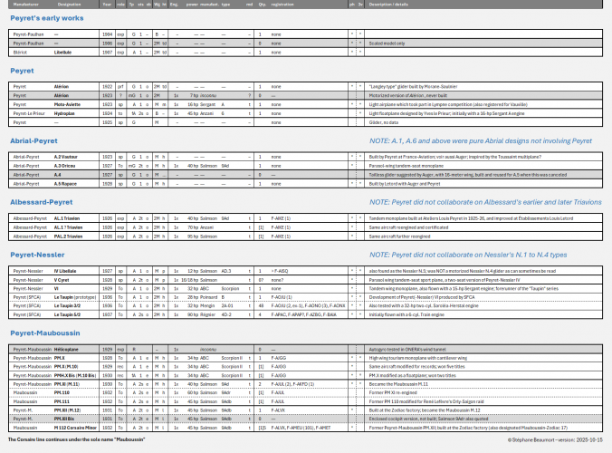

I've done Mauboussin, but I forgot Peyret! So here goes:
Because Peyret's tandem-winged 'Le Taupin' is also listed as the Peyret VI, it is tempting to suggest that the Peyret-Mauboussin PM sequence follows on from an earlier Peyret series. Unfortunately, there's little sign of such a numbering system.
There isn't indeed. The most logical explanation is that the number "VI" used the numbering system carried over from Nessler. Indeed, the Peyret-Nessler IV Libellule is a modification of the Nessler N.4 design, and there you have it:
  • Nessler N.1 Aérovoilier (1916)
  • Nessler N.2 (1922)
  • Nessler N.3 (1923)
  • Nessler N.4 (1925)
And if you wonder why there is no number V, well... there may have been: a two-seat version of the Peyret-Nessler powered by an 18 hp engine was planned, but not built. I'm pretty sure this must have been it.
That being said, there is another possibility: Peyret worked with Georges Abrial on four designs, numbered A.2 to A.5. So, you see, with A.5 being a 1928 type and the Peyret VI being from 1929, perhaps Peyret took up the numbering from there? (I'm still more inclined to believe the Nessler hypothesis, though, because the Type VI is actually called a Peyret-Nessler VI).
Is this a sure fact? I haven't been able to identify two distinct Alérions, only the one built by Morane-Saulnier for Peyret.

PEYRET
Note that this list starts in 1922, but there were earlier aircraft designed by Peyret before WW1 (1904 Peyret-Paulhan biplane glider, 1907 Blériot Libellule tandem-wing aircraft, etc). However, I haven't yet made a complete list of them (but if anyone already has, please share it in this thread!)
  • Alérion (1922) — tandem-wing single-seat performance glider, built by Morane-Saulnier (one built, possibly two)
  • Alérion? (1923) — motorglider version with undetermined 7-hp engine, not built.
  • Moto-Aviette (1923) — single-seat mid-wing monoplane racer with 16-hp Sergant A engine, flown at Lympne (one built)
  • Hydroplan (1924) — Peyret-Le Prieur floatplane with 16-hp Sergant A engine (probably snatched from previous type), later 45-hp Anzani 6 engine. Only one built for Yves Le Prieur.
  • Undetermined, unnamed monoplane glider (1925), needs confirmation.
ABRIAL-PEYRET
Note that these are included here for the sake of completion, and are actually part of the Abrial models list.
  • A.2 Vautour (1923) — single-seat high-wing monoplane sports glider; one built at France-Aviation by Peyret.
  • A.3 Oricou (1927) — tandem-seat tourism motorglider with a 40-hp Salmson 9Ad engine; one built.
  • A.4 (1927) — tailless sports glider project, not built.
  • A.5 Rapace (1928) — single-seat high-wing monoplane sports glider; one built at Letord with Auger and Peyret.
PEYRET-NESSLER
Note that Nessler designs N.1 to N.4 did not involve Peyret.
  • Type IV Libellule (1927) — single-seat parasol wing sport monoplane with 12-hp Salmson AD 3 engine; this has been described in some sources as a motorized Nessler N.4 glider, but photo comparison proves they are two very distinct designs; other sources give the Type IV as having been the Nessler N.5, which seems more logical; one built [F-AISQ].
  • Type V? Libellule? (circa 1928) — tandem-seat version of above with undetermined 18-hp engine, never built.
  • Type VI (1929) — single-seat tandem-high-wing tourism monoplane with 28-hp ABC Scorpion engine; this was Peyret's last design, just before his passing; only one built.
PEYRET (SFCA)
Later production and development of the Peyret-Nessler Type VI by SFCA. Note that these aircraft only carried the name "Peyret" as an homage and recognition of the designer's work, but it was never the company's name.
  • Le Taupin (1936) — single-seat tandem-high-wing tourism monoplane with 28-hp Poinsard B engine; one built (n° 1).
  • Le Taupin (1936) — production version with 32-hp Mengin 2A-01 engine, but also tested with 32 hp two-cylinder Saroléa-Herstal. 48 built, including the prototype [F-AOJU (n° 2, ex-n° 1)]; later redesignated "Taupin 3/2" when the next version appeared, to differentiate them.
  • Taupin 5/2 (1937) — side-by-side seating, more powerful version with 90-hp Régnier 4D-2 engine, but first tested with a six-cylinder Train type; only four built [F-APAC, F-APAP?, F-AZBG, F-BAIA].
PEYRET-MAUBOUSSIN
Note that these were primarily Mauboussin designs built by Peyret, although Peyret designed the wing profile on PM.XI, which was reused on PM.XII.
  • Hélicoplane (1929) — undescript autogyro, wind-tunnel tested in model form at ONERA; not built.
  • PM.X (1928) — single-seat enclosed high-wing tourism monoplane with 34-hp ABC Scorpion II engine; single-spar wing; one built [F-AJGG].
  • PM.X (1929) — same aircraft modified for records with reinforced undercarriage; won 5 titles.
  • PMH.X Bis (1930) — same aircraft modified as floatplane; won two more titles.
  • PM.XI (1930) — refined side-by-side seating version of PM.X with 40-hp Salmson 9Ad; two built [F-AJUL (n° 2), F-AKFD (n° 1)].
  • PM.110 (1932) — one M.11 re-engined with more powerful 60-hp Salmson 9Adr variant.
  • PM.111 (1932) — same aircraft re-engined with 45-hp Salmson 9Adb for René Lefèvre's long-distance Paris-Orly—Saigon raid.
  • PM.XII (1931) — tandem-seat low-wing tourism monoplane with 45-hp Salmson 9Adb engine; one built by Zodiac factory [F-ALVX]; prototype for the entire Mauboussin "Corsaire" family.
  • PM.XII Bis (1931) — enclosed cockpit version similar to above (Salmson 9Adr also found); not built.

  • M.123 Corsaire (1937) — school/tourism version for French Aviation Populaire; main production type of the series with 60-hp Salmson 9Adr engine; 65 produced, mostly by Fouga, even during the war [F-APQA, F-APQB, etc.].
  • M.123 R Corsaire (1937) — tourism version with 60-hp Régnier 4 DO engine; not built.
  • M.123 T Corsaire (1937) — aerobatic version with 60-hp Train 6 T engine; not built.
  • M.123 M Corsaire (1937) — tourisme version with 70-hp Minié 4 DO engine; not built.
  • M.123 M Corsaire (circa 1946) — postwar conversions of various Corsaire types with 70-hp Minié 4DC32 engine, number unknown; some with enclosed cockpit.
  • M.123 C Corsaire (1946) — postwar tourism conversions with 65 hp Continental HO 4 engine; number unknown, but included [F-PJKQ (n° 189), -F-PBHQ, F-PCEK (n° 179)]; one M.123 C was a much later conversion using a 110-hp Lycoming type [F-PCIP (n° 183)], despite the lack of logic of the designation.
  • Métalair Type 1 (1957) — former M.123 F-BBHT (n° 178) modified by Fouga's "Aéro-club des métallurgistes" as a trainer and fitted with a 75-hp Régnier 4 JO engine.; registered as F-PCNX (n°1).
  • M.124 Corsaire (1946) — tourism version with 60 hp Aster 4A engine (licensed Walter Mikron), slightly enlarged wing profile; studied in 1937 but only one built after the war [F-BAOF].
  • M.125 Corsaire (1946) — similar to M.124 but with 75-hp Régnier 4 JO engine, open cockpit; studied in 1939 but produced only after the war; 5 built, including [F-BCEL, F-BBHL, F-PCES (n° 177)]; at least one more was produced by Gilbert Pollono in 1958 by fitting a Régnier 4 JO engine on a former M.123 [F-PBHC (n° 208)].
  • M.125 C Corsaire — designation found for what was probably a Continental-repowered M.125.
  • M.126 Corsaire (1946) — similar to M.125 but with 80-hp Salmson 5Ap 01 engine; studied in 1939 but only one built after the war [F-BBHQ (n° 182)].
  • Grenet PG.02 Bison (1960) — same aircraft reworked by Pierre Grenet clipped wings, enclosed cockpit, a 105-hp Hirth 504A-2 engine; re-registered as [F-PBHQ]; later modified to M.123 C standard.
  • M.127 Corsaire (1946) — similar to M.125 but with 95-hp Régnier 4 EO engine; studied in 1939 but only two built after the war [F-BBTB/F-PBTB, F-BCIO?/PCIO].
  • M.128 Corsaire (1946) — similar to M.125 but with 95-hp Mathis G.4R engine (some sources give it as "G.4G"); studied in 1939 but only one built after the war (registration unknown).
  • M.129 Corsaire (1939) — similar to M.125 but with 70-hp Minié 4 DA 25 (Horus) engine; only 1939 version to be produced before and during the war, albeit in small numbers; included [F-ANGP] and [F-BBSK], the latter produced by Fouga in 1944.
  • M.129/48 Corsaire (1948) — Main postwar version, a refinement of the 1939 design with 75-hp Minié 4 DA 28 (Horus) engine; apparently 23 produced, including [F-BCEY, F-BCIS] but it is unclear if that number concerns just the M.129/48 version or the entirety of the M.129 run.
  • MB.130 Corsaire (1962) — one MB.129/48 modified by a Mr. Beaujard with a 105 hp inline Hirth engine [F-PCIZ (n° 01)]. Note that this was NOT an official Mauboussin designation.

  • M.130 (1933) — single-seat low-wing sport monoplane with 75-hp Pobjoy Cataract R engine, an M.112 derivative design, wind-tunnel-tested at ONERA but not built.
  • M.40 Hémiptère (1936) — single-seat tandem-wing tourism monoplane with 40-hp Train 4A-00 engine; only one produced despite marketing efforts [F-AOYZ]. Why it was designated M.40 and not "M.140" is unknown.
  • Le Rouleur (1936) — single-seat non-flying aircraft with 17-hp Aubier & Dunne V2 D "Channel" type engine; a "penguin" type meant for flying clubs/schools as an economical means to learn construction and flying; one example said to have been built and shown at the 1936 Air Show in Paris's Grand Palais, although lack of photos suggest it may just have been a model. Several examples said to have been produced in different clubs, although only the C.A.P.R.N. one (n° 01), presented in January 1937, is documented for now. Note that as it was not a proper aircraft, it probably didn't receive a Mauboussin designation.
  • undesignated hydro (1937) — single-seat tailless type floatplane with wing-tip fins, 40-hp Salmson 9Ad pusher engine; not built; although this is frequently found under the same designation as the M.40, there is nothing to circumstanciate either the name ("Hemiptère" applying to an aircraft with two pairs of wings, which is not the case here) or the designation (considering it is a totally different design, logic would have it that it carried a totally separate model number, possibly "M.50", although there is no evidence of that).
  • M.160 Vanneau (1938) — side-by-side seating enclosed low-wing school monoplane with 60-hp Régnier 4 DO engine, fixed landing gear, meant for Aviation Populaire; not built.
  • MH.190 Adour (1937) —side-by-side seating enclosed low-wing trainer floatplane with 95-hp Régnier 4 EO engine; a more powerful derivative of M.160; not built.
  • M.190 Busard (1938) — landplane version of MH.190 for Aviation Populaire; tested at ONERA but not built.
  • M.200 (1939) — single-seat enclosed low-wing trainer with 129-hp Régnier 4 EO supercharged engine; two built [F-AROP, F-WAOI].
  • M.201 (1939) — more powerful modification of first M.200 [F-AROP], with same supercharged engine type rated at 150 hp; never completed because of war, and confiscated by the Germans.
  • M.202 (1941) — non-supercharged modification of second M.200, same engine type; studied in 1939 but delayed because of war [F-BAOI > F-WAOI > F-PAOI].
  • FM.260 Élite (1937) — three-seat enclosed low-wing trainer/tourism aircraft with two 60-hp Régnier 4 DO engines, a twin derivative of the M.190 design; not built.
  • M.300 (1948) — six-seat low-wing tourism aircraft with two 220-hp Renault 6Q10/11 engines; a 1939 project; two prototypes built by Fouga after the war.
  • M.400 (1939) — three-seat biplane transport aircraft with two 350-hp Béarn 6 DO9 pusher engines; not built.
  • Brevet Mauboussin-Kiriloff N° 985.498 — twin-boom design with shrouded pusher propeller; filed in 1943, granted in 1951; not built.
  • Brevet Mauboussin-Kiriloff N° 986.603 — pusher "aerodyne" with shrouded propeller, tricycle gear, canards ahead of nose at tip of forward beam; filed in 1943, granted in 1951; not built.
  • Brevet Mauboussin-Kiriloff N° 986.603 — similar design but and dates but twin-fuselage/propeller configuration.
  • Brevet Mauboussin-Kiriloff N° 991.121 — combination aircraft/land vehicle "aerodyne" with retractable wheel set; filed in 1944, granted in 1951; not built.

I've just added the profile views for most Peyret and Mauboussin types.
Please note that all relative sizes are approximate.
