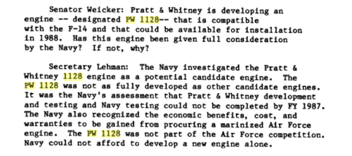

No Sir, I am talking about PW1128 not F401. But I got an answer in the report "Department of Defense appropriations for fiscal year 1985,
hearings before a subcommittee of the Committee on Appropriations, United States Senate, Ninety-eighth Congress, second session, P515". Navy Secretary Lehman said that the progress of PW1128 lagged behind the needs of the Navy, so Navy chose F110. QQ_1741876250001.png
Thanks for that citation regarding the PW1128 for the F-14. Senator Wicker was from Connecticut and was a supporter of P&W.
Yes, the PW1128 would have had similar performance to the F110-400, which was very similar to the F110-100 that had already completed development for the USAF Alternate Engine Program in 1985.
