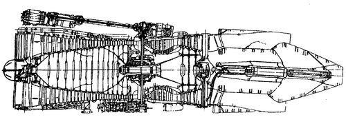

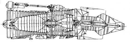

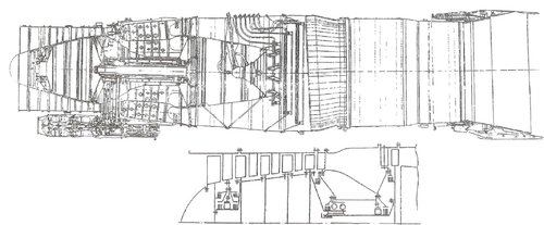

Looking for detailed, highres cutaways or pictures of soviet jets R-15B-300 and RD-36-51
msxyz
ACCESS: Restricted
10 December 2019
9
2
The first in the powerplant of the famous Mig 25, the second was used in the improved Tu-144D
For such popular aircrafts there are surprisingly little to no cutaways or other drawings showing the internal arrangement for these two engines. The few I´ve found are poststamp sized and of poor quality.
Regarding the Kolesov RD-36-51 I would also like to know if there are publicy available graphs about their thrust at different speeds and altitudes and a chart for the various settings of the nozzle plug relative to the envelope of flight.
Both engines are nowadays museum material so there must be maintenance manuals or something like that floating around, right? I found one for the Mig-25 but unfortunately it doesn't include good drawings of the engine
Thanks,
Marco

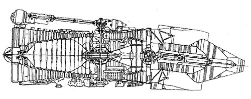

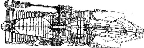

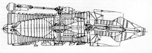

Again, thanks.
In one of the drawings it's possible to appreciate the amount of travel inwards of the nozzle plug. Judging by the geometry, retracting the plug has the effect of creating a tighter choke, thereby increasing the speed of the exhaust gases, while extending it increases the nozzle area. So, during the supersonic cruise, the cone would be fully retracted?
Also, what is the machinery on top of the RD-36-51 intake ? http://www.missiles.ru/_foto/Saturn-muzey-2010/_MG_2030.JPG. A starter engine? Quite an odd placement considering it needs a long shaft all the way back to the middle section where the bevel gears are located.
