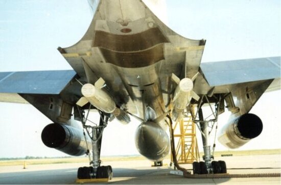

Added during the B-58's service were individual attachment points under the wing roots for 4 B-43 (~2,100lb) or B-61 (715 lb) nuclear weapons in addition to the centerline store/fuel tank.

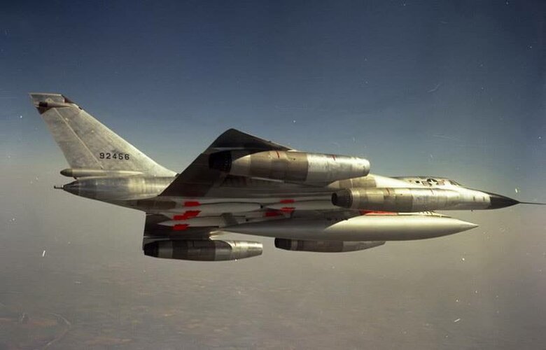

Here is a B-58 with 4 inert B43s (top) and inert B-61s (bottom):

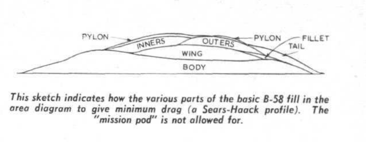

The B-58's pods actually fill the area-rule, that's the reason the engines were separated out from the initial twin-pods design. So essentially they're freebies in terms of high-subsonic & transonic drag. B-58_area_diagram.png
Probably close to 2.5x the mass, true, but those podded engines were high drag. Having a configuration with a less draggy layout would have been beneficial, especially in low altitude flight.
Not as draggy as trying to fit four engines, their intakes, and all that fuel INSIDE the fuselage. And have that OML to haul around for the entire mission. Call me crazy but, given all the speed records the Hustler broke, I'm going to say it probably wasn't as "draggy" as you think.

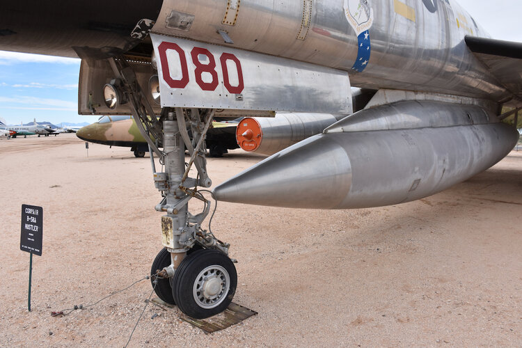

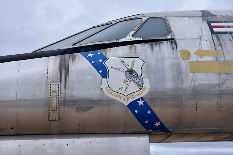

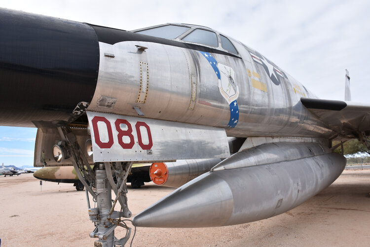

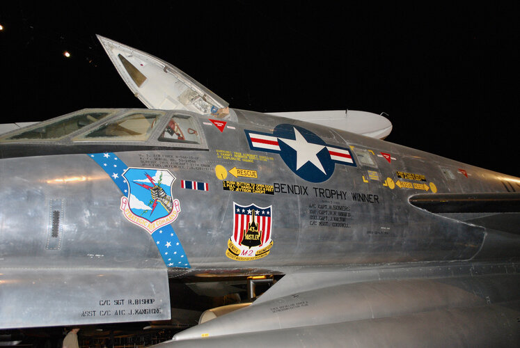

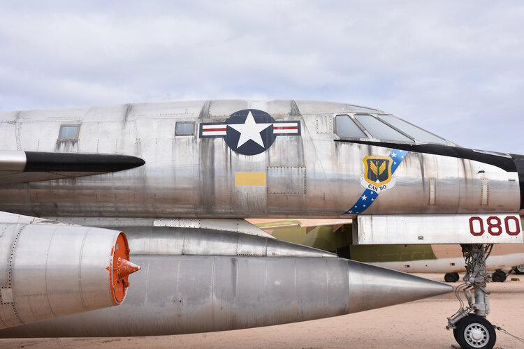

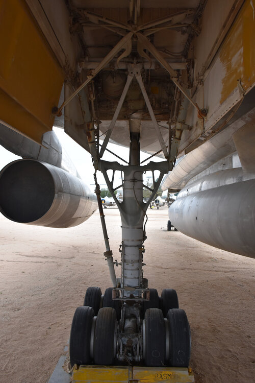

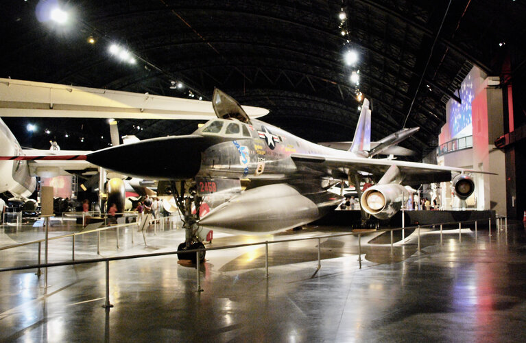

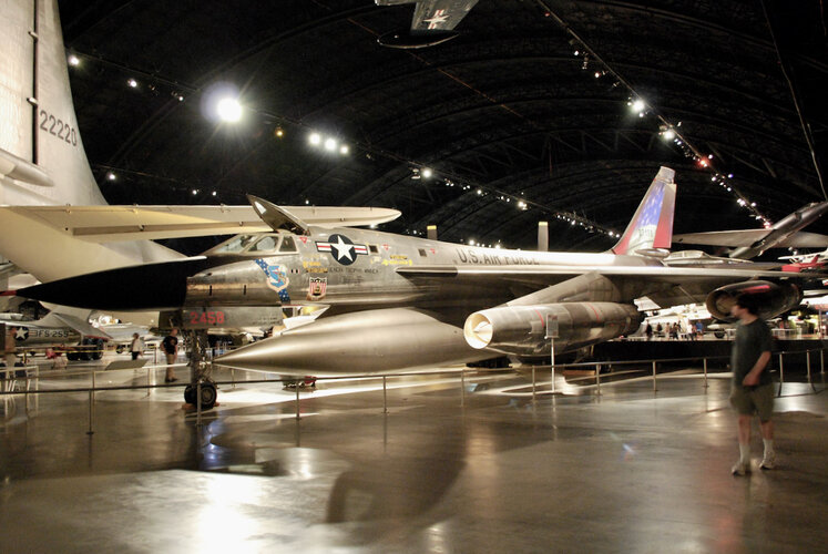

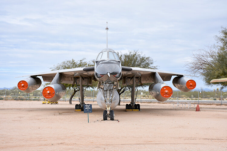

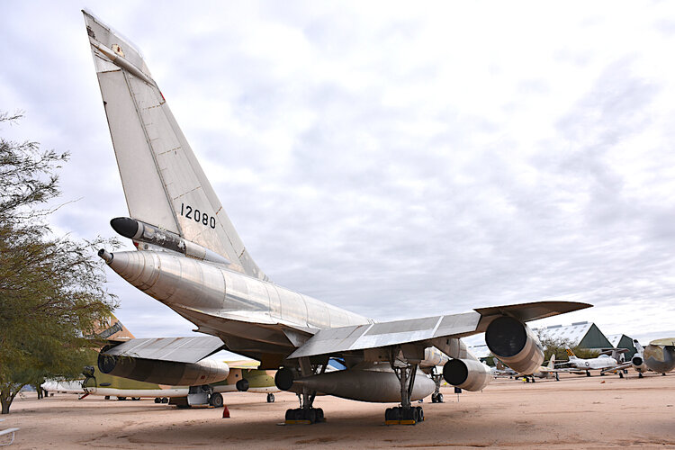

B-58 at US Air Forcee Museum, Dayton, Ohio & Pima Air Museum, Tucson Arizona. The Air Force Museum also show the ejection pod employed instead of the standard ejection seats.

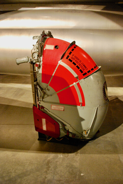

Here's a book by a retired Colonel who was a B-58 navigator. Same guy in the video posted above. He felt the aircraft was retired too soon. It's one of those print on demand books, but has a lot of B-58 information in it. He also singles out those he felt responsible for the premature termination of the program. Termination was announced late in 1969, and aircraft retired by end of January, 1970.
Several variants (B-58B, C, D, and E) were proposed by Convert but never built. The B-58B would have replaced the General Electric J79-GE-1 turbojet engines with more powerful uprated J79-GE-9 engines, have a a longer fuselage for extra fuel capacity, and canards,.
The aircraft itself had some difficult flight handling issues, including a pitch up problem if the AOA was too high, leading to a spin. Stall conditions were another piloting challenge. Of the 116 B-58A built, 24 were lost in crashes. Still, it had a lot of amazing features, including an Inertial Nav system (IMU) with astro-tracker stellar location correction in flight.
You have an outboard engine surge at Mach 2 on the Hustler, you're losing the plane and crew unless everyone's guardian angels are very happy with them.
Losing an expensive bomber like that is quite bad on its own, but why wouldn't the crew have enough time to eject in such a scenario? Or would the results of such engine surge be so immediately catastrophic where there is almost no time to act?
