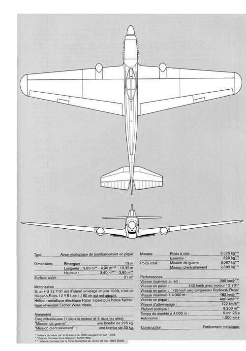

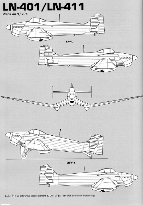

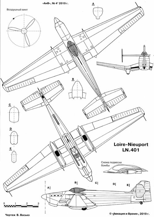

Can anyone help with the drawings of Loire-Nieuport LN.40/411? In particular, drawings of the transverse and longitudinal sections are required.
Is there a book or magazine about this plane?
I apologize for the importunity and thank you in advance.

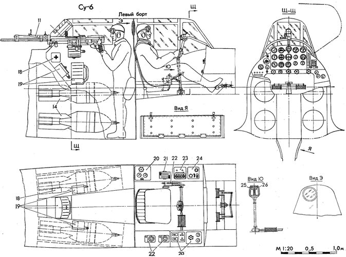

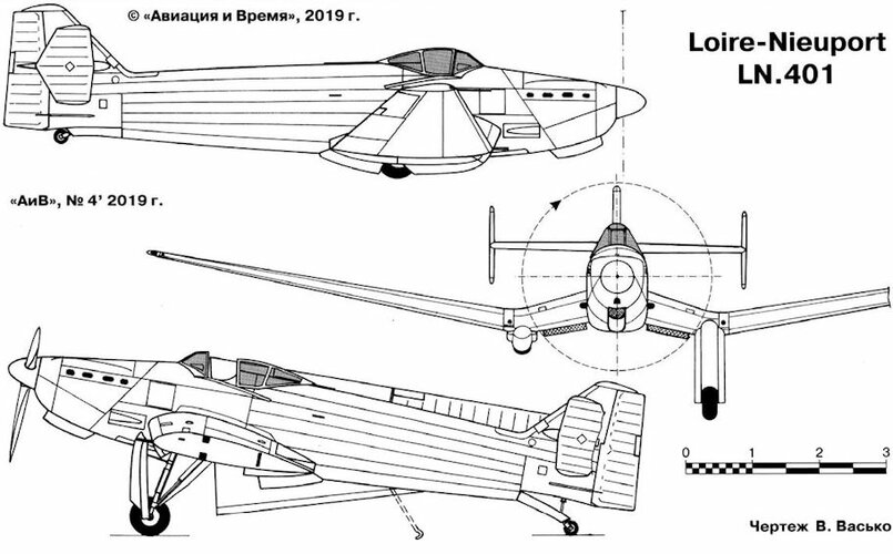

Hi

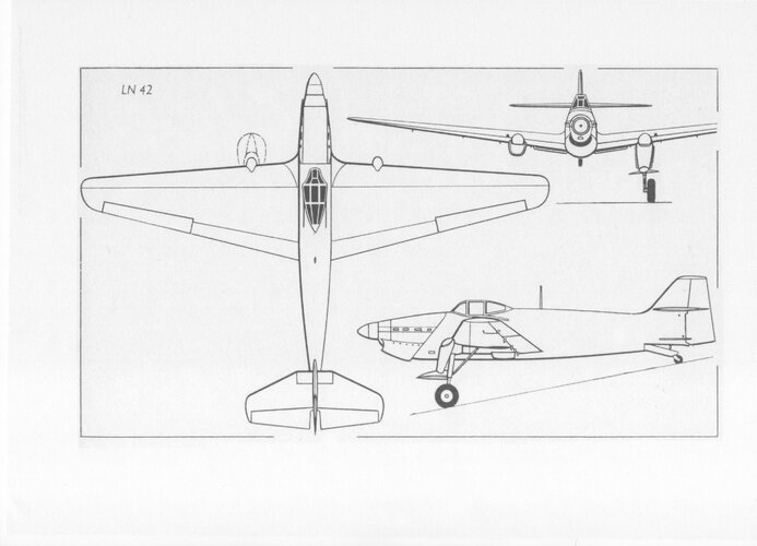

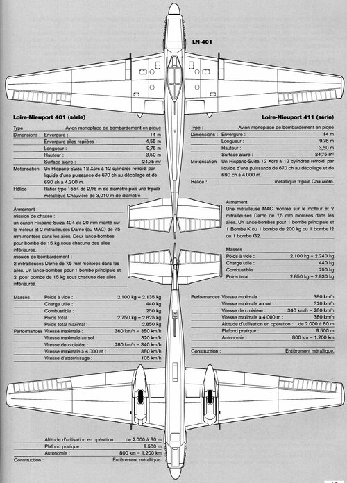

Excuse me, but is there anything like that?

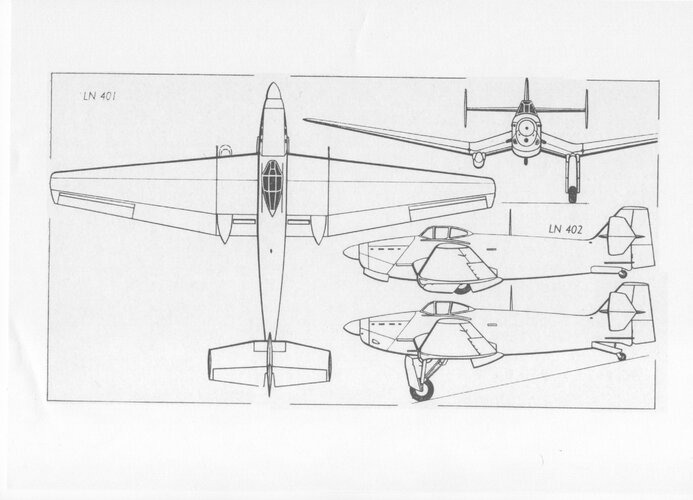

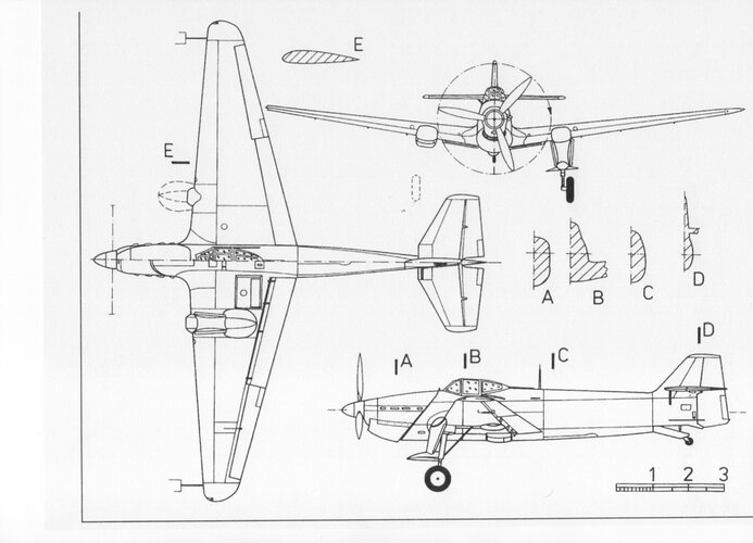

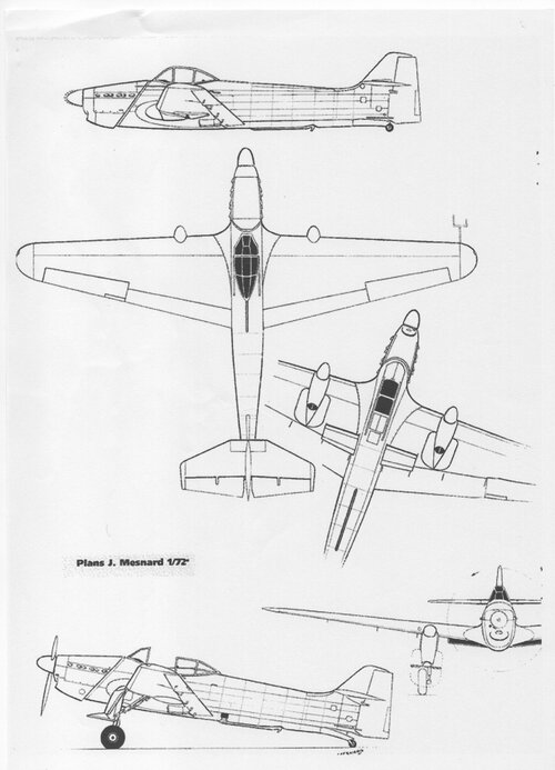

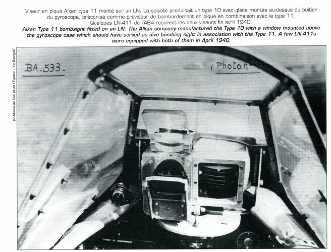

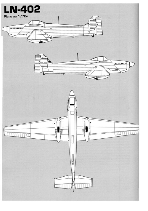

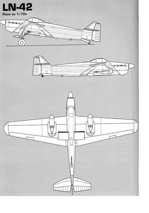

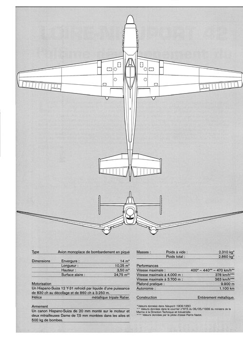

Just answering tallguy's question, I'm afraid I can't help you with an interior arrangement drawing of the LN 40/411. Your request was slightly ambiguous.

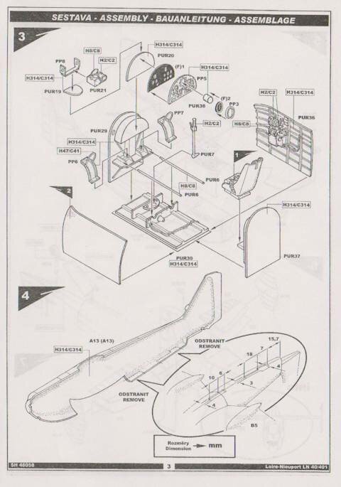

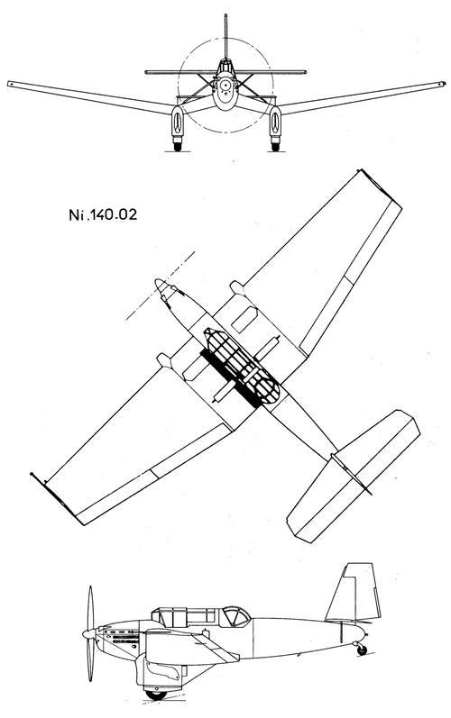

And does anyone have drawings of Nieuport Ni.140. Sorry for the importunity.

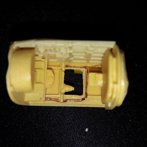

Thank you for the information. But my question is different: how could this gun fit in LN.401/411/42??
The reason for the question is that the dimensions of the gun are too large, to put it mildly, and the length of the nose section is too small to say that the gun fits freely there.
Not sure about that. The French moteur-canon installation was surprisingly compact. I found a sketch of the prototype LN 40 showing the engine position. To that I have superimposed an image of an HS 12Y complete with HS 404 gun.
Unfortunately, I can't locate an image of the correct HS 12X with HS 404 but that engine is roughly 3/4 the size of the HS 12Y. Go to the link and you'll see that the magazine fits under that triangular cowling section. The gun's breech does intrude into the cockpit space ... but no more so that, say, the MG 151 in a Bf 109F.
-- https://www.secretprojects.co.uk/threads/apophenias-art.43227/#post-665026
Thank you very much.
