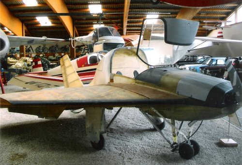

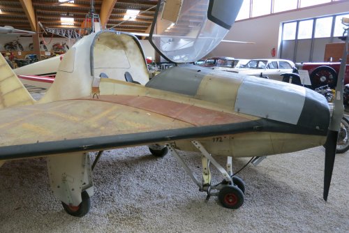

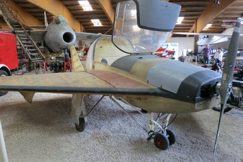

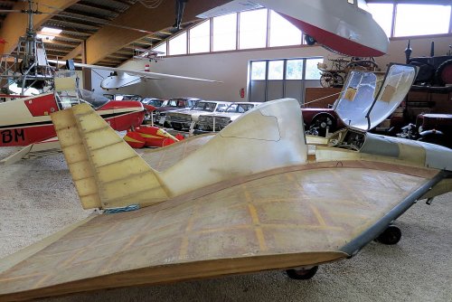

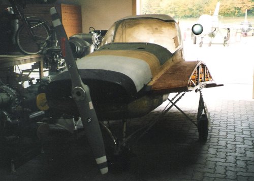

In the photos below the aircraft is shown in 2004 (without wings) and in 2010.

Great find my dear Cy-27,
I never heard about it before.

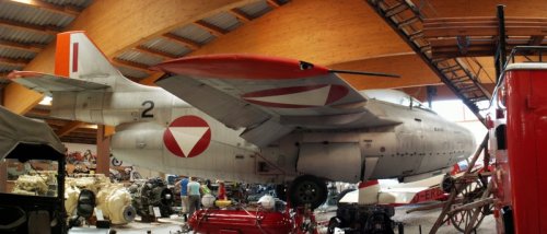

Please, what is the aircraft to the left, with the nose intake in the second picture?

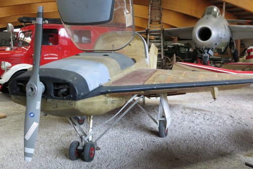

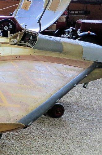

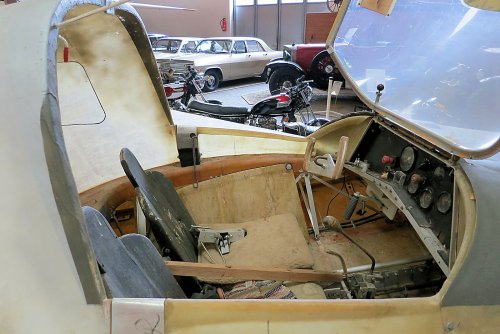

Here are two photos of the Lohr that I found here: http://flickrhivemind.net/Tags/mikojangurewitsch/Recent
The right side picture reveals five fittings on the leading edge of the wing. They look like light bulb fittings, but could they be turbulators? I've cropped the side picture to show them.
