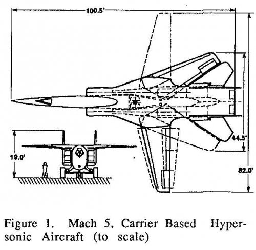

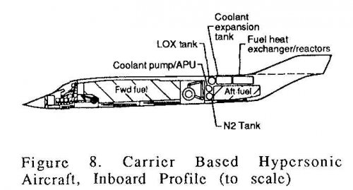

AlAA 90-3284 Thermal Management for a Mach 5 Cruise Aircraft Using Endothermic Fuel
D. Petley, NASA-Langley, Hampton, VA; S.Jones, Lockheed Engineering and Sciences Co.
Beast is carrier-based

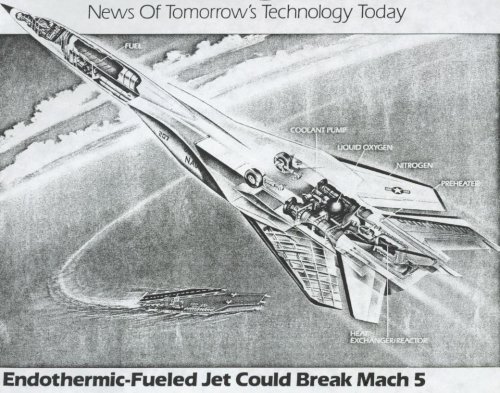

I believe the pic below is an artist's concept of the Lockheed carrier-based aircraft. I think it was shown in Popula Science Magazine.

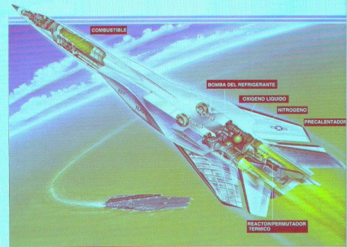

Yes, it is. Here a color version from a Argentinian Edition of MP (Nov 1991)
According to the little article the refrigeration system would have an approximated weight of 5 tons, equivalent to a 13% of the weight in takeoff.

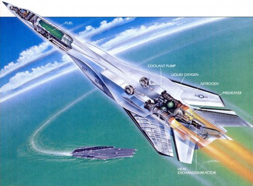

Illustration of NASA Langley Slytherm Mach 5 aircraft.
Source: "Endothermic Fuel Jet Could Break Mach 5" Popular Mechanics August 1991
(higher resolution)
