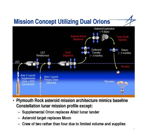

"National pride" is one of the reasons given in Lockheed Martin's pitch, attached above, with the intention of:
"Decisively re-establish America's preeminence in space."
"Reduce the 'exploration gap' before the next lunar landing."
In addition, "Project Plymouth" is manned for training and experience purposes:
"If a lunar mission precursor: Demonstrate lunar launch profile, LEO rendezvous, and Orion re-entry at lunar-like entry speeds. "
"As a Mars mission precursor: Learn to fly lunar missions in deep space, with speed of light lag, radiation risk, and no resupply or rescue. Asteroids are shorter, simpler, practice for Mars."

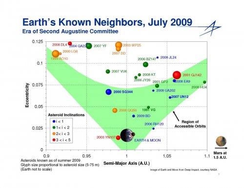

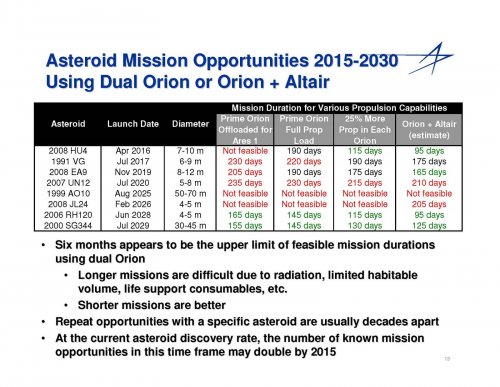

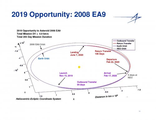

Thanks for breaking that up. I have not gone through it yet, but the one obvious difference from their previous version is that instead of two nearly-identical Orion vehicles, they now have a dedicated hab module. The hab module has no airlock. The astronauts get out by depressurizing one of the craft.
Other ideas that have been floated for this mission include using an inflatable Bigelow-type module, or using a European ATV-type module.
