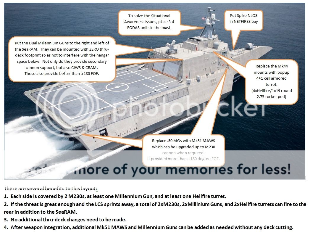

Here were some thoughts I had for Up-Gunning the LCS with the least impact on space available.
I wonder how useful (if they still had them) the ability to swap out RAM missiles for LOSATS in the same launcher would be.
