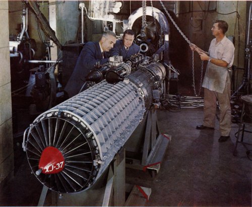

Original vintage photo of L-1000

Am I much mistaken, or is that Kelly Johnson second from left in the pinstriped zoot-suit?
