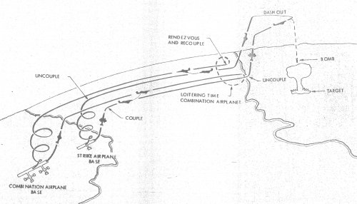

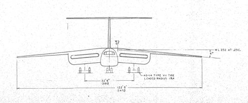

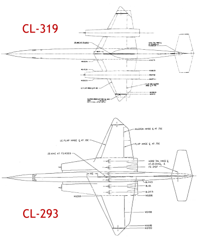

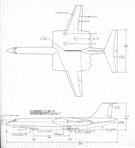

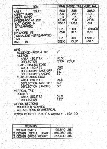

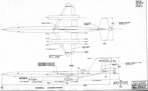

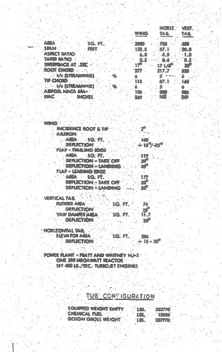

This program has not been entirely declassified, but what I have thus far is interesting. As best I can tell, it hasn't appeared on the site until now, but I'd welcome correction.
Lockheed proposed two aircraft to work in tandem. The nuclear-powered tug (w/a 300 Megawatt P&W N2 reactor powering six turbojets) was identified as the CL-326; it had a wingspan of 122.5', a length of just over 149' and a design gross weight of 337,770 lbs. The strike aircraft, identified as the CL-319 (specifically the CL-319-35 in the drawing dtd June 1956), was powered by two P&W JT9A-20 engines; it had a span of just under 81' and a length of just over 161'. CL-319's gross weight was set at 255,600 lbs. Unfortunately, the extract I have doesn't include any performance figures.
