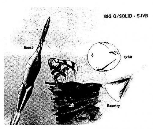

The other project is a capsule from Lockheed called BALLOS. This appears to sometype enlarged Apollo-type CM on the order of Big Gemini. In fact it looks very similar to the Big G artwork here. I'm also pretty sure that it was BALLOS I've seen in SPACE STATIONS by Roger Launius, though it's not mentioned as such.

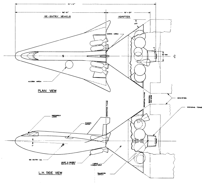

I 'm searching some image of the Orbital version of the HL-10 (Scott recently in his blog published a b/w cutout).

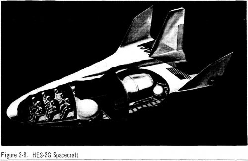

Douglas HES-2G
http://ntrs.nasa.gov/archive/nasa/casi.ntrs.nasa.gov/19660028071_1966028071.pdf
http://www.spacesociety.org/road.html
Arrow down to figure 4...In the corner is a poor-quality illustration of the BALLOS/Diana capsule. In fact I say it is Diana because that's almost the same drawing that's in Launius's space stations book.
Orbital HL-10
