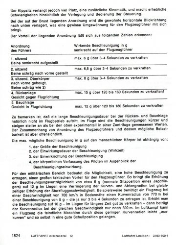

Akaflieg Berlin B9, airframe stressed to accept 22 g.
That looks interesting, thank you!
